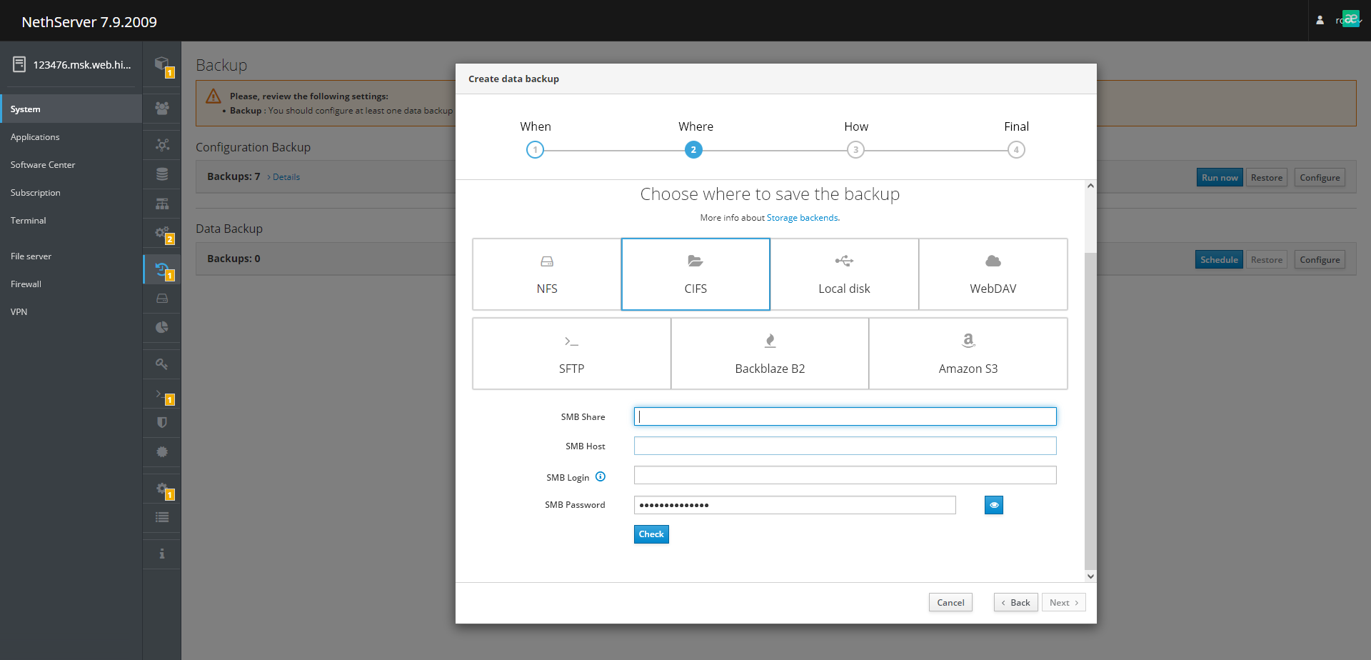

Hello.
It’s been hours since I can’t figure out how to fill in the fields correctly to run a backup. The computer is logged into the domain, there is a VPN connection to it. The server is pinging it.
Please help.
For NFS I write like this:
NFS Share: 10.0.0.0.3:/net - I have also tried \10.0.0.3\net
NFS Host: DESKTOP-ILNJFNL
For CIFS I write it like this:
SMB Share: 10.0.0.0.3:/net - I’ve also tried \10.0.0.3\net.
SMB Host: DESKTOP-ILNJFNL
SMB Login: administrator - this is the login of the domain administrator.
SMB Password: **** is the domain administrator password.
The problem is on the screenshot.
There is a video, but there is no Host field. I can’t understand what should be entered there. There are videos with other versions and there is no such strange field there:

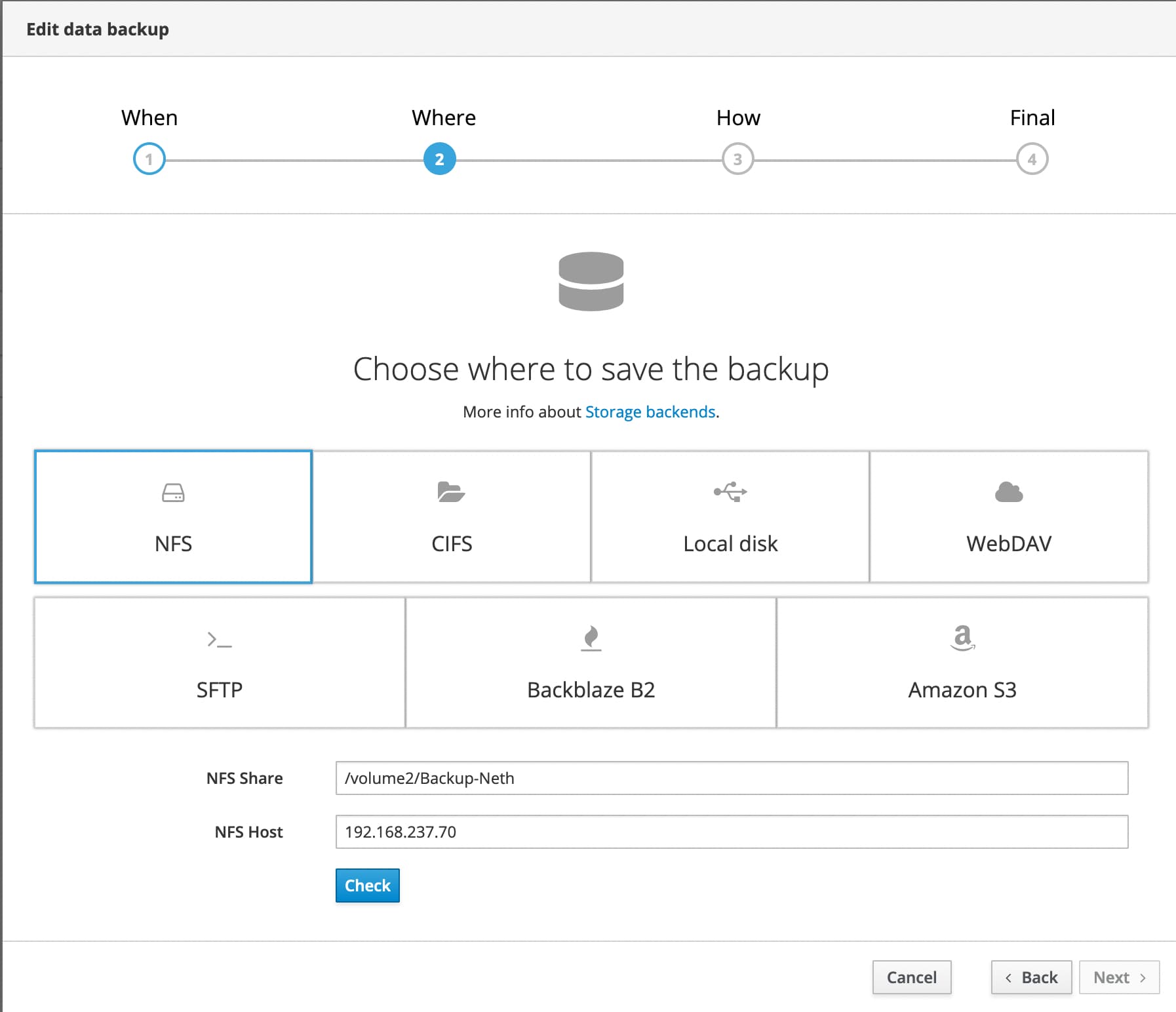

Why use SMB/CIFs instead of the native UN*X / linux protocol NFS? NFS has much less overhead, using NFSv3 does not need any Authentification (Except for IPs, which are anyway static)…
I always use NFS. On the backup target, NFS retains the correct permissions, SMB/CIFs implements Windows like ACLs, which do NOT reflect what UN*X / Linux uses or needs.

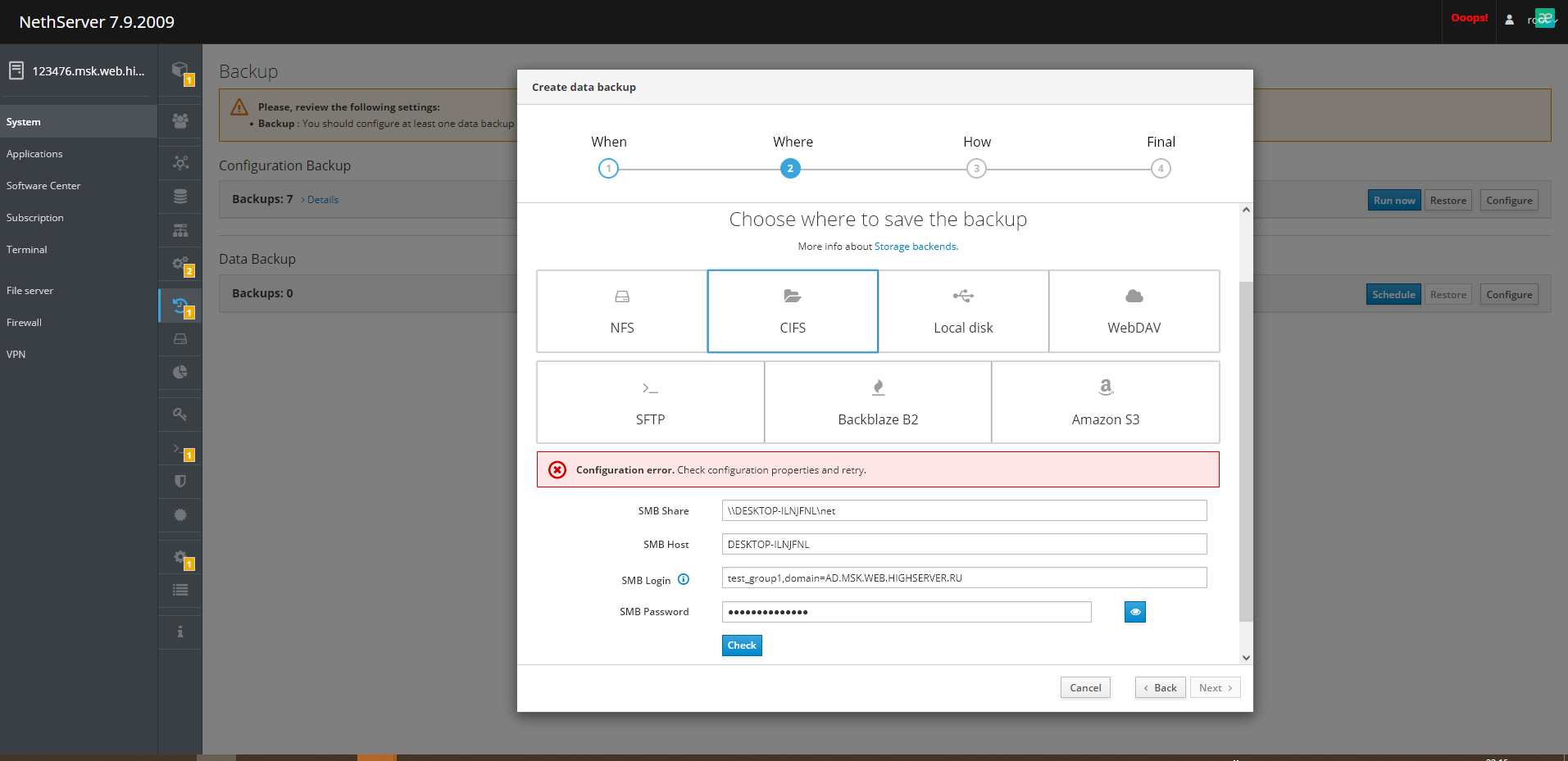

As I see it, you’re trying to use a Windows Group, not a user for Authentification. I don’t think this can work.
In the screenshot, a NethServer uses Duplicity / NFS to backup to a Synology NAS. This works rock solid!

One can ALWAYS use a SMB share instead of NFS: Here a USER and PASSWORD are needed, not a GROUP!!! On a Windows PC, you also have to log in using a USER, not a GROUP. A GrOUP is not intended for Login!
