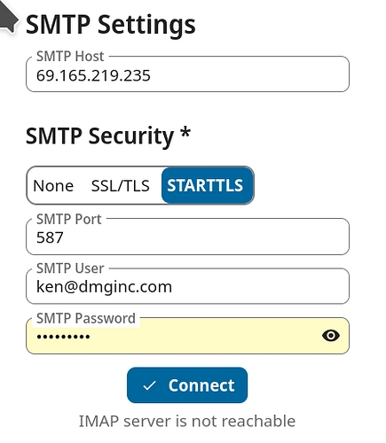

It is interesting that I have landed on this thread with the exact same problem listed by Tony on Feb 11. I am using nextcloud 1.5. Followed all the steps listed here — to no avail.
It has stopped me from trying to use nextcloud.
AFAIK Nextcloud can send notifications via Mail app as documented in Email notifications — NS8 documentation. See Use Mail app instance option.
Feel free to open a new Support topic to get help.
Thanks for the reply, but I believe that I have not explained myself clearly. It is not email notifications that I am having issue with, it is setting my personal email within the nextcloud mail app. I have installed Mail, Webtop PLUS Webmail on the same node and they all work fine. I just installed nextcloud in order to test SMS Relentless amongst other apps. I added the Mail app to nextcloud and inserted all of my personal settings to see my email. Regardless of FQDN, wg0 ip and the loopback ip - in all cases I receive “IMAP server is not reachable”.
I have followed all the steps listed above

Security needs to be set to “none” for both IMAP and SMTP, see Mail app in Nextcloud not working with NS8 mail server - #5 by mrmarkuz
Bingo! I thought that I tried that already. I guess that I hadn’t. Thanks so much Markus. It’s working. Now on to the rest of my testing
