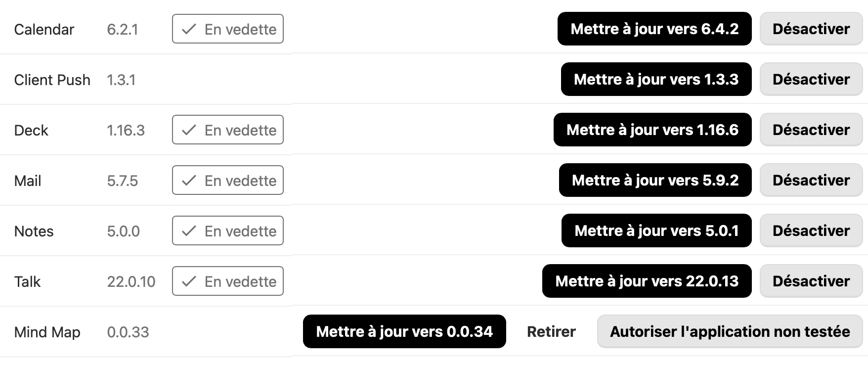

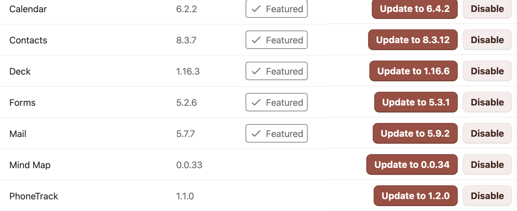

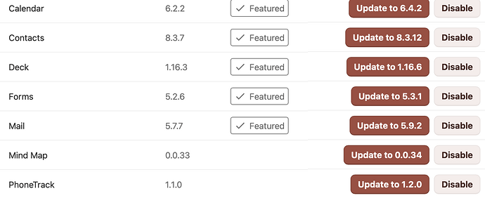

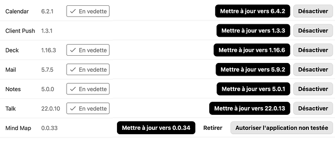

I only use some additional modules from the regular app store, “Featured” or not :
Just tried to update to 1.7.1 (without updating the modules) : unsurprisingly I had to do an occ upgrade.
