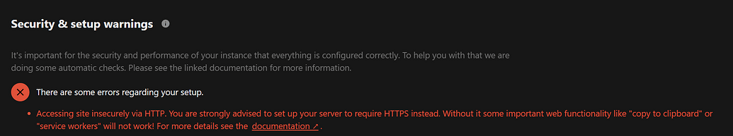

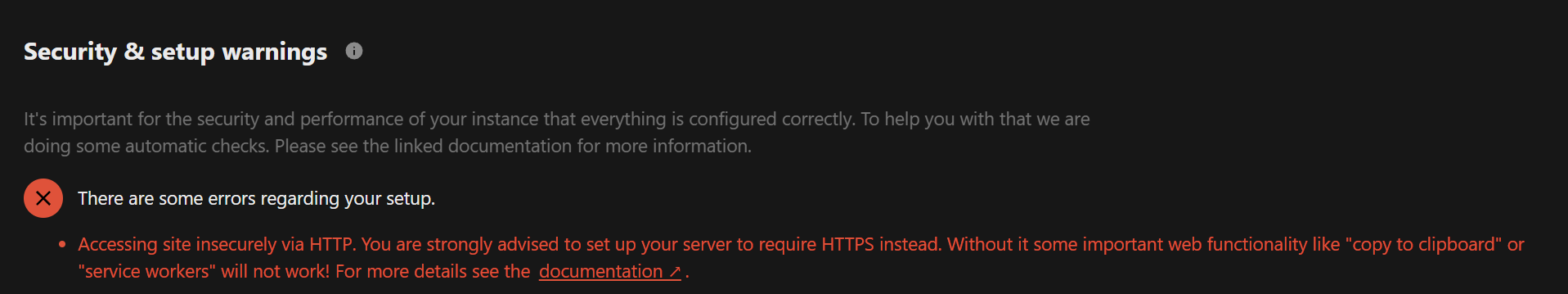

I have been unable to clear the Nextcloud error in routing http to https. This is affecting, programs like Nextcloud mail which the webpage does not load correctly. Looking at the errors received at the browser, I see there are indeed mixed content errors on page loads.
I have searched Nextcloud forums (including the mail app forum) and well as NethServer forums for leads with no luck. Has anyone got any ideas on what I might have missed?
Nextcloud error -
Browser page loading error when accessing Nextcloud mail app -

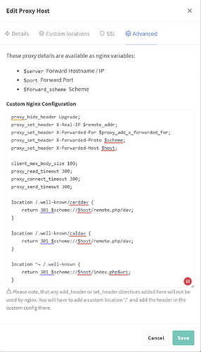

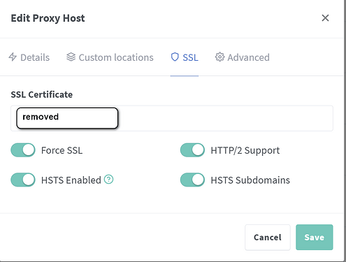

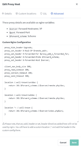

I think nginx proxy manager is configured wrong.

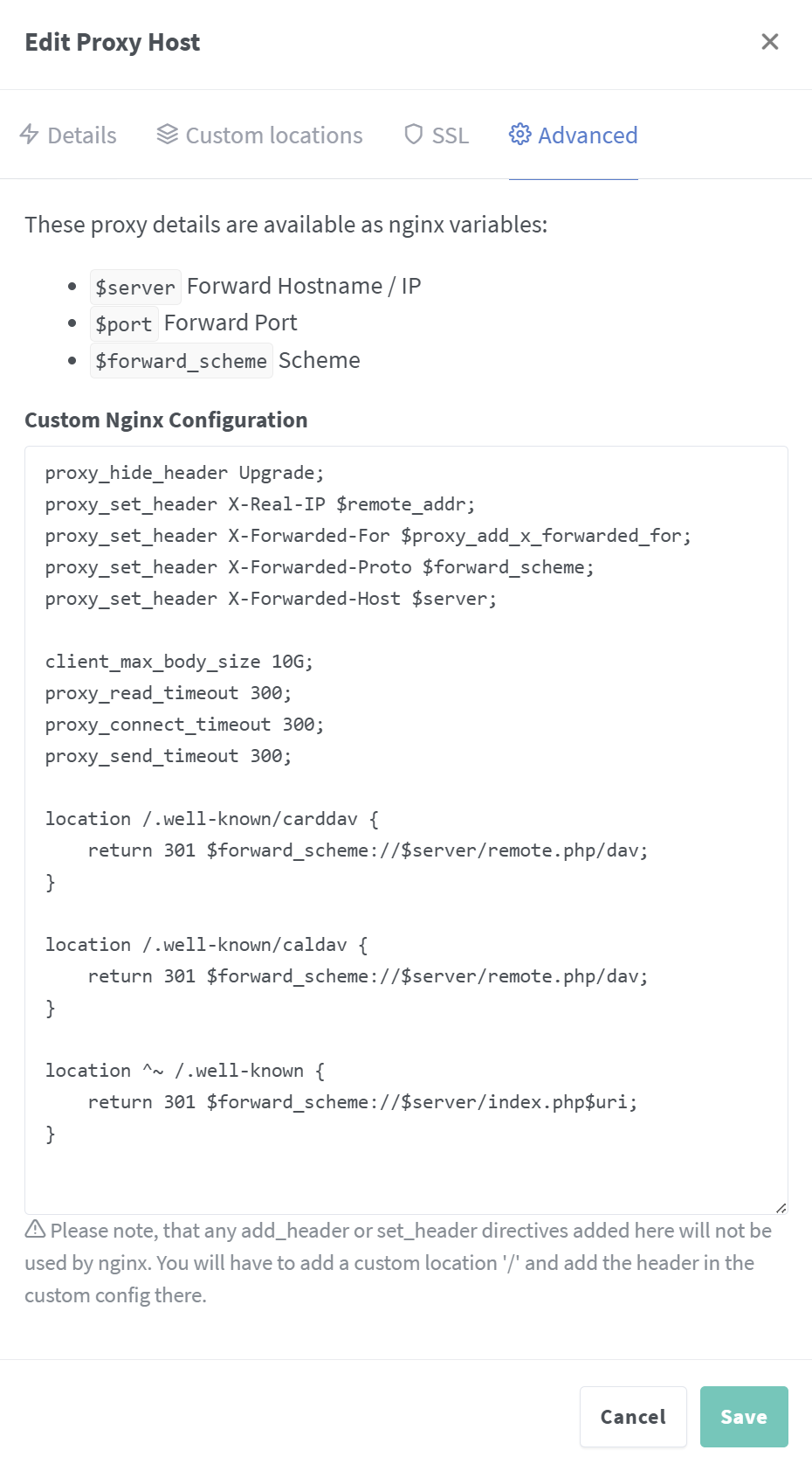

In the “Edit Proxy Host” screenshot you are using wrong variables, they are underlined in red. For example you’re using $scheme but it should be $forward_scheme as explained in the instructions on top. Also instead of $host it should be $server.
Thanks, Markus.
Good suggestion. But made no difference. Same error.

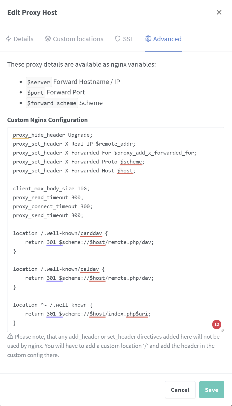

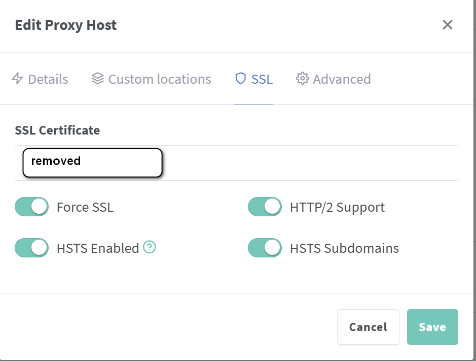

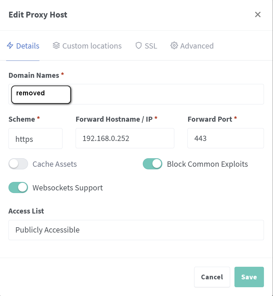

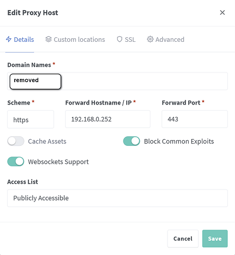

Originally had this set as per below. But following other forums, there was a recommended set-up of NPM to work with Nextcloud, which I tried.

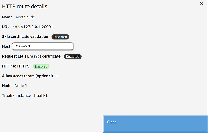

I am investigating if it is a NethServer proxy (Traefik) issue. Maybe something about running behind NPM and not having an SSL cert from NethServer so NethServer does not propagate redirections to https as per Hardening and security guidance — Nextcloud latest Administration Manual latest documentation ?

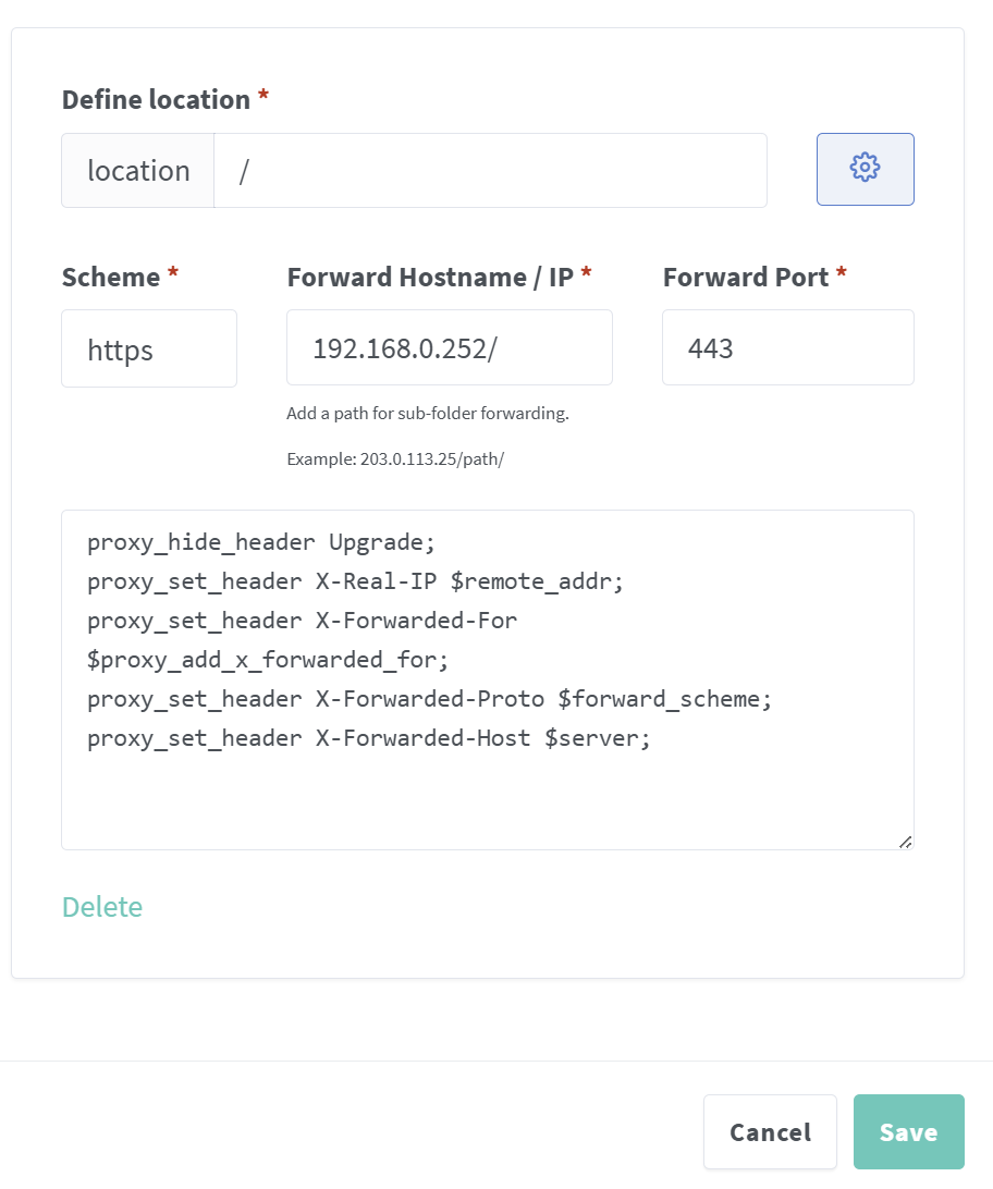

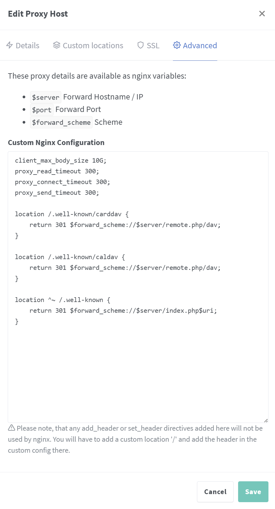

I have change back now to below in which I have separate Custom locations set-up. This does not work either -

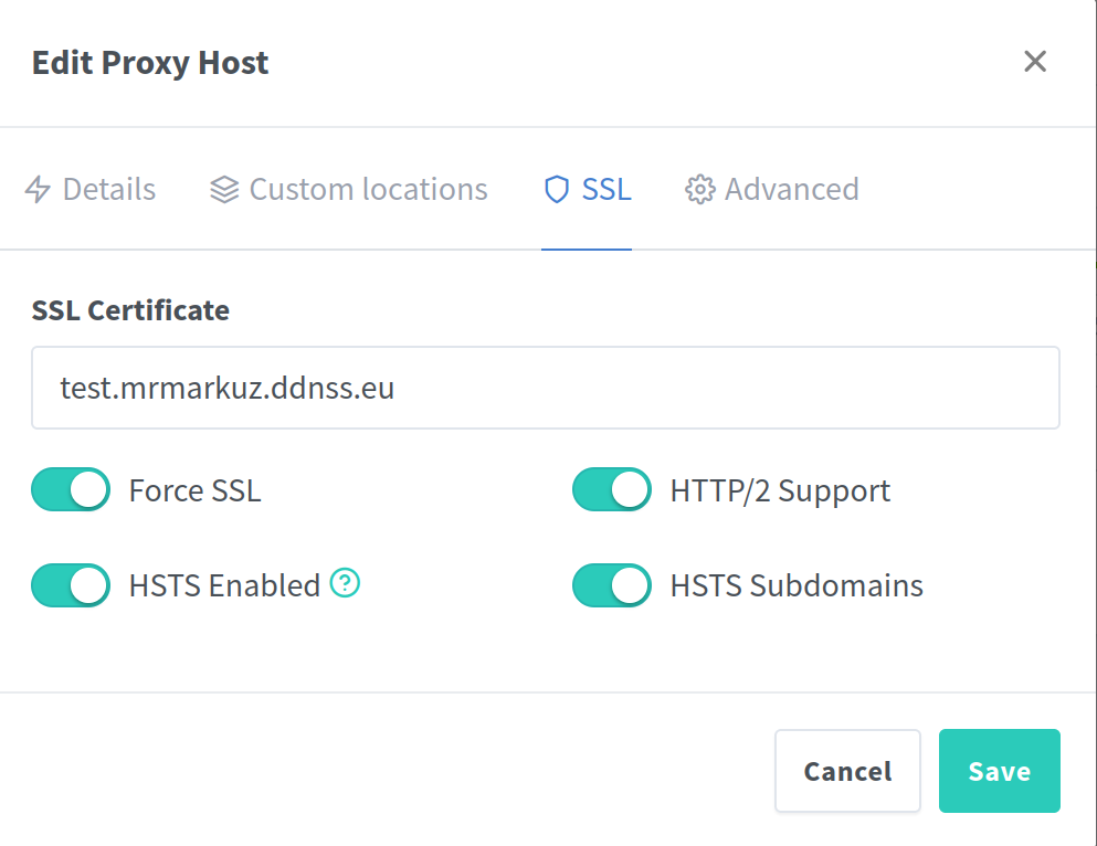

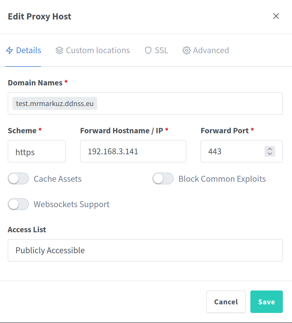

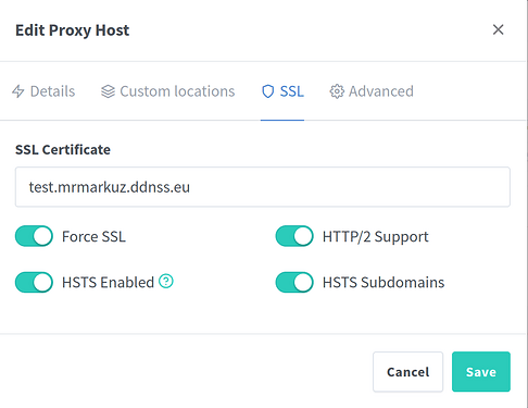

I tested it and it worked, I could login to Nextcloud.
You don’t need to setup custom locations and the Advanced tab at all.
Details:
SSL:
I’m using domain names instead of paths. Using paths can also lead to those mixed-content warnings.

As there is an error reported via Nextcloud admin settings referring to http traffic should be routed to https I think it is related to the Mail app not working correctly.
In any case, I tried no settings NPM as per your testing and I can still access Nextcloud via https. But the error is still reported via Nextcloud admin settings referring to http traffic should be routed to https , and still the mail app has the same mixed content error via browser dev tools.

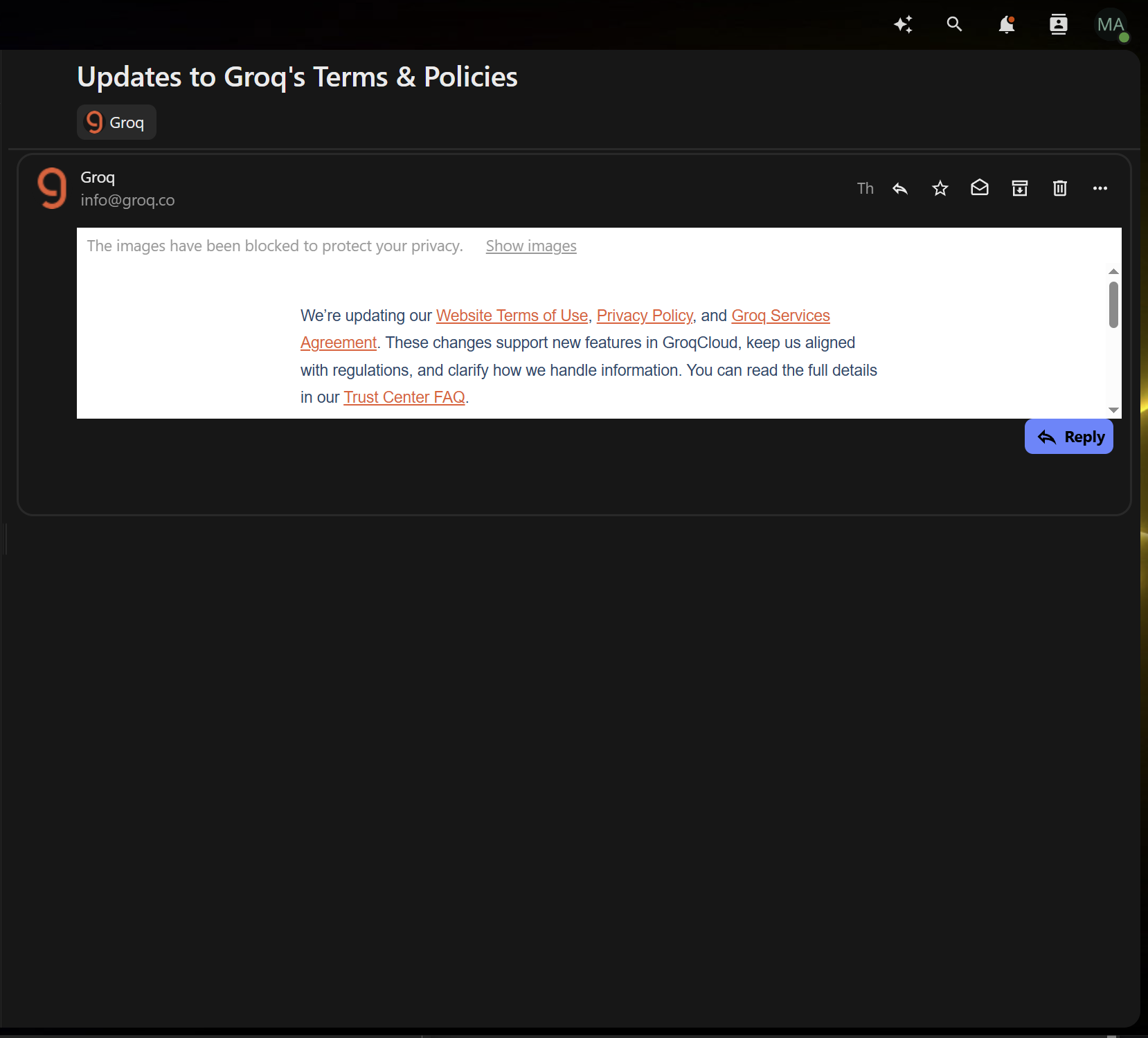

Update - Still have not found a fix, but I have noticed since Nextcloud mail app update version 5.4.0 there is a scroll bar on the HTML email. The iFrame will still not open more than this small letterbox on all HTML emails.
I tried to reproduce but without success.

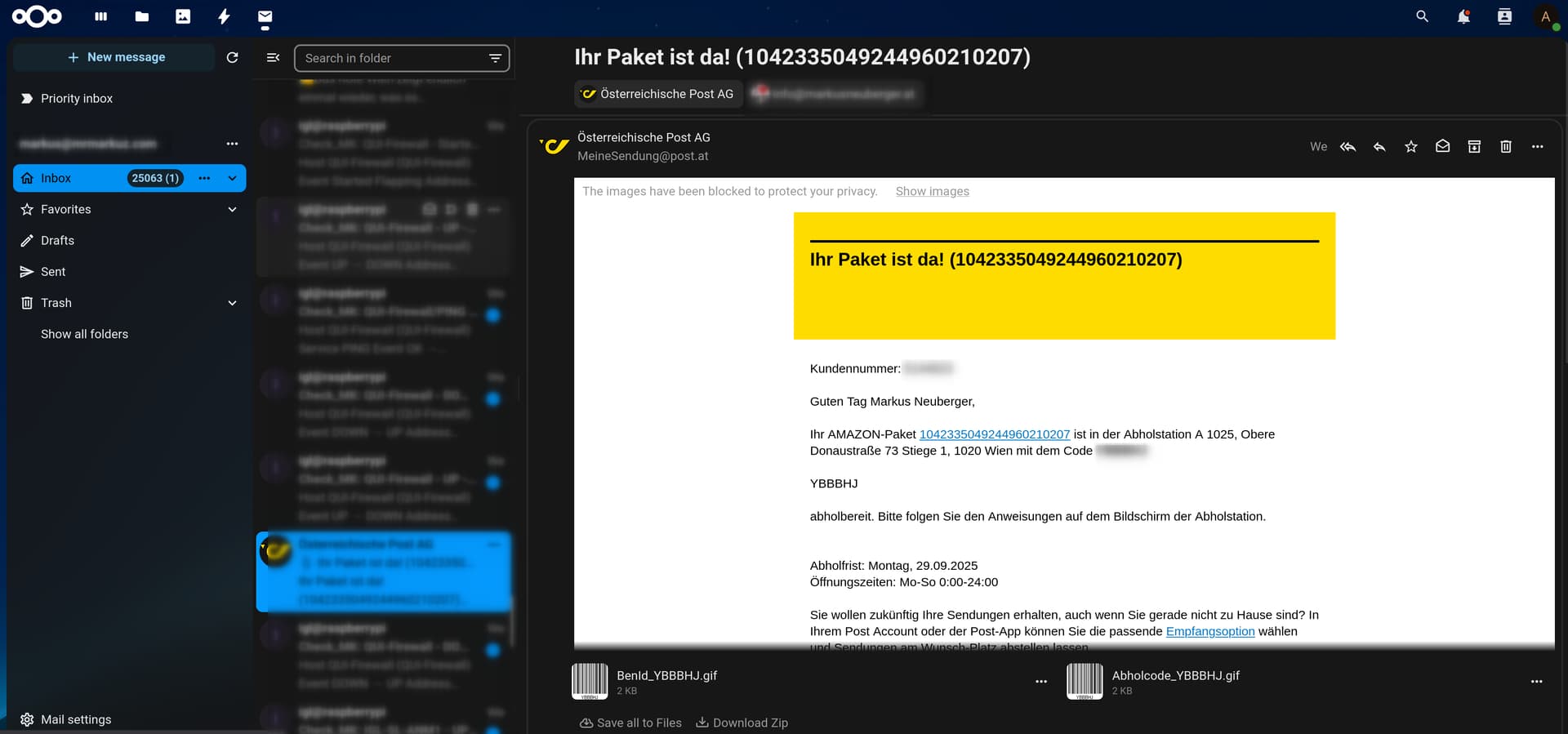

Here Mail 5.4.0 looks like this:

Even as I am accessing Nextcloud under a ssl, Nextcloud reports the following -
and the browser reports -
