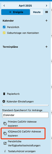

the “internal link” which is displayed in the web interface when I click on (literally translated): Edit and share calendar

If you do this, you will receive a link with the UUID like https://nextcloud.yourdoainde/remote.php/dav/principals/users/724C60D-AFA9-4A31-98C3-1M2803A32B13/

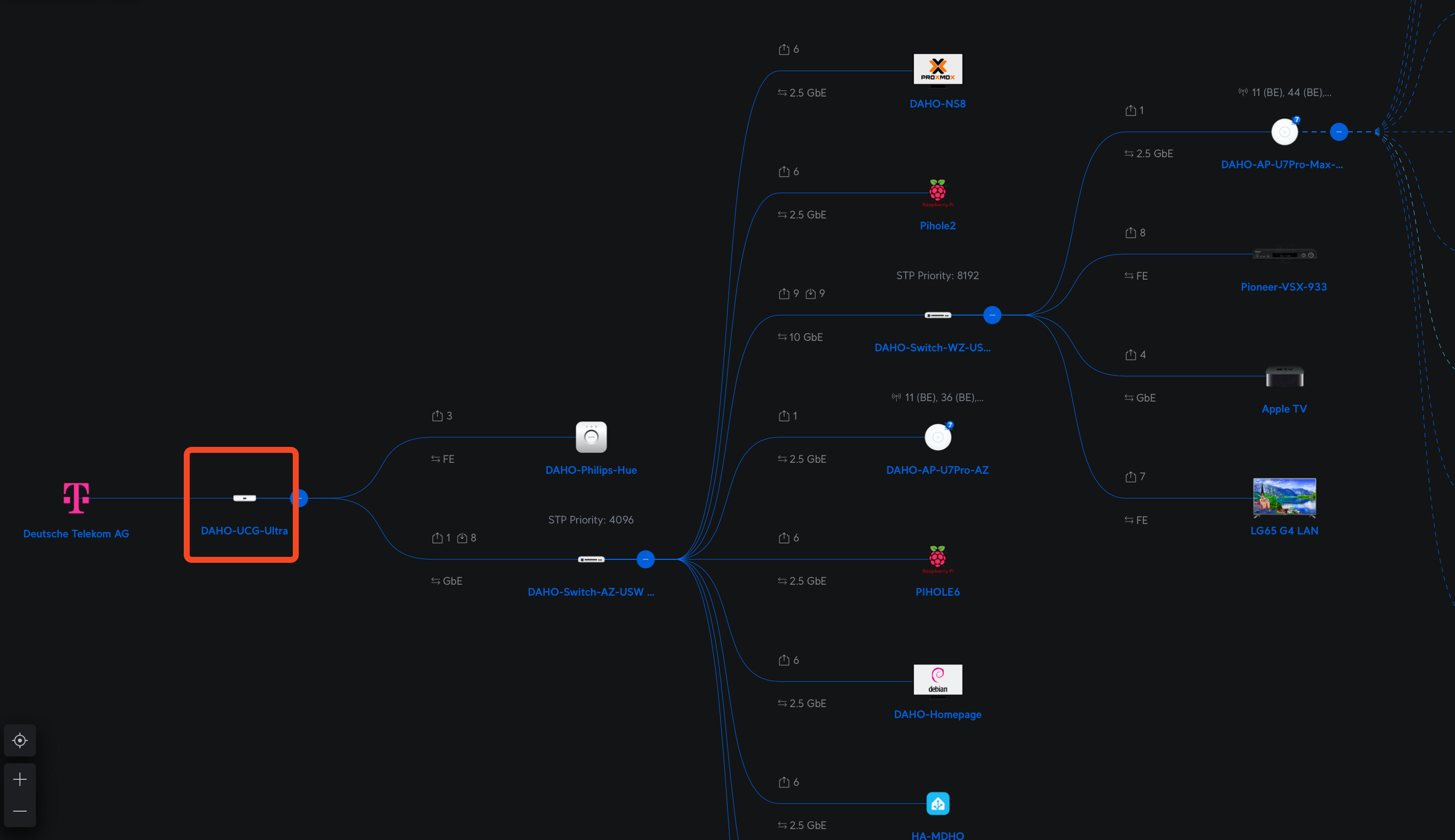

These can be different devices: boxes with OPNSense, NethSecurity or my preference UniFi Cloud Gateway Ultra .
If you compare the costs of purchase, configuration and administration in the lifecycle, you will find that you are best off with it. Not to mention the functionality and usability.
Hmmm, thanks… I’m always a bit sceptical about such devices using a USB-C power adapter… but okay, I like the Unifi products in general… have multiple switches at several customers which all work greatly.
Probably I will have to restructure the network and use an intermediate gateway.
