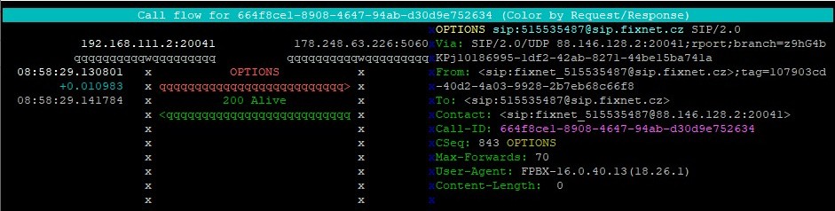

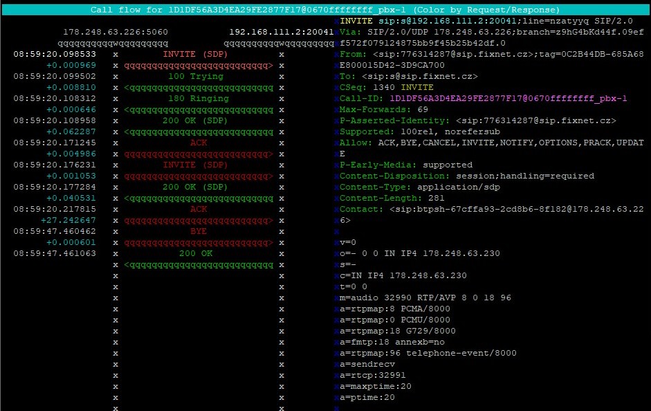

select the INVITE and hit enter, you should se the details of how where the package goes. Take a screenshot and we’ll try to figure it out together. Also do the same with the OPTION as it could be the cause of the problems with the INVITE
that’s a working call
Yes this one is. I’ll post back later if it stop to work again.
