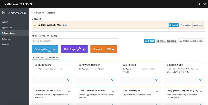

I just tried testing a NethServer install on KVM with the Q35 BIOS latest (at least 6.0!)
Just finished install, so far nothing irregular. Now creating some “load” with updating…

As said and shown in the screenshots, I’m using Q35 / 60(+)…
It could be the KVM implementation in UNRAID uses an older Version than my Proxmox (Top up to date!)…
Note: I’m using a KVM-64 CPU here, not “host”…
This should make the hardware practically negliciable, this even allows a Windows10 to run with an AMD or Intel underneath - no blue screens!
Windows does not even realize the CPU has changed…
A good idea may be to find out the used versions - I’ll need to check what Proxmox is using…
As to the VM:
So far nothing unstable…
With 4 GB RAM and 4 CPU cores (The hardware is a almost 10 year old HP Proliant ML110 G7…) it’s quite fast, too.
:slight_smile:
