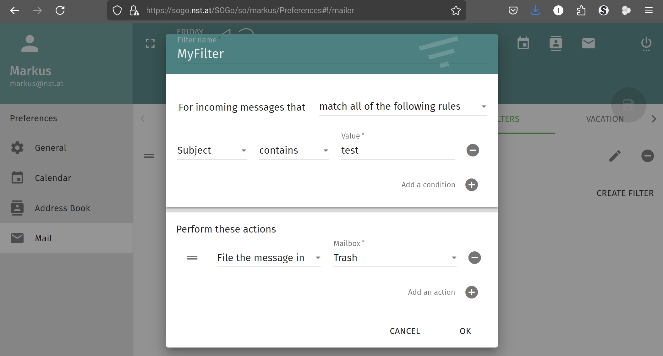

I couldn’t reproduce the issue.
Following sieve filter is working:
Maybe there’s a conflict between different (web) mail clients that want to set their own default filter rule?
