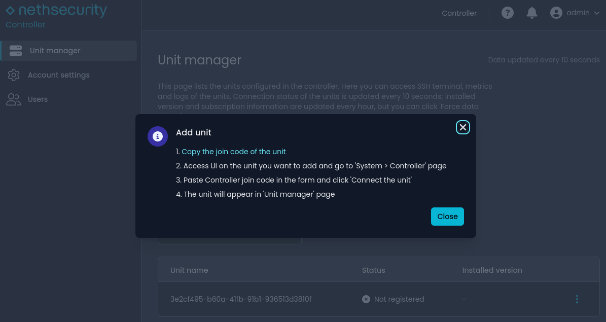

NethSecurity controller requires NethSecurity installed on another device (or as a VM). The firewall is not integrated like in NethServer7.

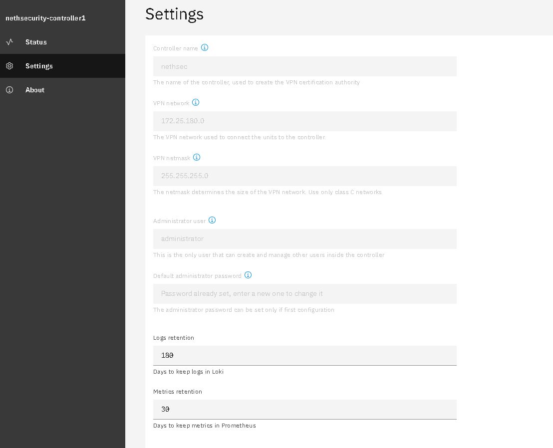

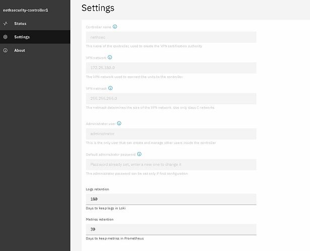

Accessing the configuration page after saving changes which also ended in error. The settings page looks as following. All the boxes are greyed out. It stays that way for a while, then it shows time out error at the top of the page.

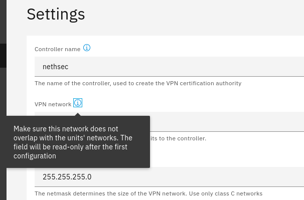

That some settings are grayed out after first config is normal (it is for setting the VPN tunnel between the controller and the firewall units. Without subscription you can manage up to 3 units form the controller). The info message box warns about it:

That is correct. The firewall is independent from from NS8. The controller allows to manage it from the cluster admin interface (well, not exactly, as you have to open the nethsecurity controller page and login with the credentials set):
Yes. You still can enter the settings page but some fields are only set once.
