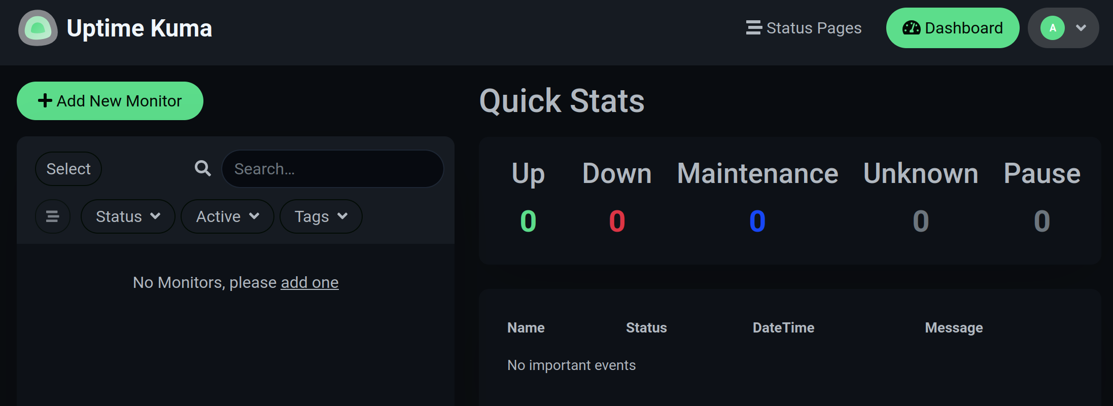

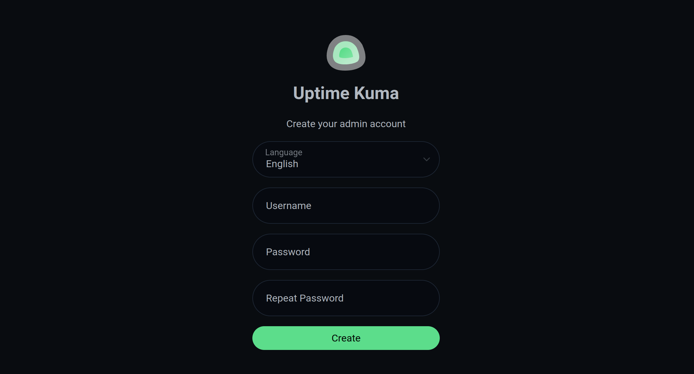

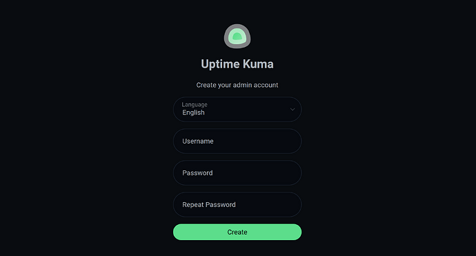

After configuring it in the app settings:
Create admin:
Uptime kuma is ready to use:
