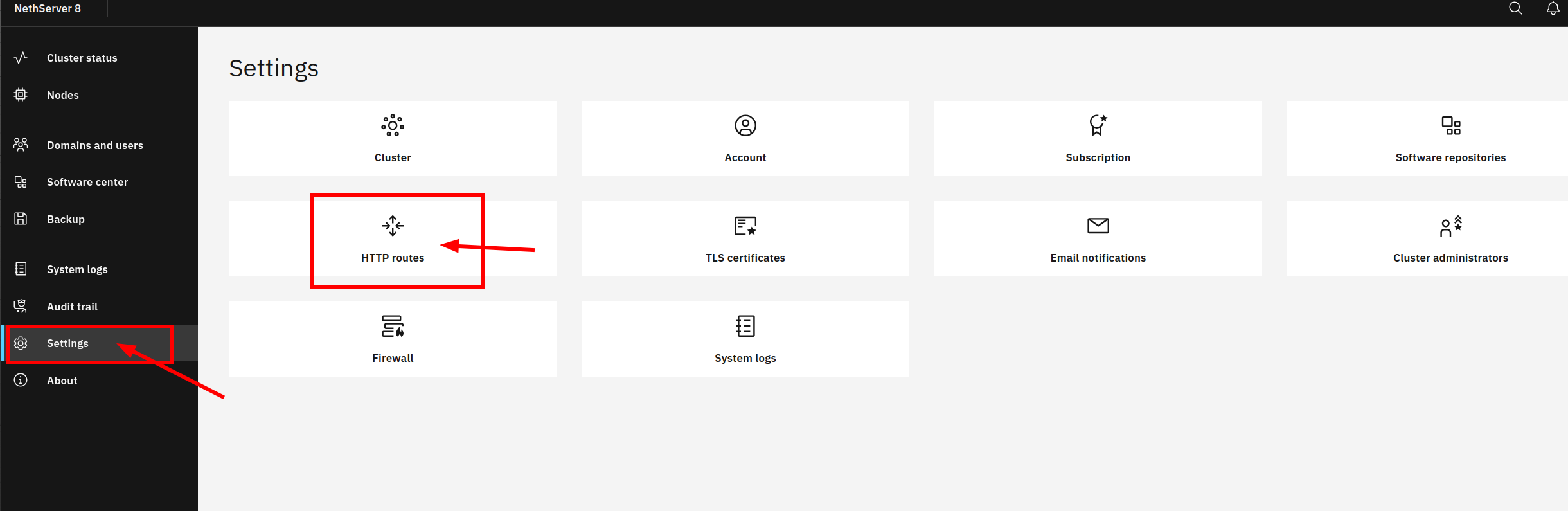

For the old path style URLs you can try to recreate some of them using manual HTTP routes.
Thank you @dnutan for the reply. Ah! yes Traefik proxy. That handles the proxy in NS8. This answered another question of mine :wink: And it is in the Settings under HTTP routes like you said.

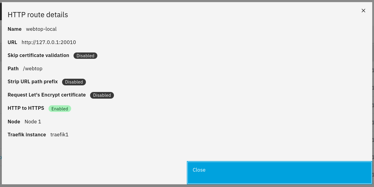

I did create a webtop-local to allow me local access. I will post it here for others to see. Just in case it helps them.
Hope this helps someone else.
