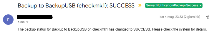

Some time ago, I used the script provided by @giacomo in this thread to receive email notifications for module backups.
Put it at /var/lib/nethserver/cluster/events/backup-status-changed/20notify.
#!/bin/bash
# Change the following variables to match your environment
MAIL_FROM="no-reply@nethserver.org"
MAIL_TO="giacomo@nethesis.it"
MAIL_SUBJECT="Backup status changed:"
MAIL_TEMPLATE="The backup status for {BACKUP_NAME} on {MODULE_ID} has changed to {STATUS}. Please check the system for details."
# WARNING - DO NOT EDIT BELOW THIS LINE (unless you know what you're doing)
# Redis command
rdb="redis-cli --raw"
# Read event data from stdin
read -r event_data
if ! echo "$event_data" | jq . >/dev/null 2>&1; then
    echo "Failed to parse JSON input" >&2
    exit 1
fi
# Extract necessary fields from event_data
module_id=$(echo "$event_data" | jq -r '.module_id')
backup_id=$(echo "$event_data" | jq -r '.backup_id')
leader_id=$($rdb hget cluster/environment NODE_ID)
self_id=$NODE_ID
if [[ "$self_id" != "$leader_id" ]]; then
    exit 0 # LEADER ONLY! Do not run this procedure in worker nodes.
fi
backup_name=$($rdb hget "cluster/backup/$backup_id" "name")
errors=$($rdb hget "module/$module_id/backup_status/$backup_id" errors)
if [[ -z "$errors" ]]; then
    echo "INFO: Status unknown, exiting." >&2
    exit 0
fi
if [[ "$errors" == "0" ]]; then
    status="SUCCESS"
else
    status="FAIL"
fi
# Send email
subject="$backup_name ($module_id): $status"
msg="$(echo "$MAIL_TEMPLATE" | sed "s/{BACKUP_NAME}/$backup_name/g; s/{STATUS}/$status/g; s/{MODULE_ID}/$module_id/g")"
echo "$msg" | runagent ns8-sendmail -s "$subject" -f "$MAIL_FROM" "$MAIL_TO"
Then make it executable:
chmod a+x /var/lib/nethserver/cluster/events/backup-status-changed/20notify
Bear in mind: it will send a notification for each instance inside a backup schedule.
This script will send an email like this for each module:

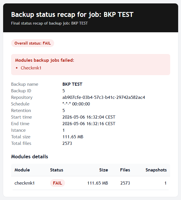

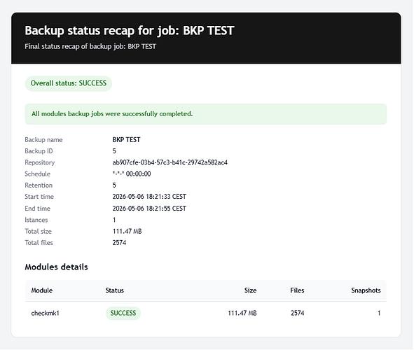

Receiving one email per module was quite annoying for me, so I opted for a “recap mail” solution instead.
  • A single email that includes a summary of the various modules backup:
  • In case of failed modules, it highlights them clearly (this is a forced example):
It’s almost as simple as @giacomo solution but you need to create two files in two different directories:

def send_mail(subject, body):
    cmd = [
        "runagent", "ns8-sendmail",
        "-s", subject,
        "-f", MAIL_FROM,
        MAIL_TO
    proc = subprocess.run(cmd, input=body, text=True, capture_output=True)
    if proc.returncode != 0:
        raise RuntimeError(proc.stderr.strip() or proc.stdout.strip() or f"ns8-sendmail failed with exit code {proc.returncode}")
def main():
    if len(sys.argv) < 2:
        sys.exit(0)
    backup_id = sys.argv[1]
    backup = get_backup_data(backup_id)
    if not backup:
        sys.exit(0)
    summary = summarize_backup(backup)
    subject = build_subject(backup.get("name", f"backup-{backup_id}"), summary)
    body = build_body(backup, summary)
if __name__ == "__main__":
    main()
Then run:
chmod +x /usr/local/lib/nethserver/ns8-backup-recap
(Or whatever name you have chosen)
[Be careful if you change the name be shure to edit it in the 90notify script]
This will be everything you need to do.
Operationally, it works correctly, but the only issue is that if the repository is unavailable and the NS8 system encounters an error, the notification isn’t sent. Any ideas on how to integrate it better?
Another concern is that the wrapper file I’ve created might be removed during updates, given the directory where it lives.
P.S. It’s almost fully AI-generated, so it may contain some major flaws.
