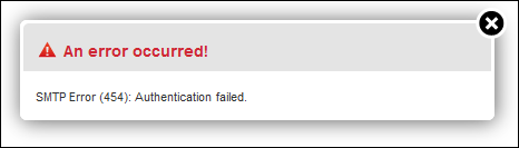

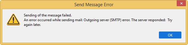

With both restoration Thunderbird and Webmail sending mail gives error but receiving mail is OK.
Thunderbird
Webmail
