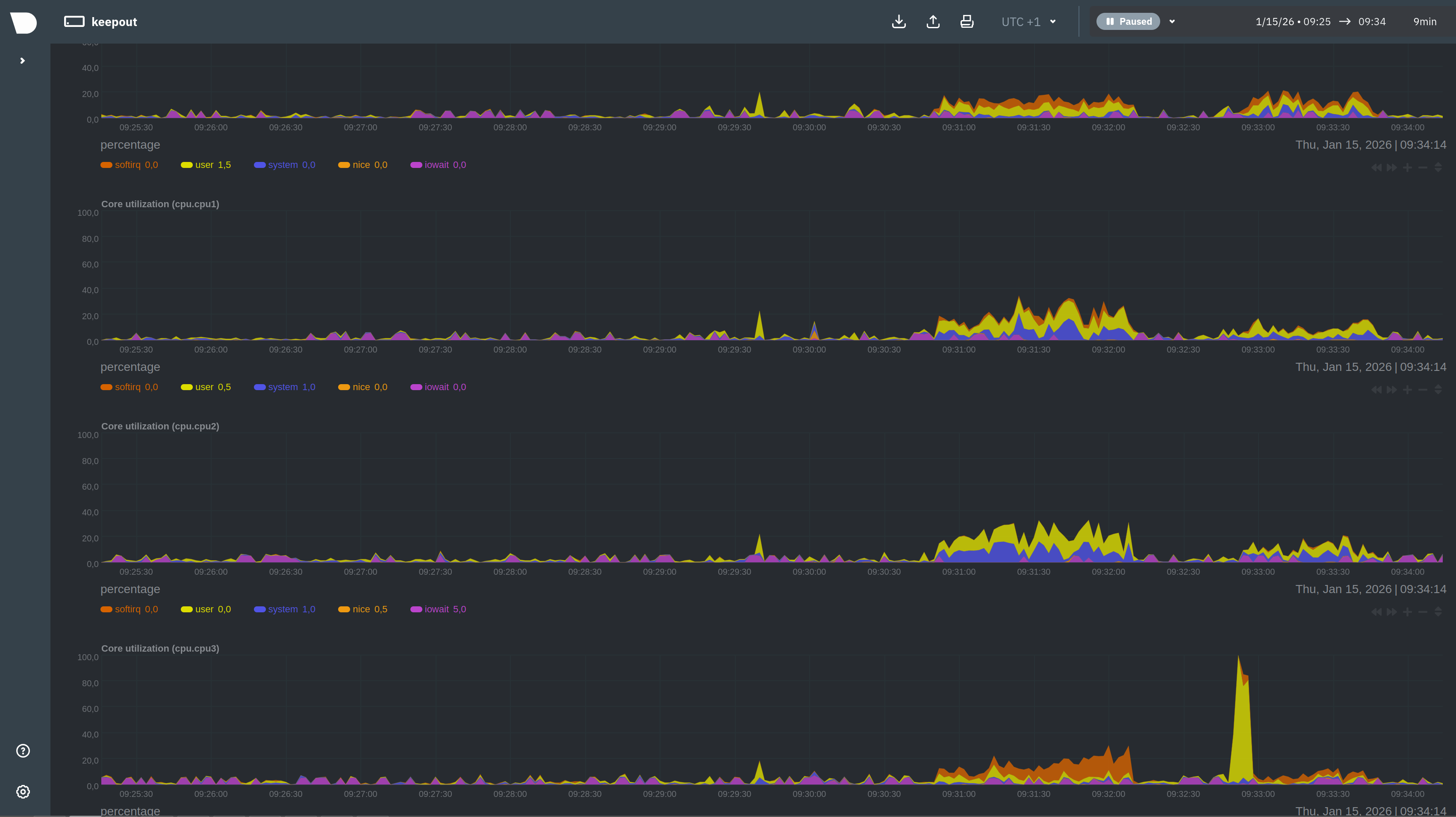

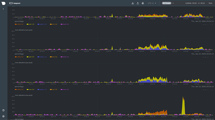

I can’t reproduce, here’s the netdata stats when downloading a big file. Snort is set to balanced. The 4 cores of the Intel N100 CPU are working:
