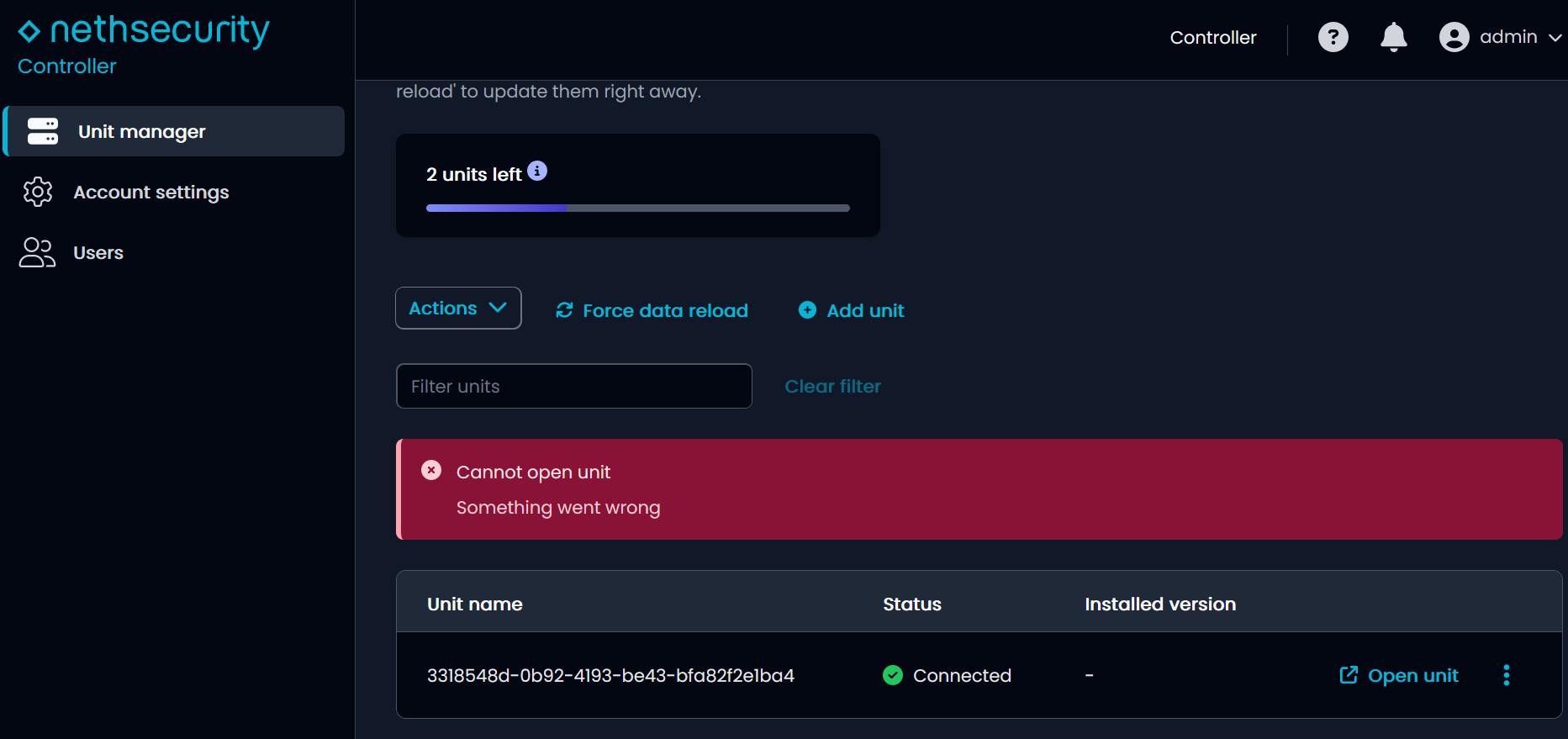

When disabling the web interface as explained in the documentation, the controller doesn’t connect a new unit correctly anymore. It shows connected status but doesn’t show the unit name and when you try to “Open unit” it fails.

Thanks, it’s working as expected now. The controller also connects to the NethSec when the web interface is disabled.
