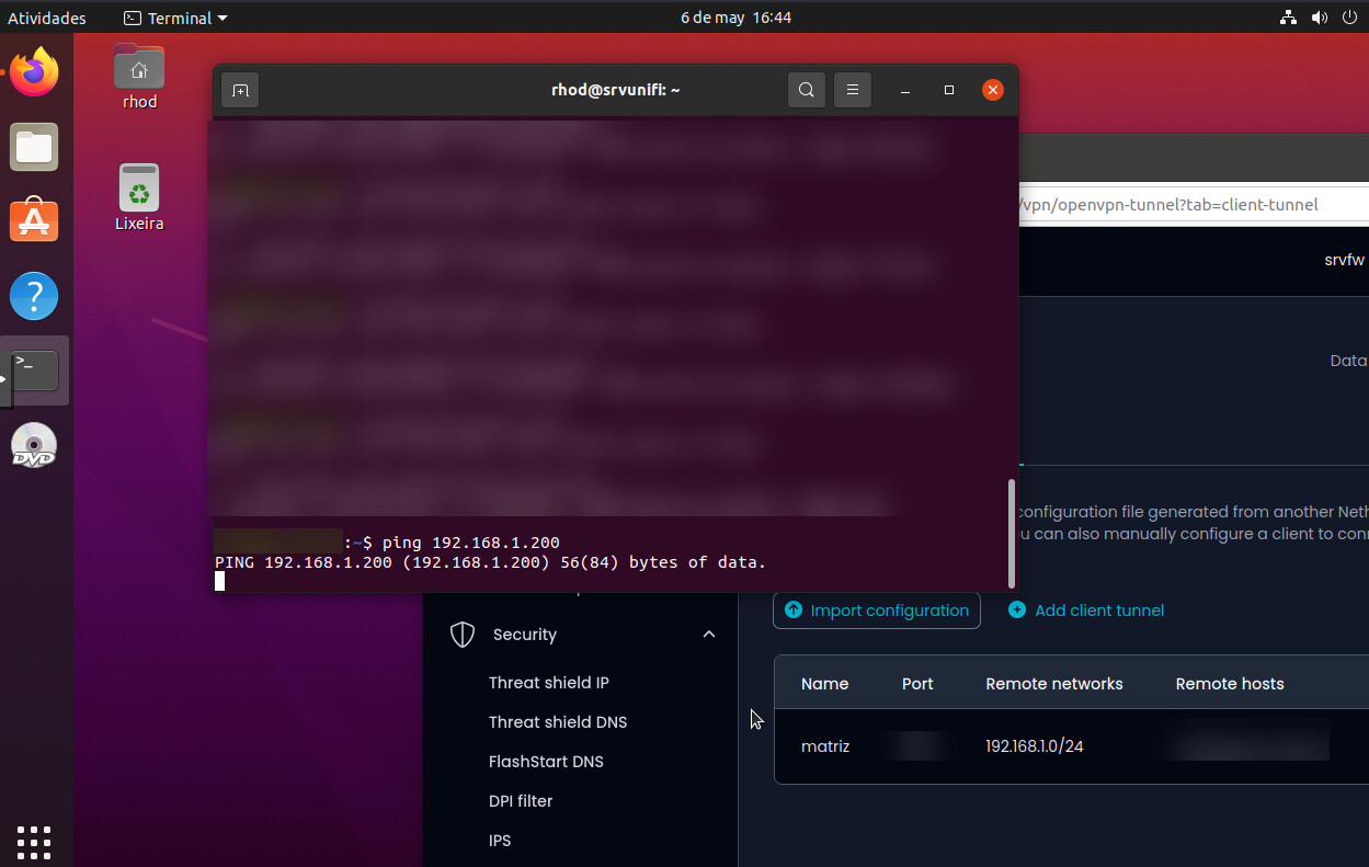

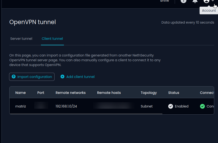

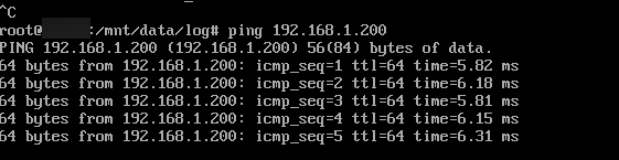

Hello everyone! I configured NethSecurity 8 as an Internet Proxy and OpenVPN Client of another remote NethServer 7.9 server. The connection is ok, from the shell of this client server I ping the IP of a machine of the main VPN, however from the stations I am not able to access the external VPN network. I believe it is something with the NethSecurity 8 Firewall. How can I allow traffic between the NethSecurity 8 LAN network and the remote VPN network of NethServer 7.9? I have tried some rules but none of them worked (LAN to OpenVPN etc).
