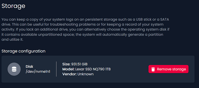

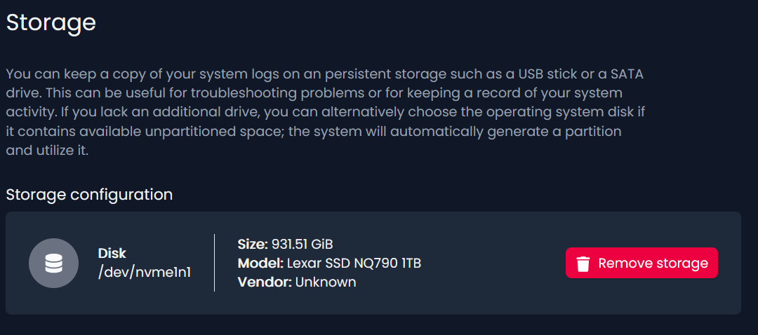

Even though all is working well, I observed at some point the wrong partition was shown in the UI. I have not figured out why but have an strong hunch: If the permanent storage is removed the partition keeps the label ns_data. So while testing I ended up with 3 partitions labelled ns_data
root@NethSec:~# lsblk -o name,mountpoint,label,size,uuid
NAME          MOUNTPOINT LABEL         SIZE UUID
loop0         /overlay   rootfs_data 226.8M b6bcca32-4019-4154-94d8-2db91d6912b2
sda                                   59.5G
└─sda1                   ns_data      59.5G ecdc7c62-d821-4004-b458-cac8ed4002ce
nvme0n1                              465.8G
├─nvme0n1p1   /boot      kernel         16M 1234-ABCD
├─nvme0n1p2   /rom                     300M
├─nvme0n1p128                          239K
└─nvme0n1p3   /mnt/data  ns_data     465.4G 051b1224-5101-43df-8a56-9b25accd3c3a
nvme1n1                              931.5G
└─nvme1n1p1              ns_data     931.5G cd71df60-e662-4d25-b561-3baa735a07c7
Note nvme0n1p3 is mounted on /mnt/data not nvme1n1p1
