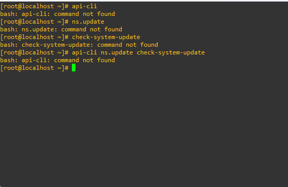

But from SSH you can run: api-cli ns.update check-system-update?
sorry if I answer now, could you write me correctly which commands I should test via SSH thanks
You can show screenshots?
ok wait a moment while I send you everything
It gives me this.

I’m connected via SSH.
