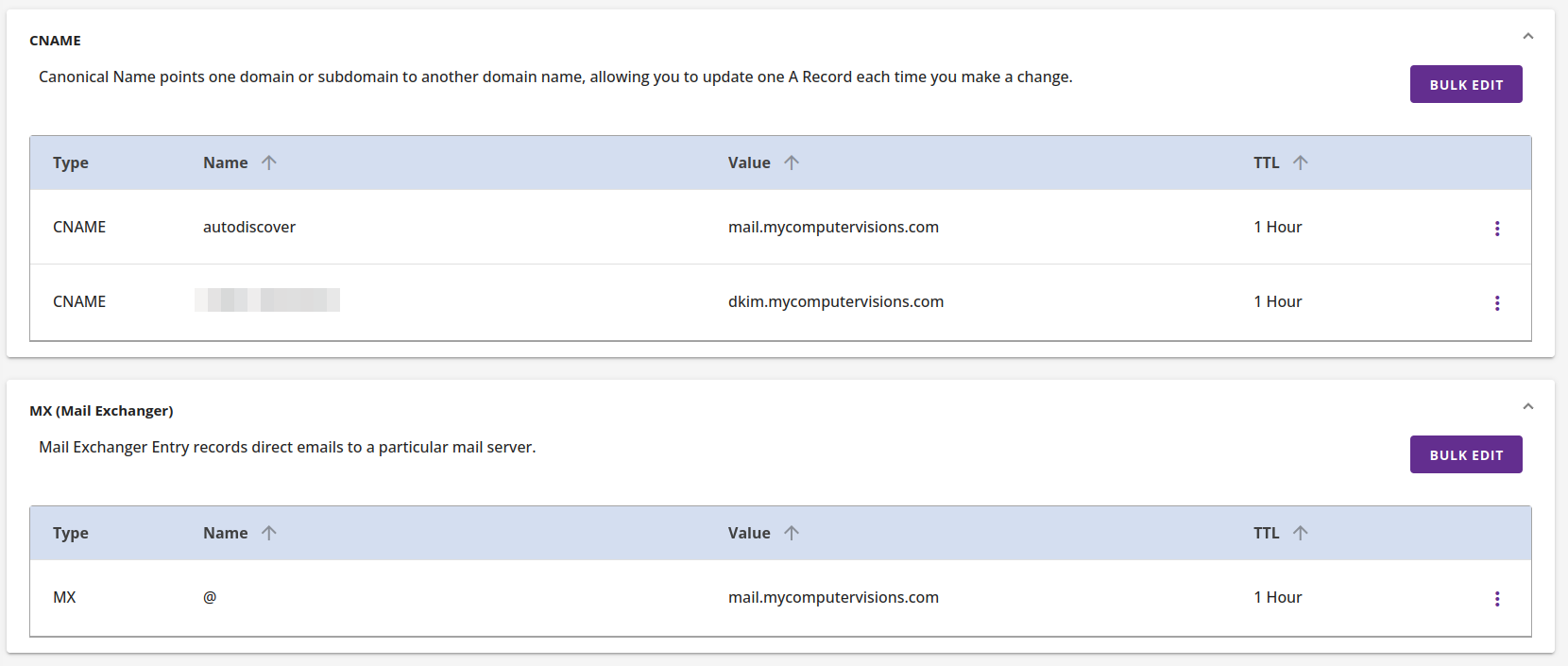

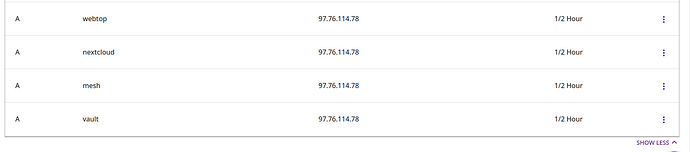

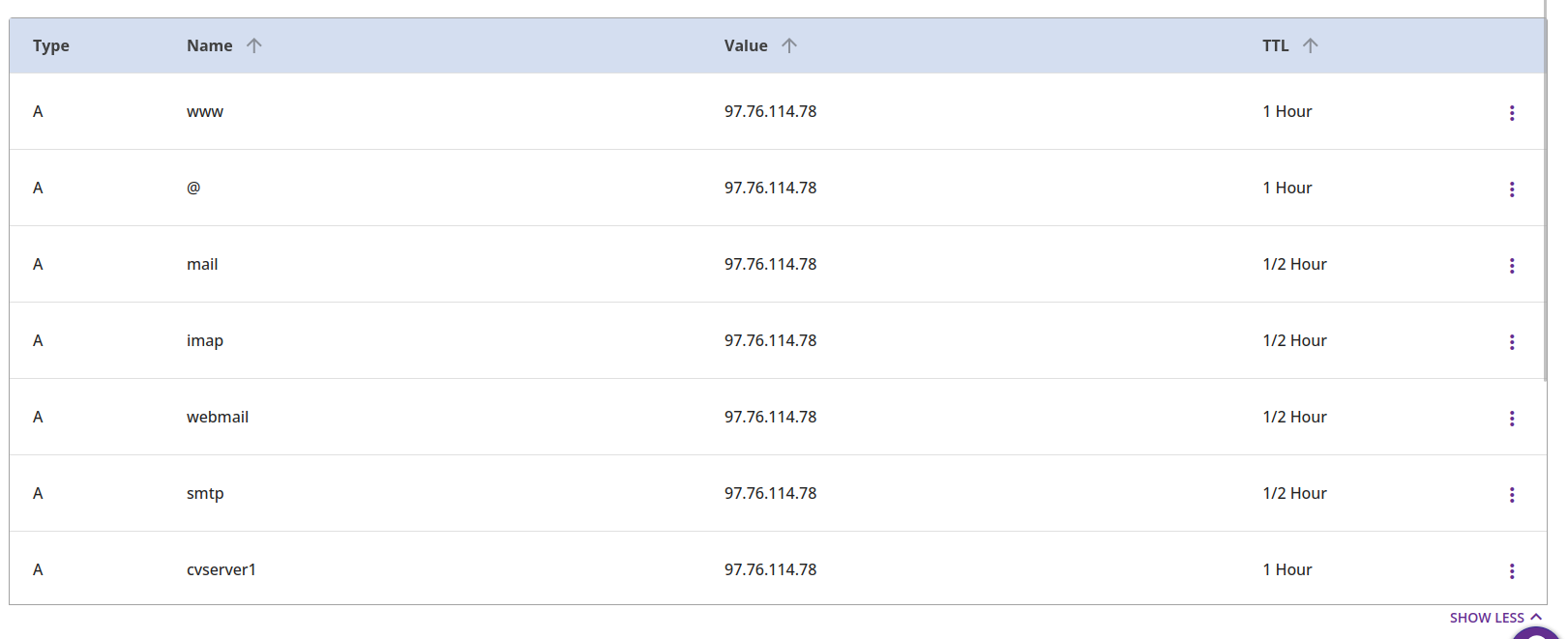

I use Register.com for my domain Registrar, I have check my setting with DNS on registar and they seem to be correct. As far as I know my settings for NethSecurity and NethServer 8 are correct as well.

So challenge is with my setup is that neither NethSecurity 8 or Nethsever 8 can pull a certificate from Let’s Encrypt.

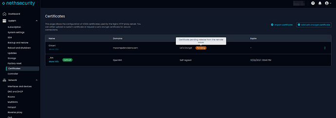

I tried on recently for NethSecurity seen below -
I only did mycomputervisions.com. normally I have a couple that I add to this one. But I just wanted to see if this one would work alone at this time. But it does not.

The certificate generation process can take a few minutes. During this time, the certificate status is Pending.
Yes. I agree. It can take a few minutes. Unfortunately. All the times I installed one on Nethsecurity - left it for days and it never finalized. The current one I did today is still in pending and it’s been well over 20mins or more.
I would guess waiting is not the issue. It must be something else.
