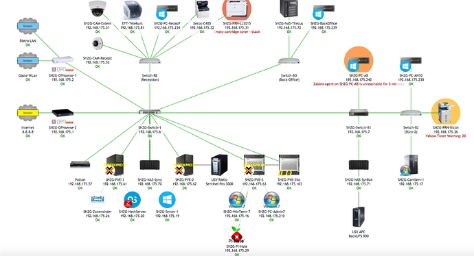

A few tastersâŠ

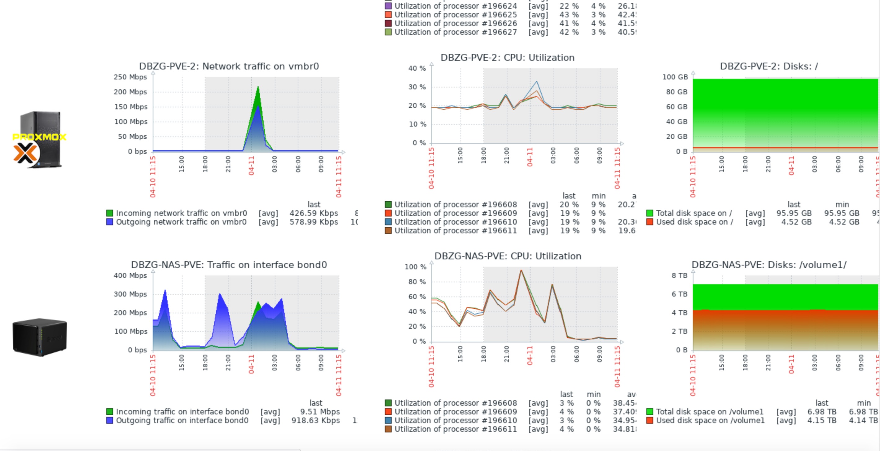

Nice GraphsâŠ
Best of all, it runs easily on your NethServer, thereâs even a module for itâŠ
