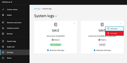

The second blemish - we have now 3x “loki”. How to delete the old loki2 and loki4 ?

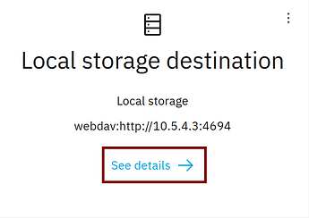

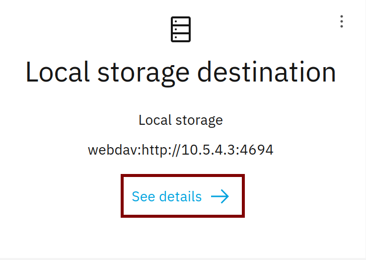

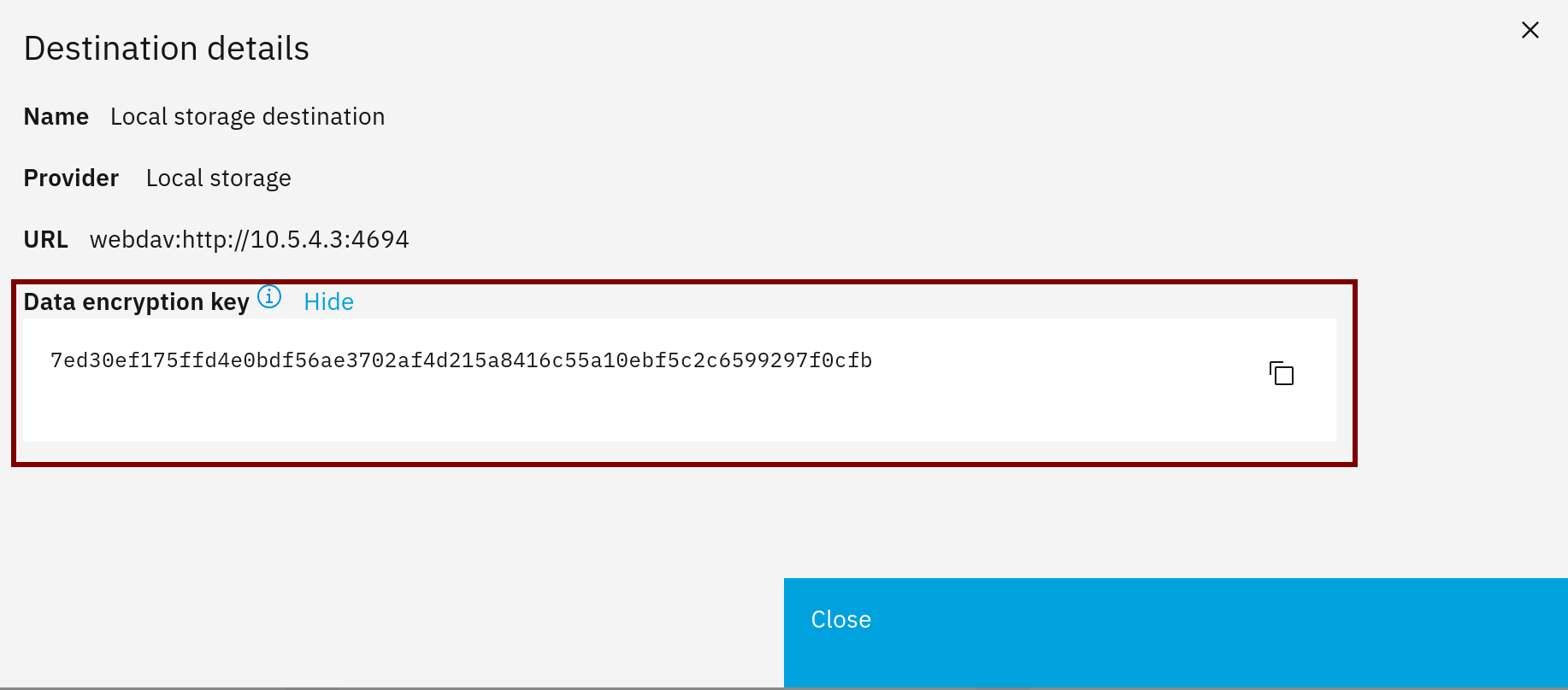

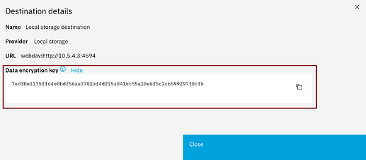

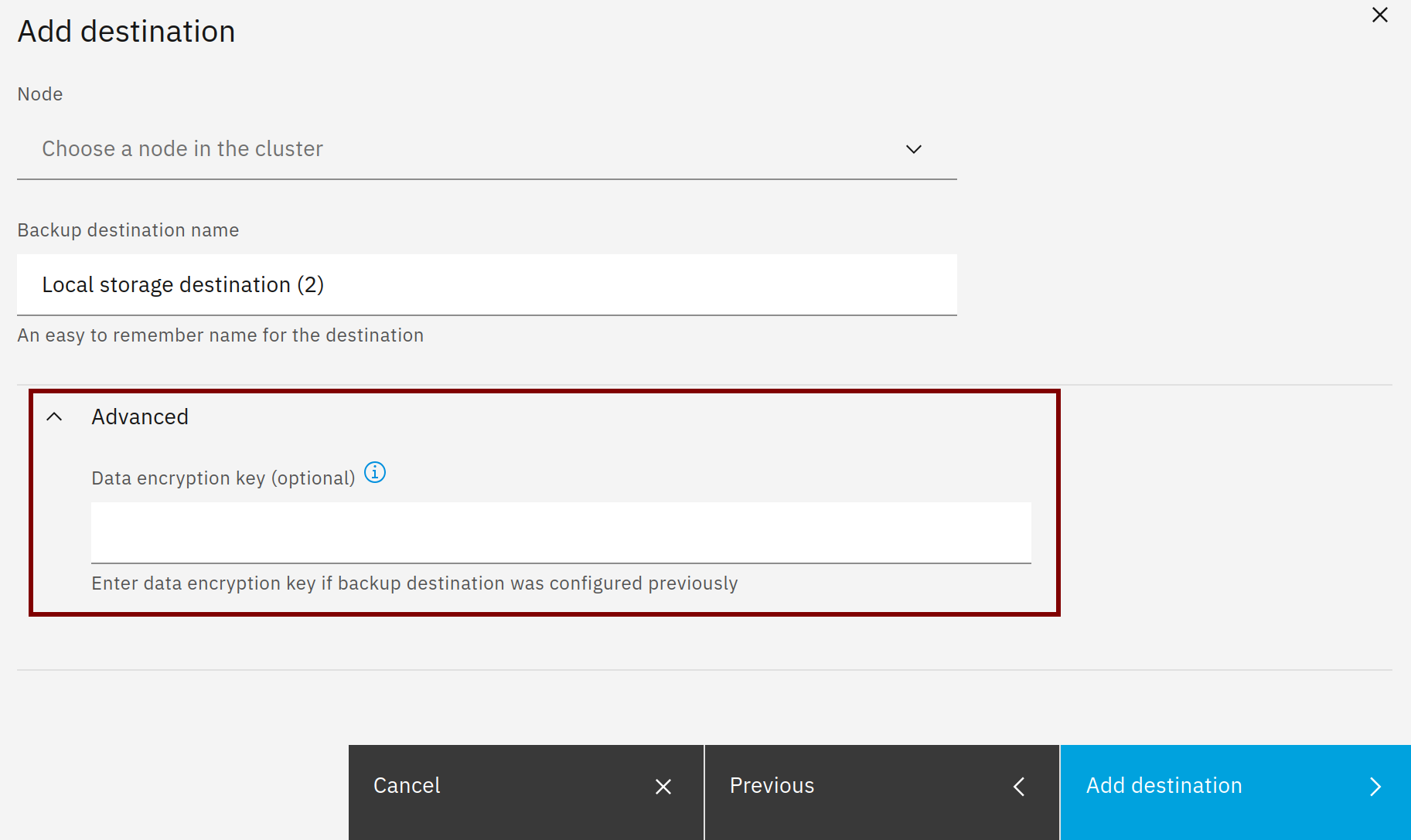

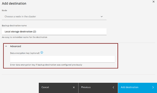

The backup is encrypted with a key.
To get the key from the old backup, go to the backup destination details:
and show the data encryption key.
It should be used when setting up the new backup destination:
This could be due to changing leader node, see also System logs — NS8 documentation

To remove an inactive instance, select the three-dots menu and choose the Uninstall action.
we read this too, but we can’t see the 3-dots-menu … where is it ?

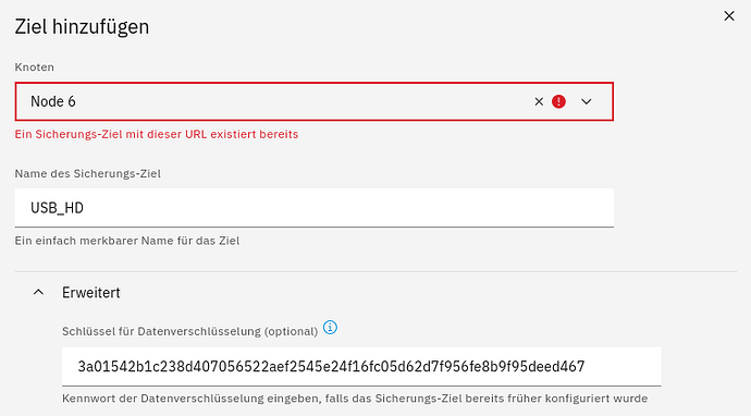

Backup to USB-HD

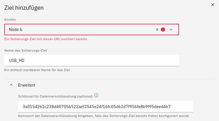

we do, like you wrote, but there is a new error
Sorry, but there is no way to see … Should we remove all backup destinations first ?
→→ the USB-HD is clean, fresh ext4 formated and then the long way to join to rclone-webdav …

It’s in “settings/system logs”:
At least you need to remove the local backup destination as just one local backup is allowed.
I think backup to NAS is implemented in a good way by using a Samba share.
I agree that the local backup is tricky as manual steps on CLI are needed.

Yes, of course. Now is NS8 in green LAN and we could backup to SMB-NAS. The backup to USB-HD is too tricky to handle. This was one reason to moving NS8.
Second problem - lokies 3-dot-menu we seeked in software→core. Now we found it and cleaned the system.
