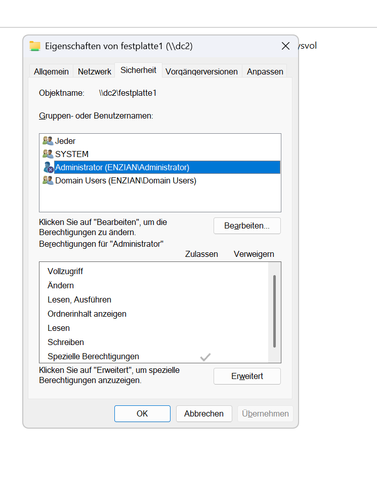

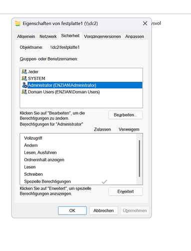

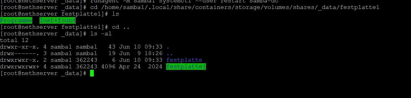

I have changed the permissions to ‘Owner Samba1’ group domainuser". The Samba restart works, but can no longer be clicked on the shares - open.
It is probably due to the authorisations. I enclose a picture.

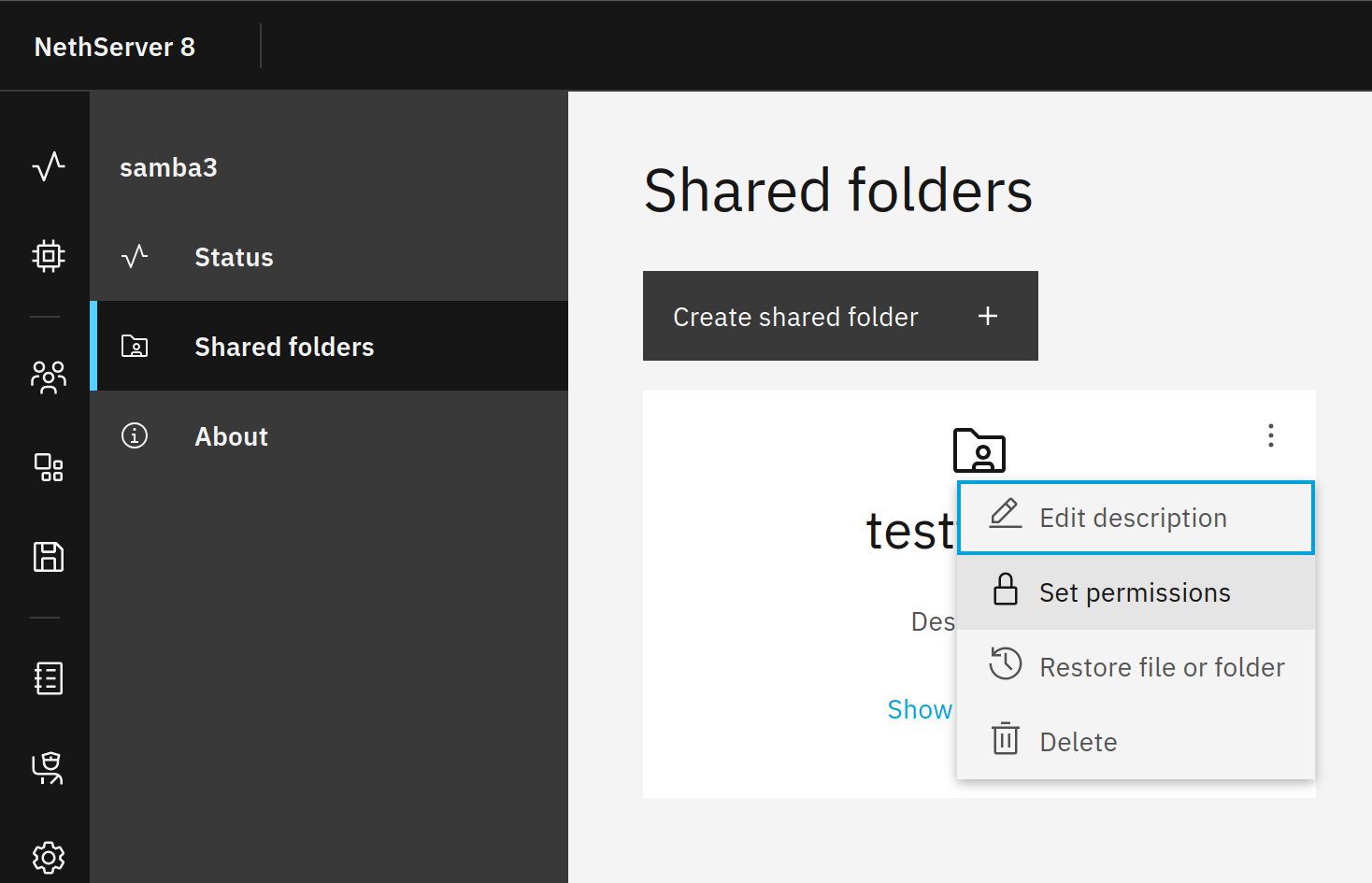

Did you try to (re)set the permissions of the share, see File server — NS8 documentation
Be careful as setting the permissions may cause wrong permissions when plugged into another machine.
