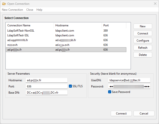

Sorry, I didn’t express myself clearly. I use Samba Active Directory to manage users, not LDAP. Port 636 is open on the firewall.
With a Windows client on the network, I can connect.

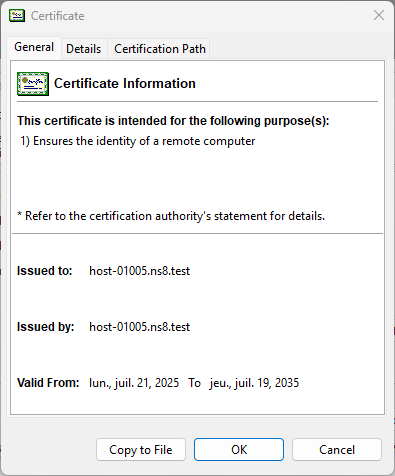

I consistently receive a certificate error even though NS has a valid Let’s Encrypt certificate.
certificate
After acceptance, I can connect to the server.
The connection from pfsense is systematically refused.
Certificate .ns8.test is the default self-signed one. pfSense cannot validate it because the issuing CA is not trusted, so TLS verification fails. You can either obtain a certificate from a public CA, or set up your own CA, generate a certificate for NS8 signed by it, and add the CA certificate to pfSense trusted CAs.
In any case, the server name of Samba DC, used to connect to NS8, must be present in the certificate Subject Alternative Name (SAN) (CN alone may not be sufficient). The server name must be the one of Samba DC, e.g. dc1.ad.example.org.
Finally, to pass the TLS certificate upload validator, the custom CA must be trusted by the node OS TLS trust store, as explained here: TLS certificates — NS8 documentation

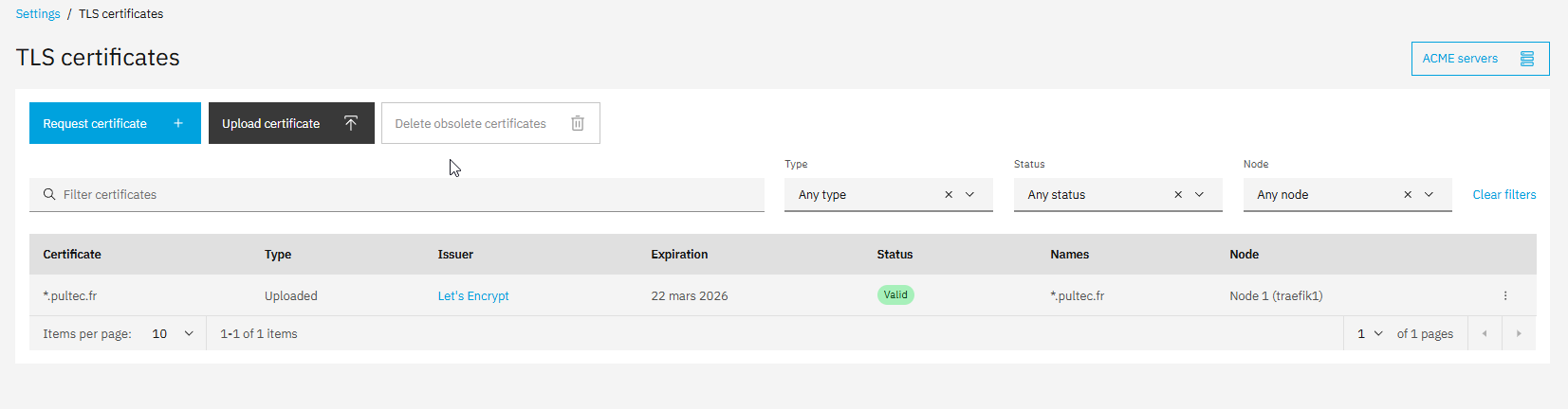

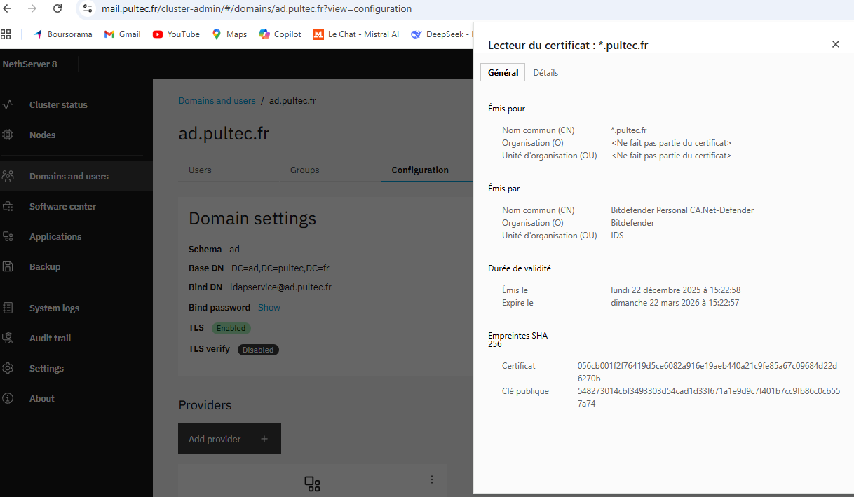

I have a Letsencrypt certificat
for the NS8 console and mail this is Ok
but not for the AD , i have make a test with dc3r1.ad.****.fr , i have the same certificate error with the windows client .
That wildcard certificate does not match multi-level domain names like dc3.ad.example.com. I’m sorry — since you have an internal domain name, using a custom CA is the best way to go. This is a typical pain point in AD environments.
