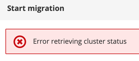

I had an email migration that failed badly and I thought it would be a great idea to remove a possibly “bogus node” to get things back on track, as described here : Release notes — NS8 documentation
It was a bad idea : I can’t restart the migration
I can’t disconnect from the cluster either because “Some apps have already been migrated: it is not possible to disconnect at this point.”
I felt in a loophole. Any idea how to get out of this ?
Txs
