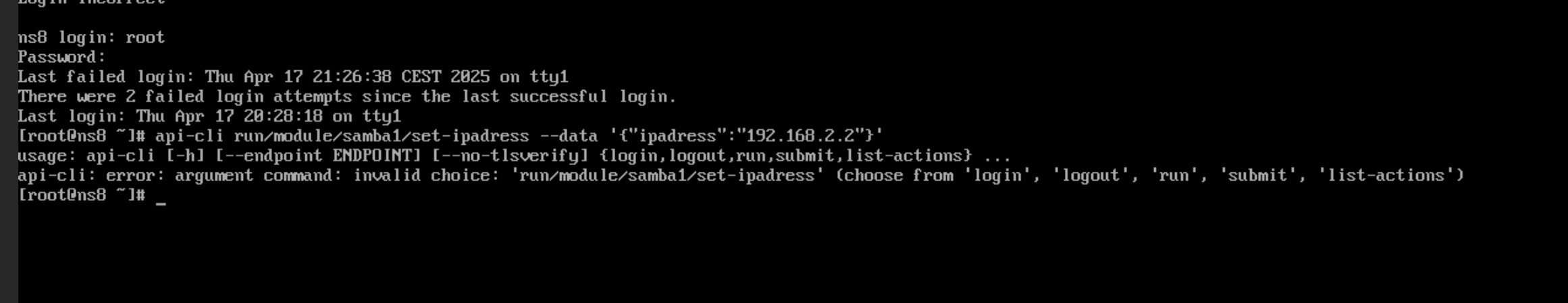

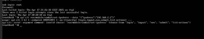

i did an error, at the end of the migration it ask about the ip for the domain controller, i choose the ip of the formerly but at this time the ns8 had a different ip, guess i have to do it once again… or is there a chance to get it run?
Yes, you can set the samba IP, see also NethServer 7 migration — NS8 documentation
api-cli run module/samba1/set-ipaddress --data '{"ipaddress":"192.168.1.123"}'
something went wrong
got it, thank you, will see if it works :smiley:
