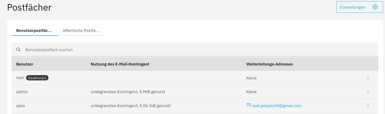

After migration my LDAP user mail was successfully moved to the new server:
mailbox intern: “apos”

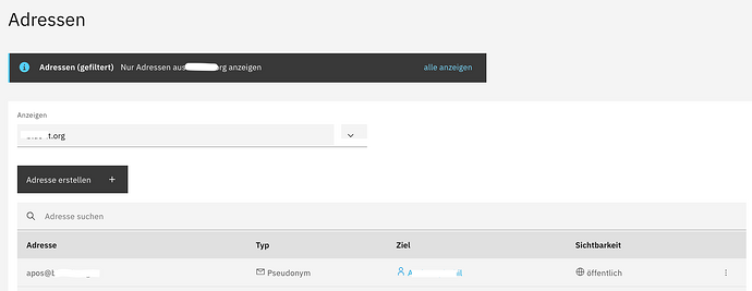

The adresses show a “Pseudonym” with my mail

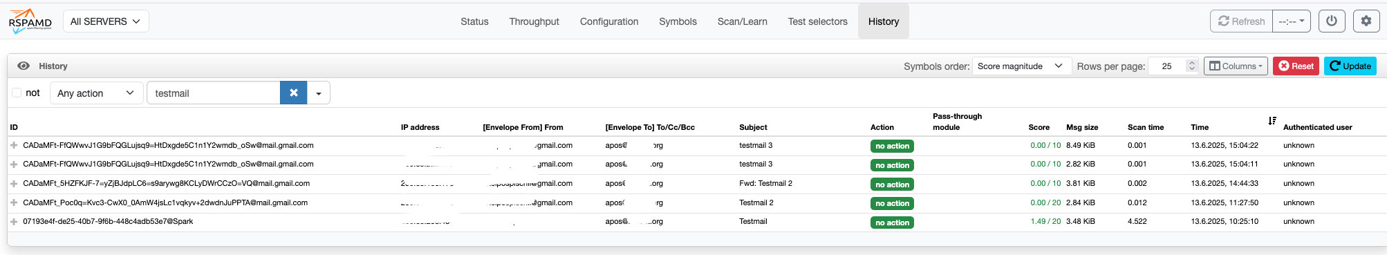

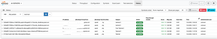

I can see Mails come in (here Testmail):

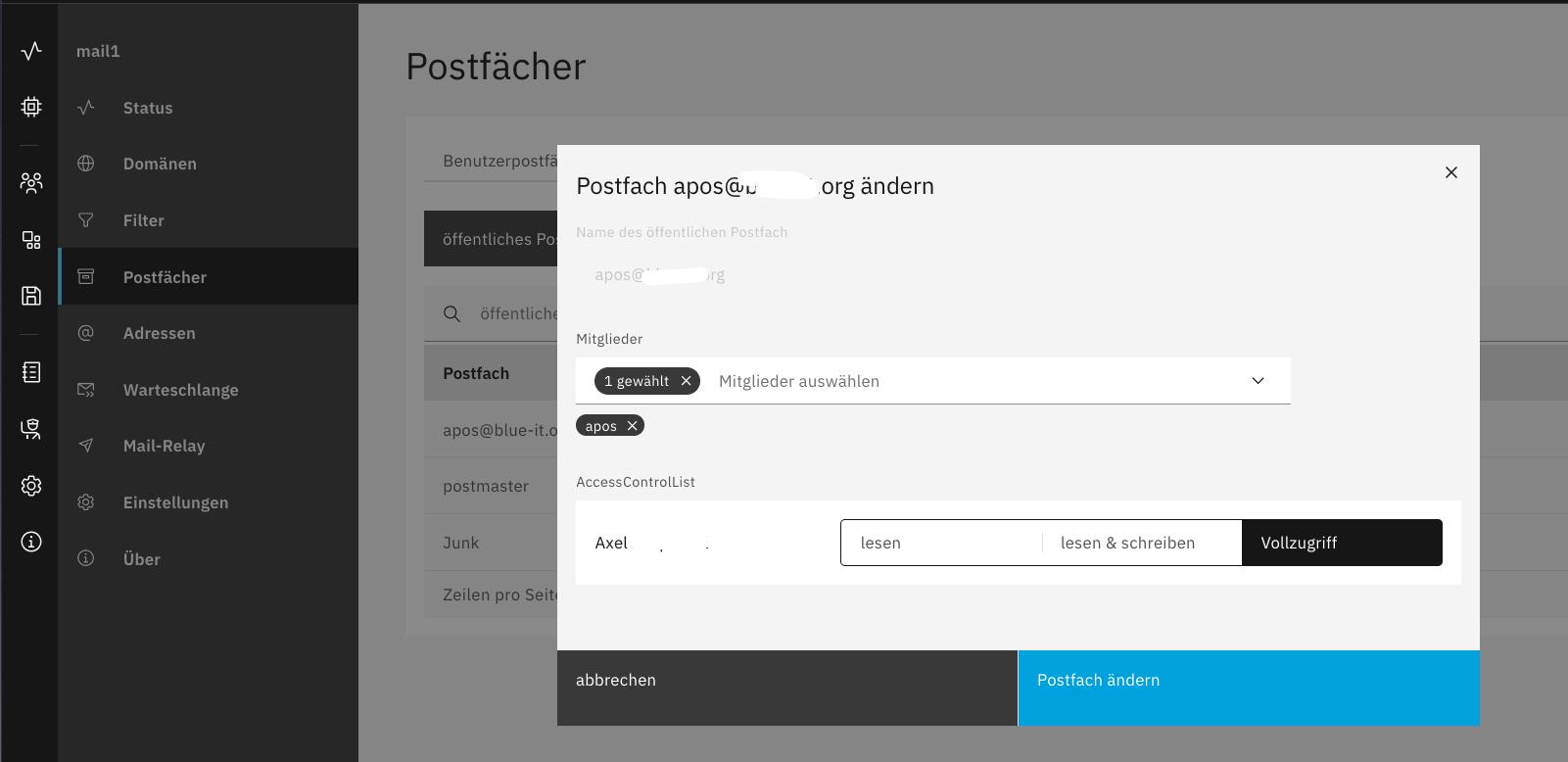

I temporarily additionally added a public mailbox with full acccess rights, with is connected to the “apos” internal account.

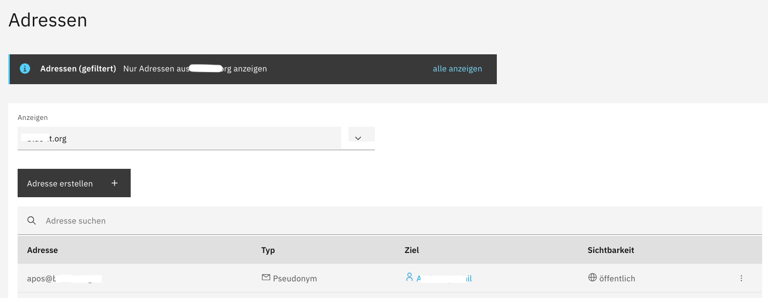

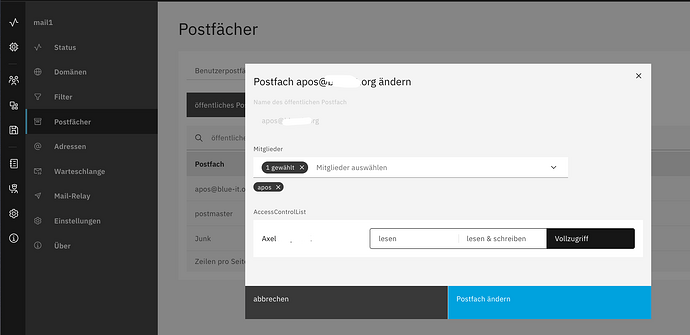

I think, I could solve the problem with:
  1. the instantiation of the public (!) mailbox, which had not been there after the migration of user apos@mydomain.org

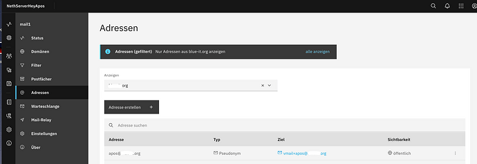

    → last screenshot from last postlast screenshot → vmail+apos@…
  2. giving it full access rights (which is not default)
  3. Connected the “Pseudonym” in "Adress in mydomain.org (apos@mydomain.org - Pseudoym) with the target “vmail+apos@mydomain.org”

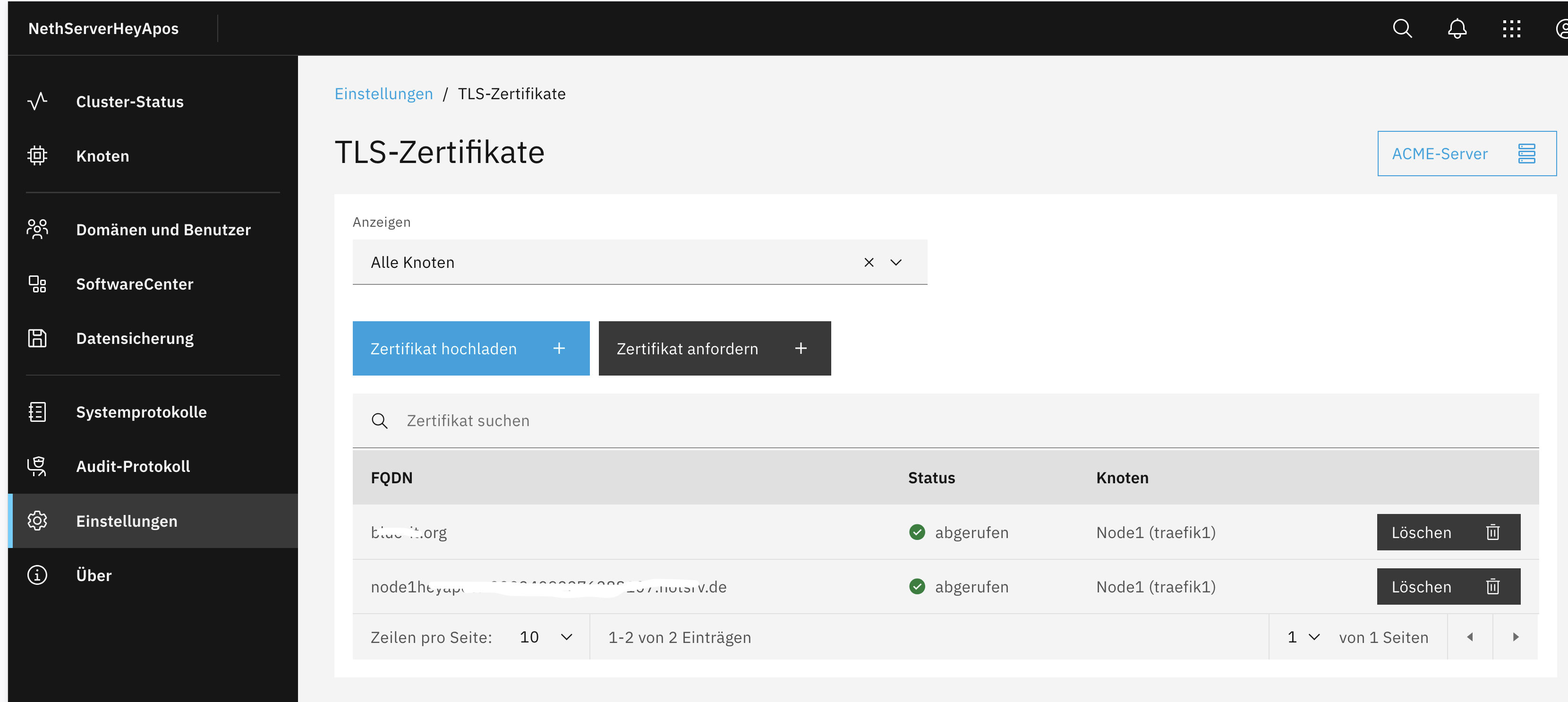

My problem:
I can not delete the old cert (…hotsrv.com) or re-issue for my domain (…org). I get either an error, the domain can not be deleted (… hotsrv.com) or the can not be reissued (…org).

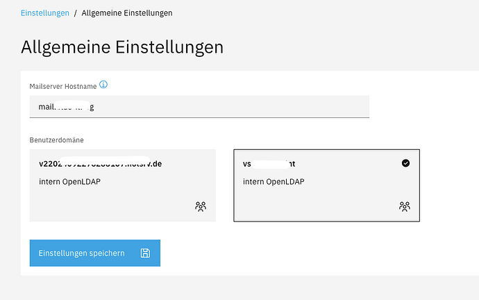

[Partly SOLVED]

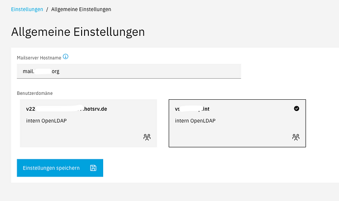

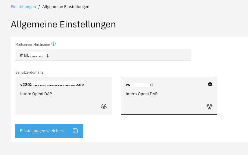

Go to Mail → Settings → Change the mailserver name
But: I can not alter the Intern OpenLDAP Domain Name.
This should be
dc=mydomain, dc.org
Changing the LDAP domain name from the UI isn’t supported yet. If there are not too much users you could remove and recreate the OpenLDAP user domain.
Another way would be to create a domain with the right domain name in the mail app. In that case you may need to configure identities for the mail users to use the right mail address or use lam to edit the LDAP users mail addresses.

There are three different “domains” on my system. The wording for “domain” therefore should be more precise, I think:

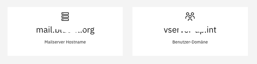

  1. the hostname (which is the Mailservers domain)
    I can change the hostname, but the internal userdomain with the users will remain.

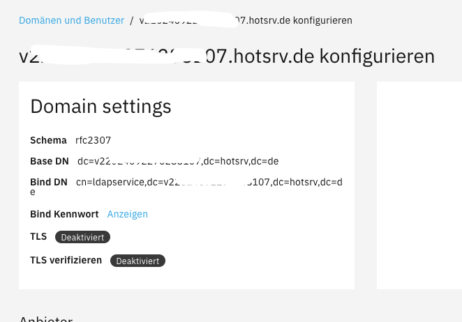

  2. the local domain for my istallation which is NOT the LDAP provided for my users. This OpenLDAP had been created during installation / migration. It contains the administrator account and the Bind DN. Not my users.
  3. the local internal domain (OpenLDAP) which has been migrated from the old system and contains my users (only a handful, so no problem to recreate).
Mail-App Settings:
System → Domain and Users:

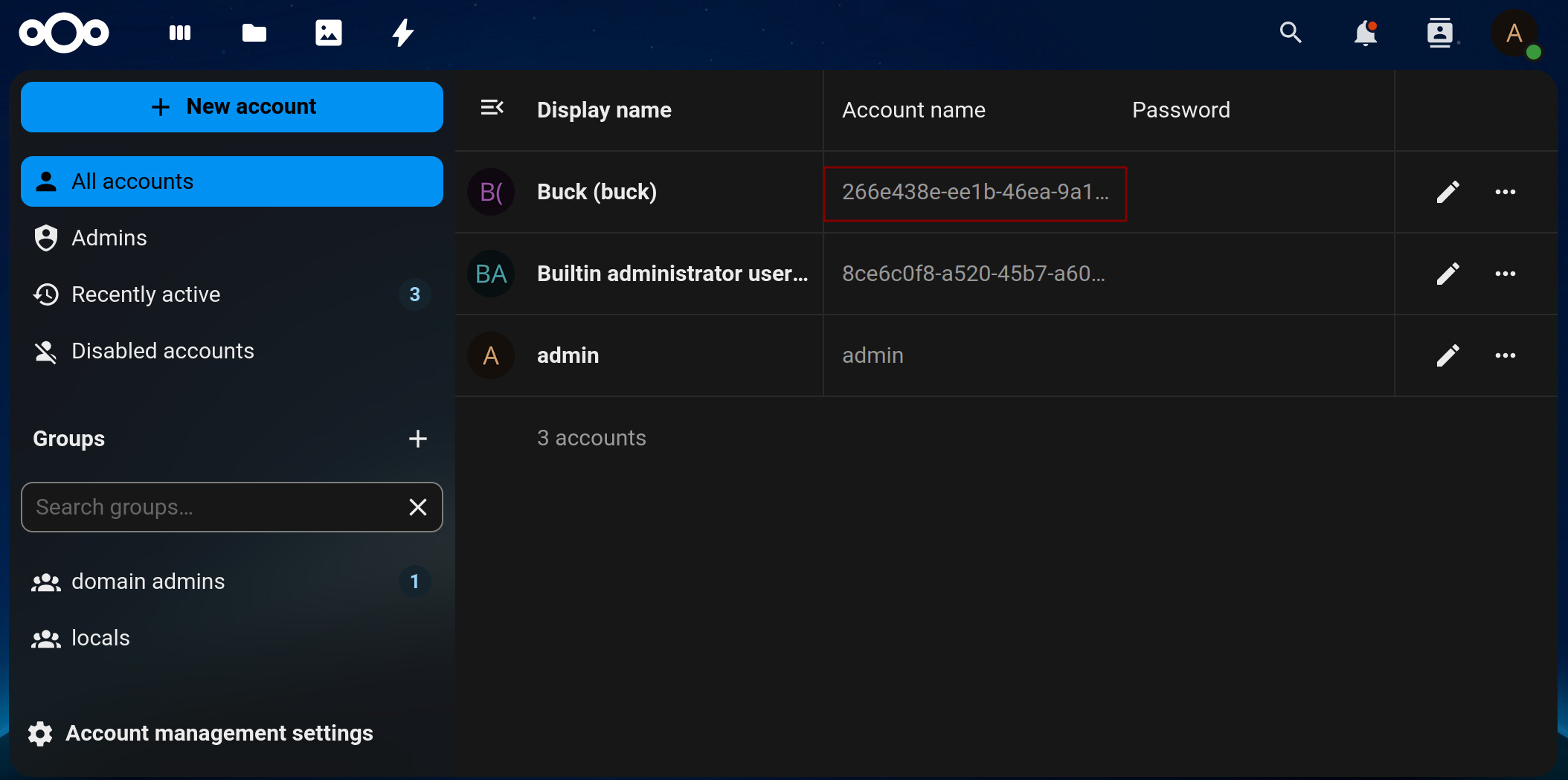

I need to check about Nextcloud as the users are mapped to UUIDs…
SOGo just uses the user domain of the mailserver app.
As regards Nextcloud the files would need to be migrated to the new UUID of the user.
Enter Nextcloud container:
runagent -m nextcloud1 podman exec -ti nextcloud-app sh
Example of listing files of a user:
ls -l data/73fc5571-0027-4c97-b744-eb3df525900c/files/
The UUIDs are shown in the Nextcloud account settings (when logged in as admin):
So you need to get the old UUIDs before removing the LDAP user domain and then copy the files to the new UUID directory.
Finally the files need to be scanned:
runagent -m nextcloud1 occ files:scan --all
I found that there’s an app for importing/exporting users but I never tested: User migration - Apps - App Store - Nextcloud
