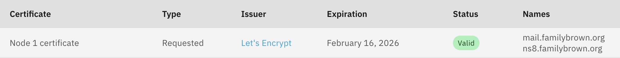

Pretty much what the subject says–my NS8 node certificate appears to have successfully renewed a month ago:
However, my mail server is still serving the old cert, which expired earlier today. Kind a problem that in over a month, it hasn’t reloaded the cert. How can I fix this?

It should be closer to January 16, as the cert would renew 30 days out.

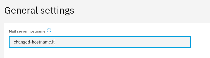

Interesting :thinking: It looks like a UI bug, thank you for pointing it out. However, do not expect Mail server hostname to be a list selector, as it is actually a free text input field. Only its disabled state is wrong: after the dialog is loaded, it should become editable.
EDIT: I was wrong, the field is editable!
This may be a clue. I’d try to reproduce it, thanks!

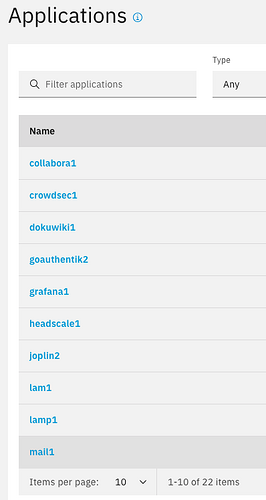

I wasn’t talking about the mail server hostname, but other lists like the TLS certificates:
or Applications:
They’re chunked by default at 10 items/page, that default can’t be edited, and changes (e.g., selecting 25/page) don’t persist to the next time you browse to that list.
