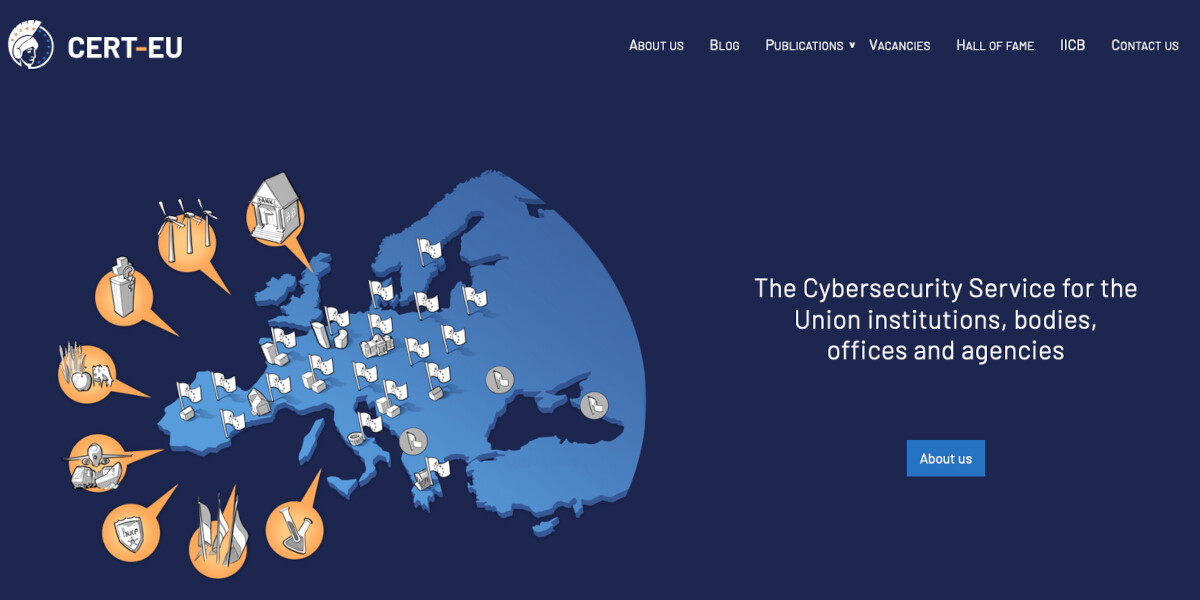

According to Cert.EU
Temporary Mitigation
Disable the algif_aead kernel module persistently on all affected systems until a patched kernel is available:
echo "install algif_aead /bin/false" > /etc/modprobe.d/disable-algif.conf
rmmod algif_aead 2>/dev/null || true
This workaround does not affect dm-crypt/LUKS, kTLS, IPsec/XFRM, OpenSSL, GnuTLS, NSS, or SSH. It may affect applications explicitly configured to use the afalg engine or that bind aead/skcipher/hash sockets directly. Exposure can be assessed with lsof | grep AF_ALG.
I did not test this workaround and I’m not suggesting nor implying that might be suitable for CentOS7/NS7 in any way.
