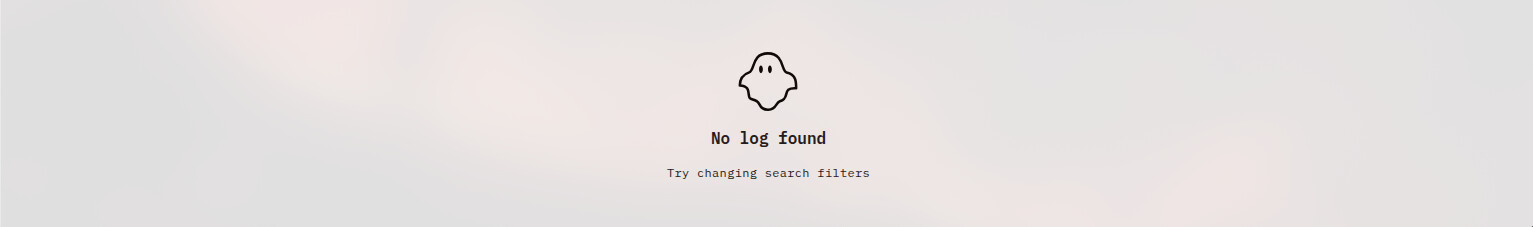

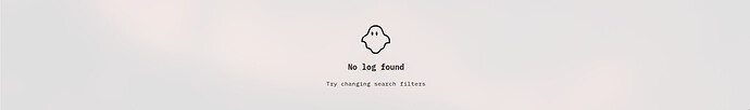

Logs in system logs page are empty
How do ienable logs
