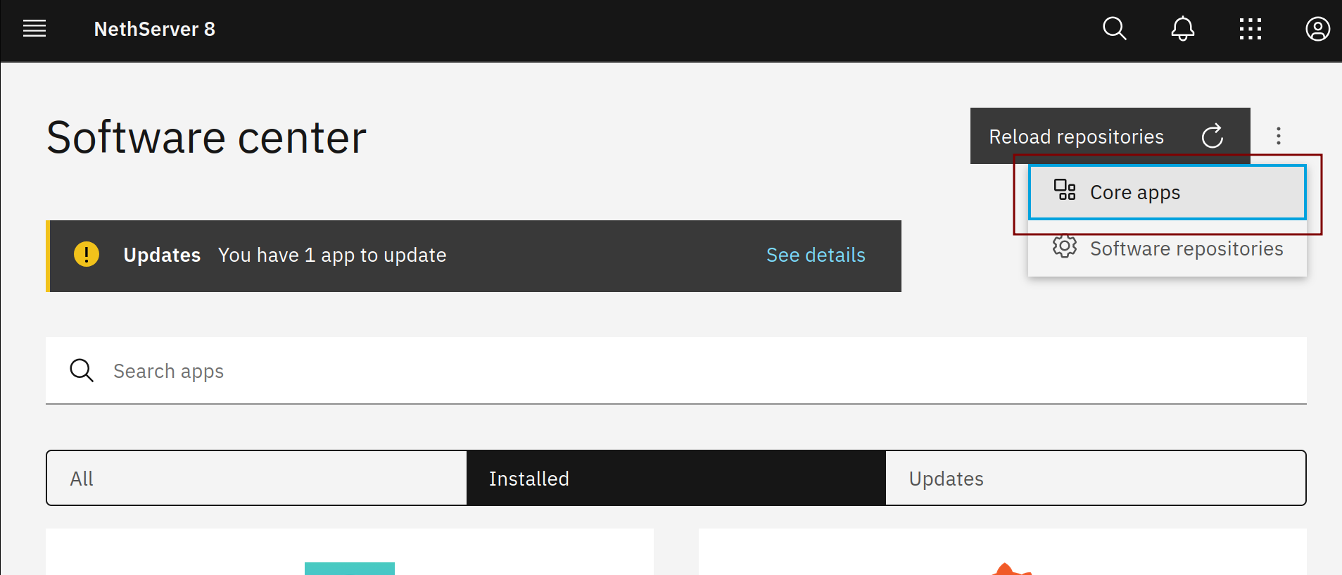

The used version should be listed in the core apps in Software Center, see also Software center — NS8 documentation
i think is is onlay showed by updates etc. if i go on Software-Center i did see the apps like mail but no entry for Traefik.
yeah, tried it, but there is no update wait, there is a second button. okay, the traefik version is 3.02
Software center / core module is the point where you have to look.
