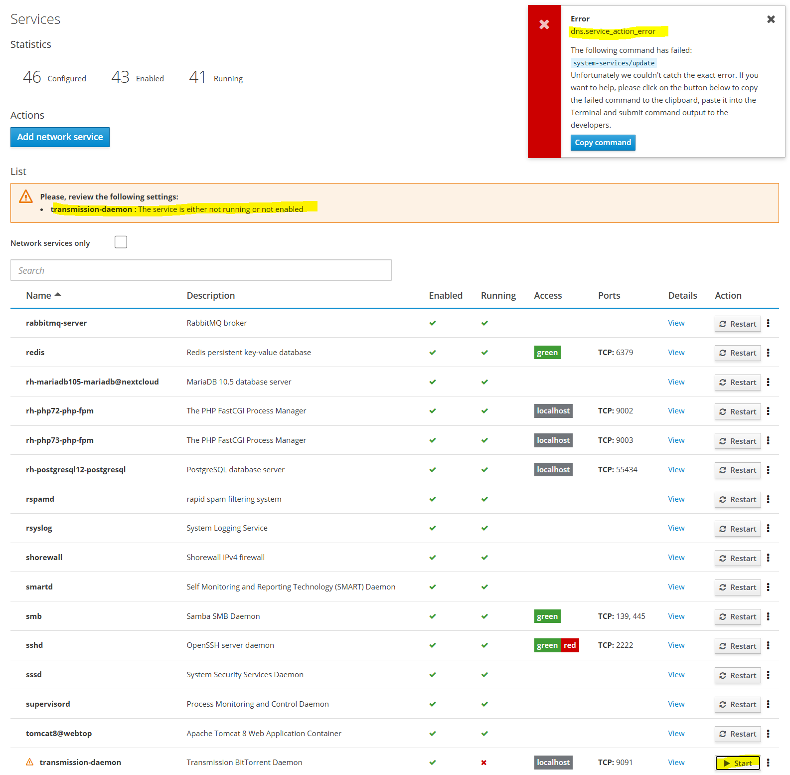

Unable to Start it.

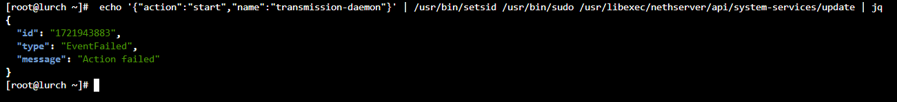

Run the command and get the following.
Any idea what the problem may be and how to fix it.
Thank you for any help.

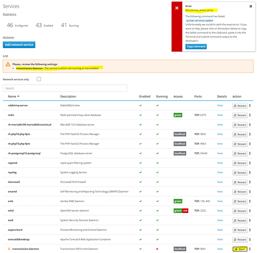

Unable to Start it.

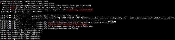

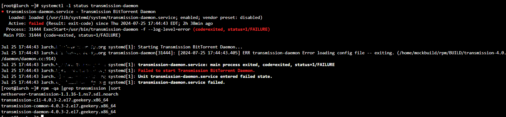

what does the service status say?
systemctl -l status transmission-daemon
…or alike.
And installed transmission packages:
rpm -qa |grep transmission |sort
Error loading config file
after reviewing all folders, including hidden folders. settings.json in .config folder had 0 bytes. copied settings.json from /var/lib/transmission folder to the .config folder. able to start transmission. any idea why the settings.json foound in .config folder was 0 bytes?
