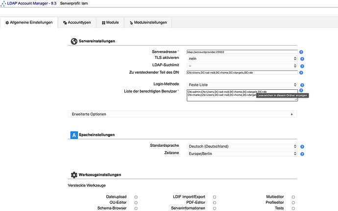

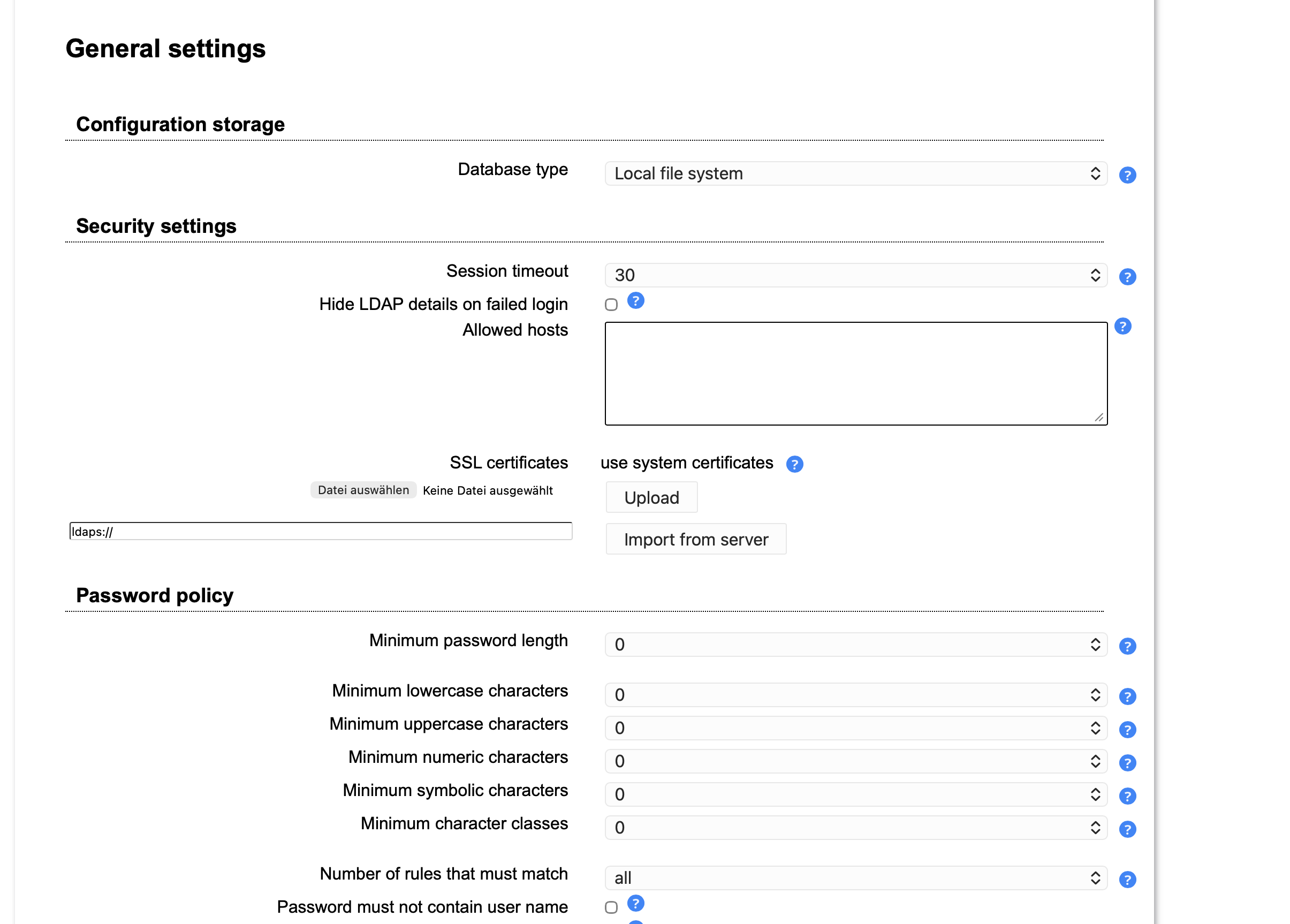

LAM-Update buggy

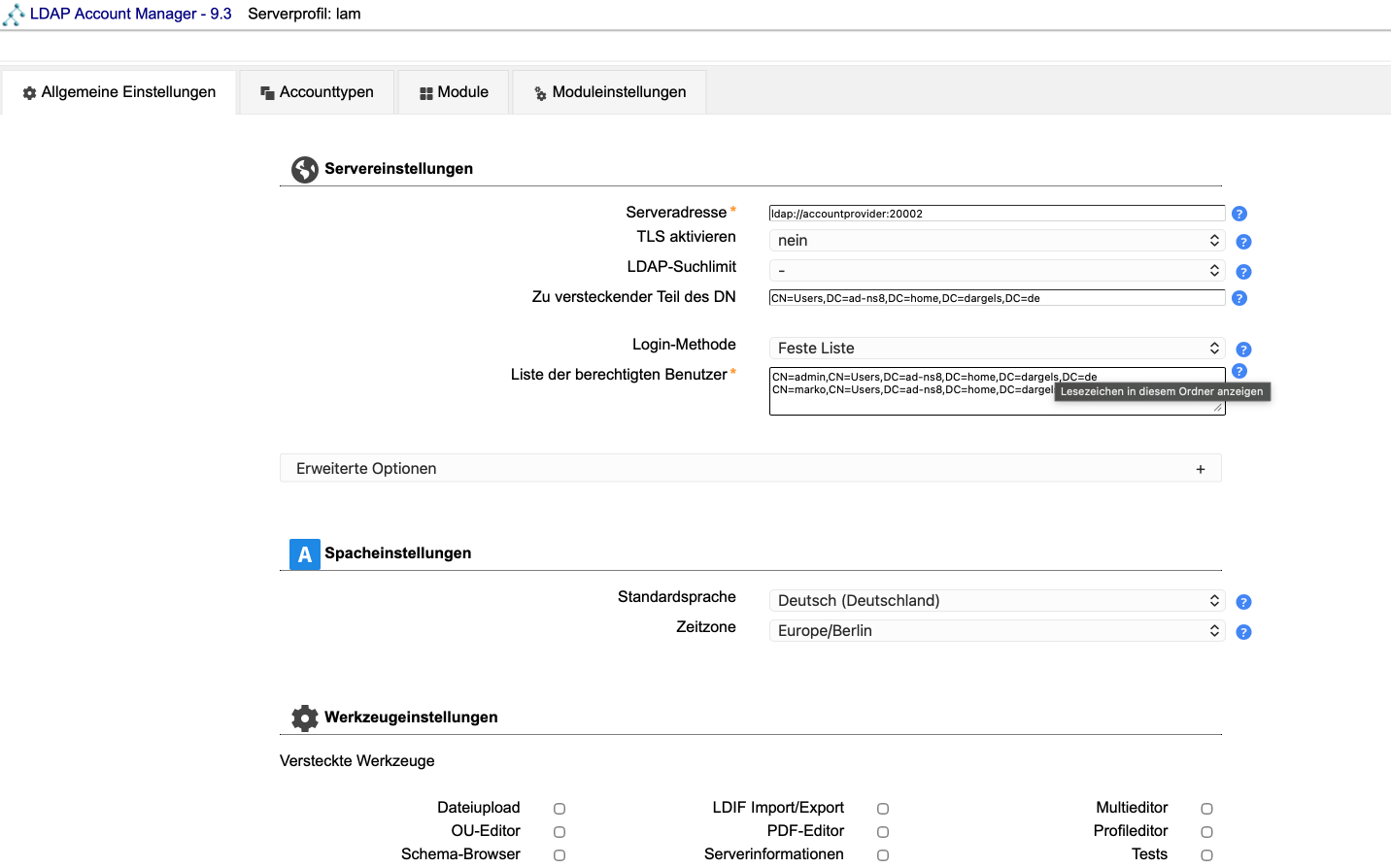

before update

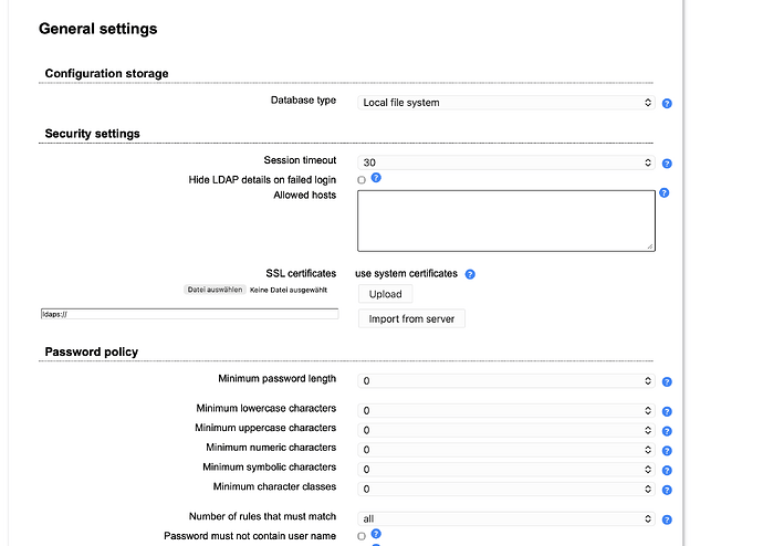

After the update and the new password – the only usable/loaded configuration page

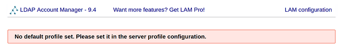

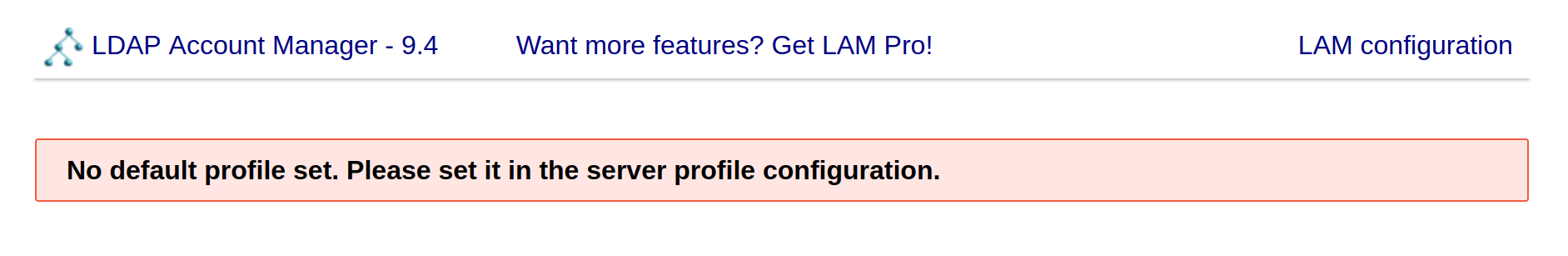

After logging out and logging in, the new password cannot be used.
LAM is unsable

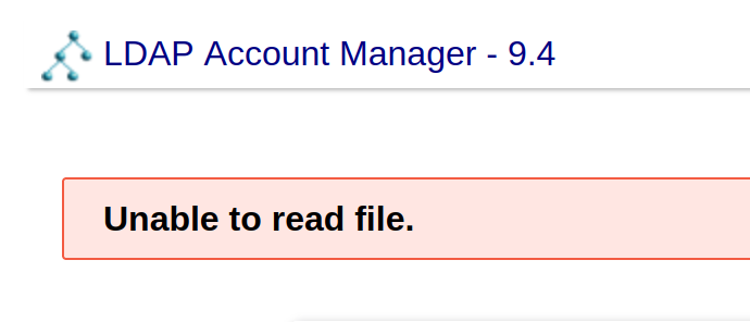

I have the same problem here. You can change the password, but when you try to log in with it, it is not accepted. I get the message “No default profile set. Please set it in the server profile configuration.” But that doesn’t work because the previously created password doesn’t work. I am currently using version 1.1.4.
I think the issue is that they changed the config file to JSON and starting with version 9.4 (included in the last 1.1.4 app update) it’s required.
From Release LAM 9.4 with new white pages feature and email2SMS support (both LAM Pro) · LDAPAccountManager/lam · GitHub :
Main configuration and server profiles require latest file format (introduced in 9.0) (389)
The old config file can’t be read anymore.
After an update from 1.1.3 to 1.1.4 it’s working until the app is reconfigured and the ldap config file is rewritten in the old config file style.
A fresh 1.1.4 install didn’t work anymore. It asks for setting a new password but then it fails:
After saving the correct json config file lam.conf from version 1.1.3 and put it to 1.1.4 I was able to login again but after reconfiguring the lam app and changing domain it’s broken again.
The following file lam.conf needs to be in json now and I guess the config.cfg file too:

Maybe it’s enough to change the config templates to new ones…

I already opened a pull request but GitHub didn’t create a package to test which would have been the simplest method.
You could downgrade to the previous version of LAM using following command. This command uses the force option which shouldn’t be used for conventional updates. After the downgrade you need to reconfigure the app. (Click save in NS8 app settings)
api-cli run update-module --data '{"module_url":"ghcr.io/stephdl/lam:1.1.3","instances":["lam1"],"force":true}'
or you could manually change the template files to check if it works:

            "SSHA"
    "toolSettings": {
        "treeViewSuffix": "${LDAP_BASE}",
        "tool_hide_toolFileUpload": "false",
        "tool_hide_ImportExport": "false",
        "tool_hide_toolMultiEdit": "false",
        "tool_hide_toolOUEditor": "false",
        "tool_hide_toolPDFEditor": "false",
        "tool_hide_toolProfileEditor": "false",
        "tool_hide_toolSchemaBrowser": "false",
        "tool_hide_toolServerInformation": "false",
        "tool_hide_toolTests": "false",
        "tool_hide_TreeViewTool": "false",
        "tool_hide_toolWebauthn": "false"
    "jobSettings": []
../templates/config.cfg.tmpl
    "password": "{SSHA}og9MdeYRopbiWGb+jY+q58rZcIk= Nn87oA==",
    "default": "lam",
    "sessionTimeout": "30",
    "hideLoginErrorDetails": "false",
    "logLevel": "4",
    "logDestination": "SYSLOG",
    "allowedHosts": "",
    "passwordMinLength": "0",
    "passwordMinUpper": "0",
    "passwordMinLower": "0",
    "passwordMinNumeric": "0",
    "passwordMinClasses": "0",
    "passwordMinSymbol": "0",
    "checkedRulesCount": "-1",
    "passwordMustNotContainUser": "false",
    "passwordMustNotContain3Chars": "false",
    "externalPwdCheckUrl": "",
    "errorReporting": "default",
    "allowedHostsSelfService": "",
    "license": "",
    "licenseEmailFrom": "",
    "licenseEmailTo": "",
    "licenseWarningType": "",
    "licenseEmailDateSent": "",
    "mailServer": "",
    "mailUser": "",
    "mailPassword": "",
    "mailEncryption": "",
    "mailAttribute": "mail",
    "mailBackupAttribute": "passwordselfresetbackupmail",
    "configDatabaseType": "files",
    "configDatabaseServer": "",
    "configDatabasePort": "",
    "configDatabaseName": "",
    "configDatabaseUser": "",
    "configDatabasePassword": "",
    "configDatabaseSSLCA": "",
    "moduleSettings": "W10=",
    "smsProvider": "",
    "smsApiKey": "",
    "smsToken": "",
    "smsAccountId": "",
    "smsRegion": "",
    "smsFrom": "",
    "smsAttributes": "mobileTelephoneNumber;mobile",
    "smsDefaultCountryPrefix": ""
…and reconfigure the app.
