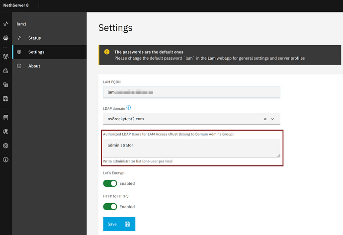

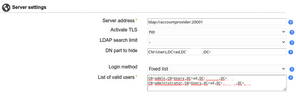

Originally, these were the parameters I set before the update:

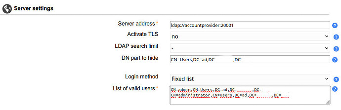

After the update, this is what it looked like:
The problem is that the Server address changes (from ldap://accountprovider:20001 to ldap://ldap:389) and the admin user set under List of valid users disappears, leaving only the default administrator user, which has no password set by default…

It’s intended to edit the admin users in the NS8 LAM settings. If you edit it directly in LAM it may be overwritten when LAM is reconfigured.

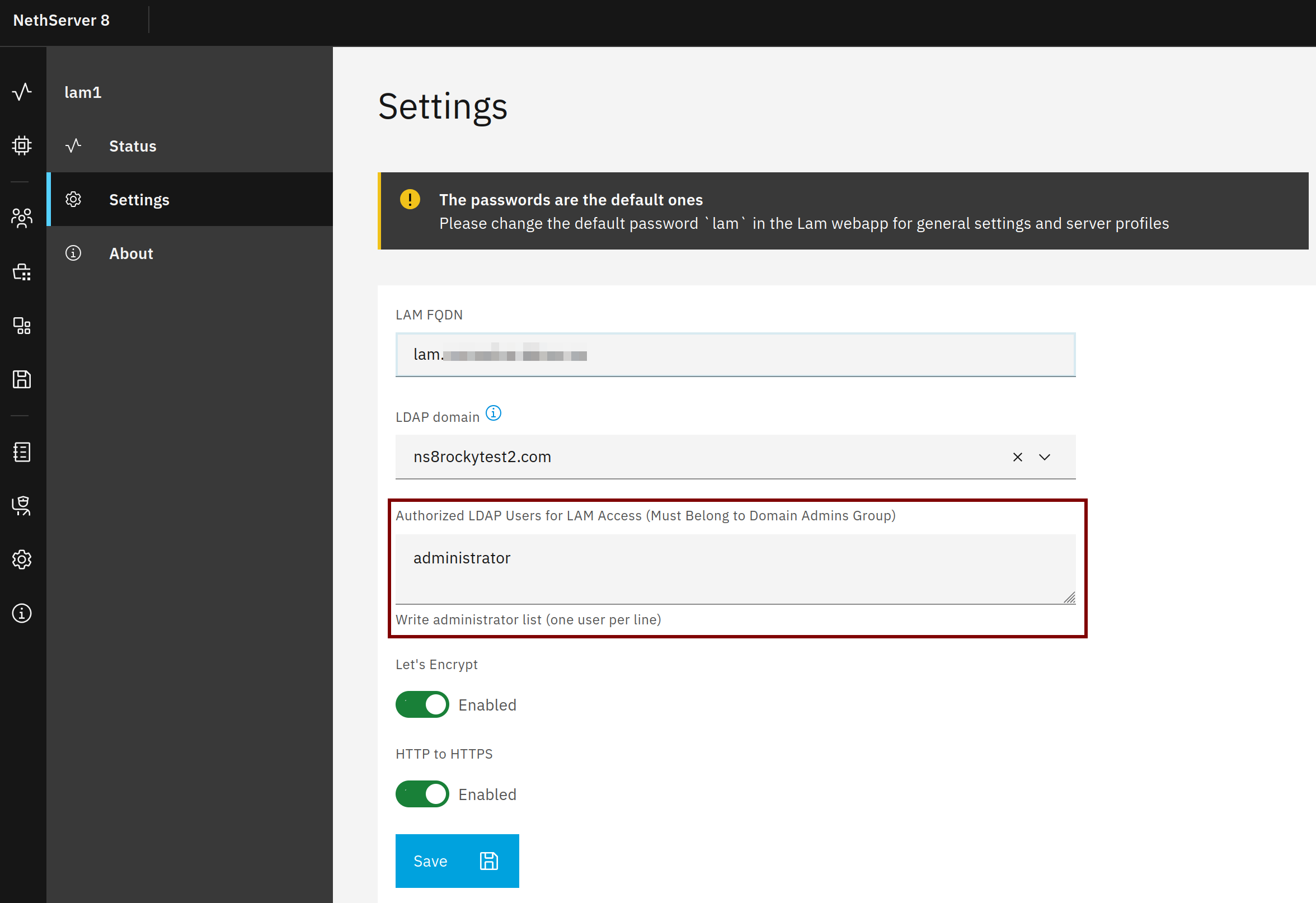

This is an ongoing problem. I have described in detail what happened and how the settings changed after the NS8 Core Samba update. After the update, users were unable to log in to SOGo.
After I restored the settings before the update, users were able to log in to SOGo again. I have attached a picture of everything.

After logging in, I saw that the settings had indeed changed after the Samba update. I have attached a picture of the settings I made previously and the ones that changed after the update.
If I configure the changes in LAM after the update, users cannot log in to SOGo and LAM can only be logged in with the lam password… Set the ldap://ldap:389 route under Server Address in LAM and you will see… The other details can also be tested…
I don’t understand why the Server Address path changes, the user added under the List of valid users is deleted, and the password set for the lam user is reset to the default during the Samba update. Someone explain this.
You are changing the server profile in LAM itself but when the ns8-lam app is configured, it recreates the server profile for LAM and therefore overwrites your changes and users. This could occur on updates or domain changes too.
