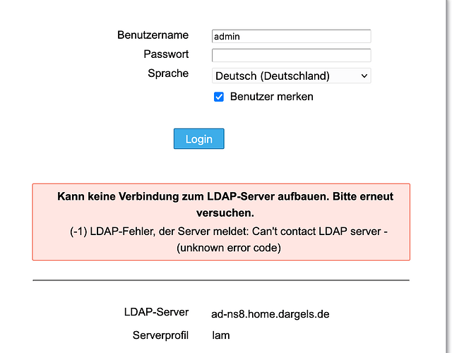

LAM cannot connect to Server

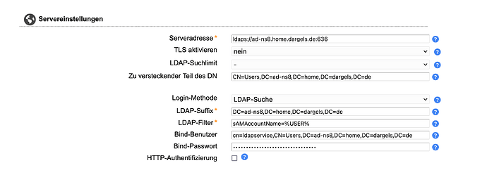

Hello, I try to use LAM-Server.
I configuerd LAM within the settinges, with the well provided AD-Server.
But I cannot connect to.
The default set profile is
The server adress seems to be wrong and I change it to:
The same error occures.

What is going wrong here?
Sincerly, Marko
dns not resolvable ?
do you have several nodes, do your account provider is the AD of NethServer
please explain the context
it is… the same host
yep but a container even on the same host needs to resolve a dns name

There is a separate DNS server, the AD is internally resolveable.
LAM shows the AD in the dropdown, so no choice here…
[root@R1 ~]# ping ad-ns8.home.dargels.de
PING vpn.dargels.de (93.244.31.132) 56(84) bytes of data.
not resolvable from me
I wrote and meant internally.
workable here without issue, on your host what is the result of the command I sent
or you could have an issue from the ldapproxy, this is the configuration I have
does the ldapproxy is running ?

you should remove the lam and try again, for sure you have to let the ldapproxy port in the lam configuration
you can also catch the log error more accurately when you have the error in the UI
journalctl -f _UID=$(id -u lam1)
I installed new.
The same wrong defaults
  • …not the port of the LDAP-Proxy - 20000.
  • server “ldap” is also wrong
    If I change it to the right: same error as before

the server url is hardcoded, I do not understand how you can have ldap://ldap:389

Why Port 20001? In Traefik is 20000 docemented.
I changed:
same error occurs
