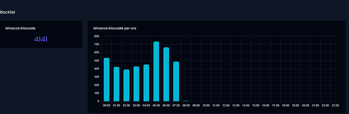

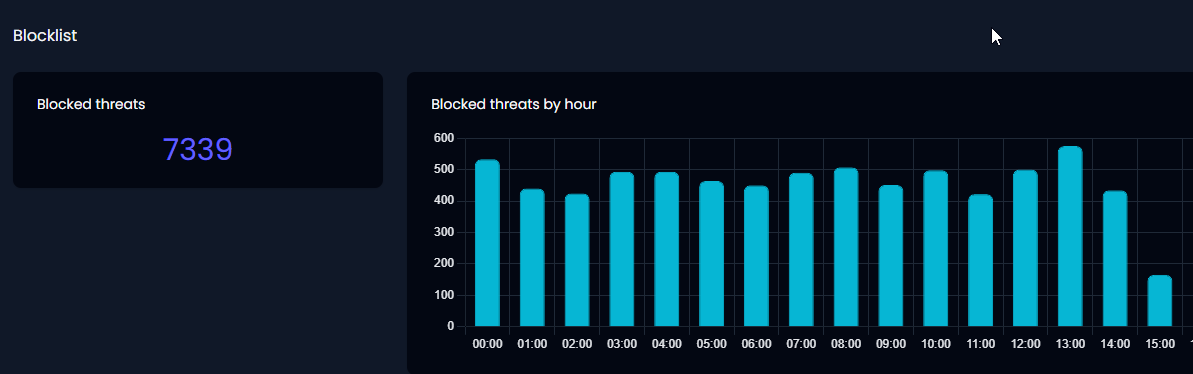

Is IP Shield block reported correctly?

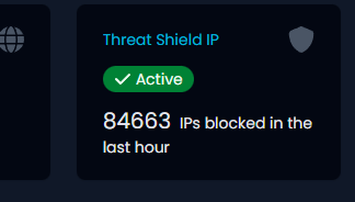

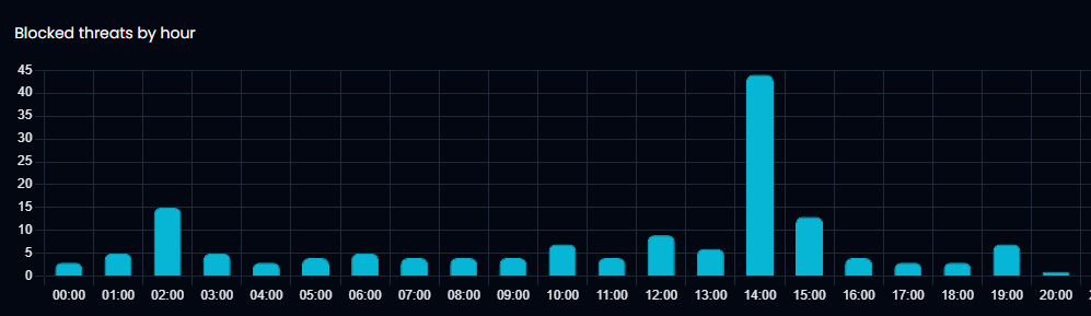

I see a large amount of block in the dashboard, but can not see this in the realtime monitor
I’m not sure, but it looks i appeared after the latest update this week
I can’t reproduce. Here the same count is shown in real time monitor.

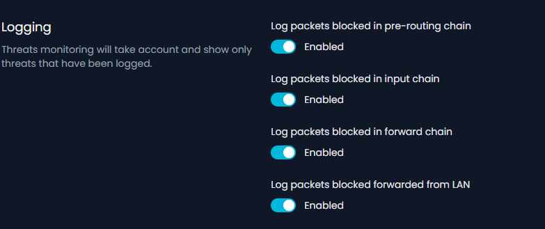

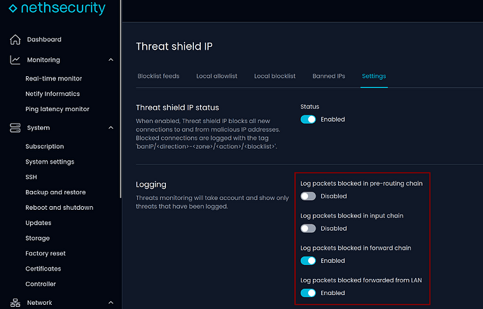

Did you maybe enable logging of all kind of packets in the settings?
The following is the command to get the blocked IPs in the dashboard.
All bans, drops and rejects from the last hour are counted.
grep -e "$(date -d '-1 hour' +'%b %e %H:%M')" -e "$(date  +'%b %e %H:')" /var/log/messages | grep -E 'banIP.+add IP|banIP.+drop|banIP.+reject' | wc -l
Yes.
But the number should then still be the same ?
What is in the realtime monitor should be the same as the dashboard
grep -e “$(date -d ‘-1 hour’ +‘%b %e %H:%M’)” -e “$(date +‘%b %e %H:’)” /var/log/messages | grep -E ‘banIP.+add IP|banIP.+drop|banIP.+reject’ | wc -l
date: invalid date ‘-1 hour’
85039
From the code I think the real time monitor just counts added banned IPs whereas the dashboard also counts logged drops and rejects.
Still strange. I never had these high number in the dashboard

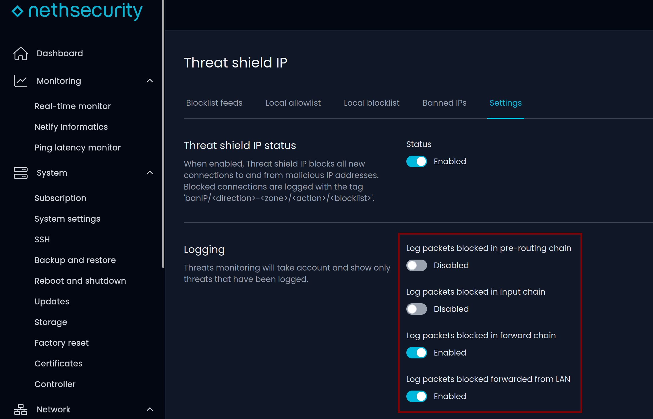

I changed the setting of logging in IP shield
In the relatime monitor i’m now having less logs, but the dashboard remains high
I’m pretty sure this happend after an update last week

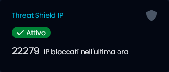

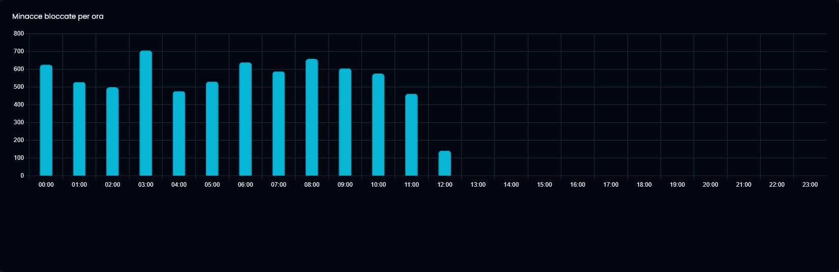

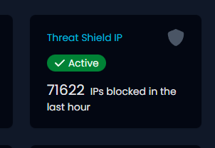

Good morning everyone, I too have noticed a significant increase in blocked IPs on threat shield ip, yesterday I restarted the firewall to try to understand, now it has been active for about 20 hours, and I see that hour by hour the count continues to rise, usually I saw an hourly average between 1000/1500 blocked IPs now we are above 11500 blocked IPs, I have the impression that in the dashboard they are not counted correctly.
Good morning, for an update, these are the values ​​from this morning. As I mentioned in the previous post, the firewall has now been on for 1 day and 15 hours. The value on the dashboard continues to increase.

We haven’t touched BanIP during latest updates, I’ll take a look if these values can be merged together nicely (probably not)
This might not be fixed in the immediate times, but since I’m working on monitoring and such, this can be one of the first things I can put hands on to unify.
Heads up on this, seems that the package that handled date was incorrectly removed, the issue is just visual, the blocking works fine. I’ve updated the issue that @MadPatrick gently provided.
