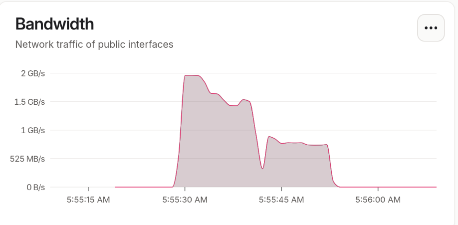

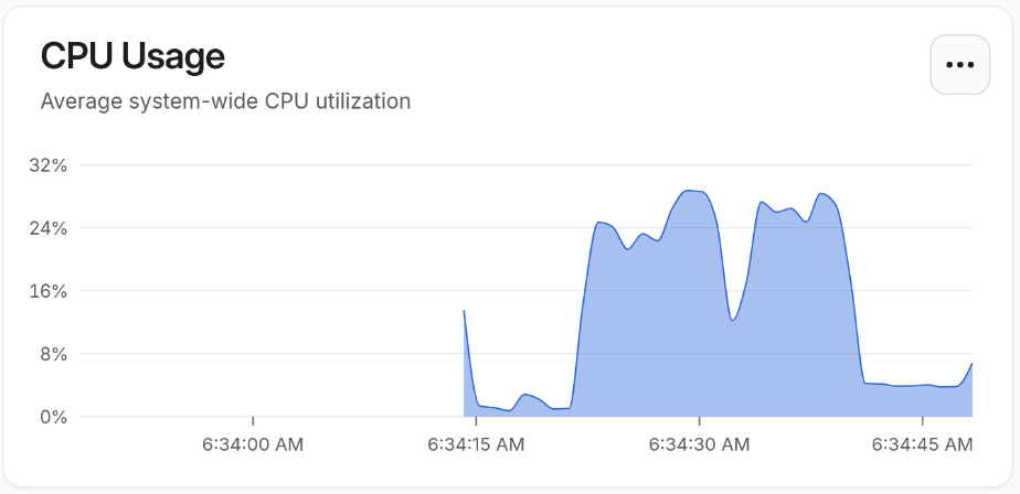

I will try to setup a iperf3 and curl/https server on the WAN side to test the 25G network speed
CPU usage on 24 core NethSecurity VM:
OK

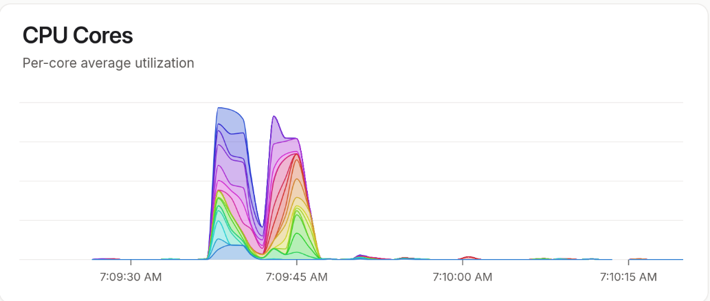

So no difference, only good luck and random results from upstream speedtest servers.
Multiple cpu cores are still used:
Following the IPS/Snort repair, which was silently broken (the Web UI indicate, that everything is fine, see separate topic), the speed dropped to 4.5-5G both directions. Yes: “Fun comes at a cost.”
IRQ balancing and packet steering offer only a minimal benefit with working IPS since performance is limited by a single core hitting 100% utilization/load.
