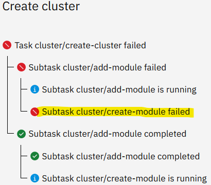

Initial cluster creation failed when adding module
I’ve just installed NethServer 8 using the automated script, but when I try to create the first cluster, the “add-module” task for the Grafana Loki image fails, and I can’t proceed.
This is the generated trace.
cluster/create-cluster
Task ID: 0689abf5-4a21-4726-9e16-0213eb306db3
<7>sed -i '/- 127.0.0.1$/a\ \ \ \ \ \ \ \ - 10.5.4.0/24' /home/traefik1/.config/state/configs/_api.yml
<7>sed -i -e '/cluster-localnode$/c\10.5.4.1 cluster-localnode' /etc/hosts
<7>systemctl stop wg-quick@wg0.service
<7>systemctl start wg-quick@wg0.service
Task cluster/add-module run failed: {'output': '', 'error': '<7>podman-pull-missing ghcr.io/nethserver/loki:1.1.0\nTrying to pull ghcr.io/nethserver/loki:1.1.0...\nGetting image source signatures\nCopying blob sha256:37ad42a8b4872d3b048a3da1cb123239579000777565098fe52749b7a5e4f04d\nCopying config sha256:3ef6544dd0708381fb5db263a83dfa4593194cc73d2635e2f4eaff2b4b61d51b\nWriting manifest to image destination\n3ef6544dd0708381fb5db263a83dfa4593194cc73d2635e2f4eaff2b4b61d51b\n<7>extract-ui ghcr.io/nethserver/loki:1.1.0\nExtracting container filesystem ui to /var/lib/nethserver/cluster/ui/apps/loki1\nui/index.html\nbaadd0b8f8ce20c4425a774b01ae9897a0e4aa084e941fbdf40ed7541eac3b4b\nAssertion failed\n  File "/var/lib/nethserver/cluster/actions/add-module/50update", line 223, in <module>\n    agent.assert_exp(create_module_result[\'exit_code\'] == 0) # Ensure create-module is successful\n', 'exit_code': 2}

I’m not sure, but it seems the main error is:
Assertion failed
  File \"/var/lib/nethserver/cluster/actions/add-module/50update\", line 223, in <module>
    agent.assert_exp(create_module_result['exit_code'] == 0) # Ensure create-module is successful

I can’t figure out why it doesn’t return 0.
Any thoughts on this matter?
