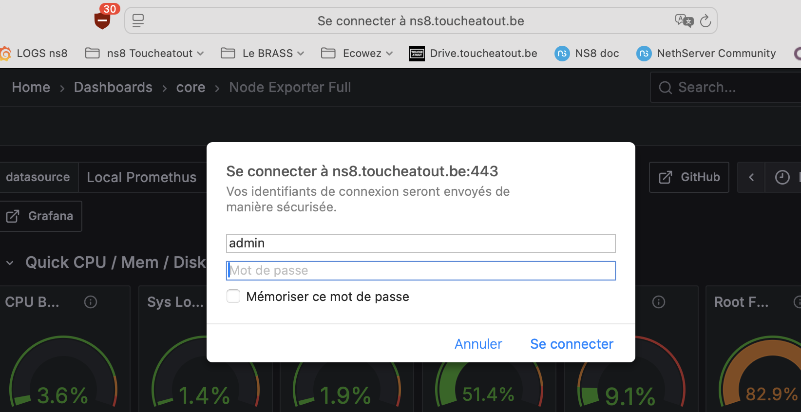

Improve Grafana Access on NS8 by Removing Mandatory HTTP Basic Auth
On NS8 installations, Grafana is currently wrapped behind a Traefik Basic Authentication middleware, which forces browsers to display an HTTP auth popup before reaching Grafana’s own login page. This mechanism brings usability issues: password managers on macOS and other platforms cannot fill the credentials, autofill does not work, and users end up typing passwords manually every time. Worse, this friction often encourages users to fall back on weaker or easy-to-type passwords just to get past the popup.
Allowing administrators to disable this Basic Auth middleware—or disabling it by default—would greatly enhance user experience while keeping access control intact.

The used HTTP basic auth is a way to enable login for the cluster-admin which isn’t an LDAP user.

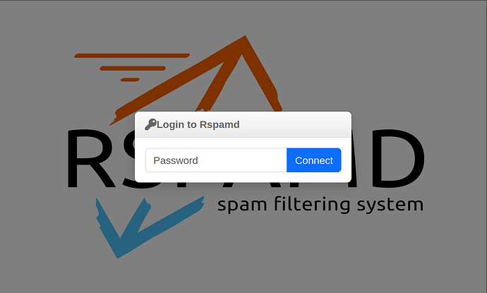

Does it help to remove the HTTP authentication from the traefik config and just use the basic Rspamd password authentication?
Edit the traefik config…
runagent -m traefik1 nano runagent -m traefik1 nano configs/mail1-rspamd.yml
…and comment out following middlewares:
      middlewares:
      - mail1-rspamd-slashredirect
      - mail1-rspamd-stripprefix
#      - mail1-rspamd-auth
#      - mail1-rspamd-headers
Now Rspamd login looks like this…
…and for example 1Password for Mac is able to save the password.
The Rspamd password is saved in rspamd.env:
runagent -m mail1 cat rspamd.env
