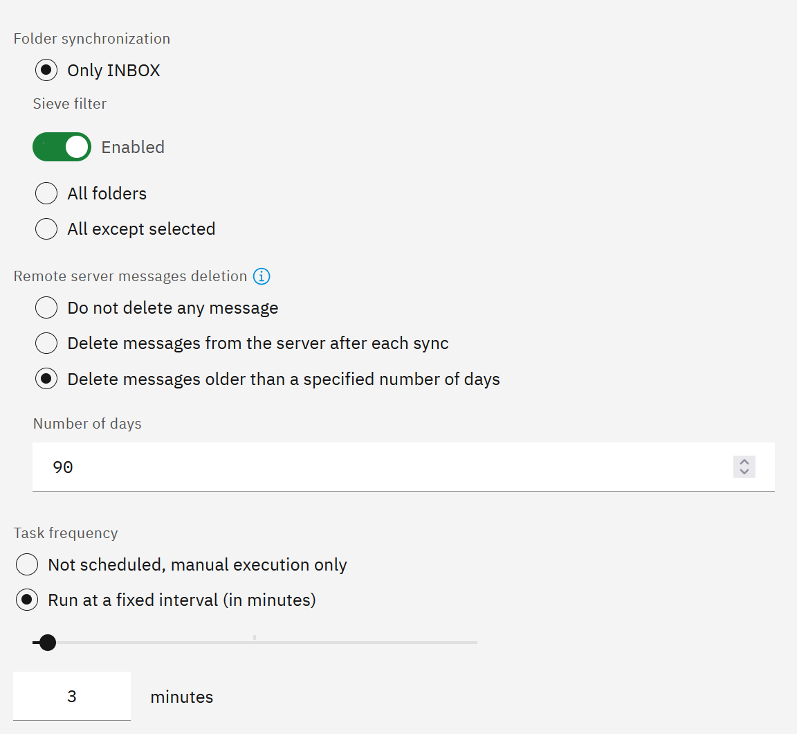

First thing to try
Could you enable FOLDER_INBOX (only inbox) on this task and see if it fixes the behavior? This turns on --search1=UNSEEN --setflag1=Seen --noresyncflags, which matches this use case well: only new unseen messages get synced, they get marked Seen on the source, and flags are never touched again after that.

No, this is another Server, this one si still runing on deb12…
It looks good, pse give me a few days more to get feedback also from the customer…
