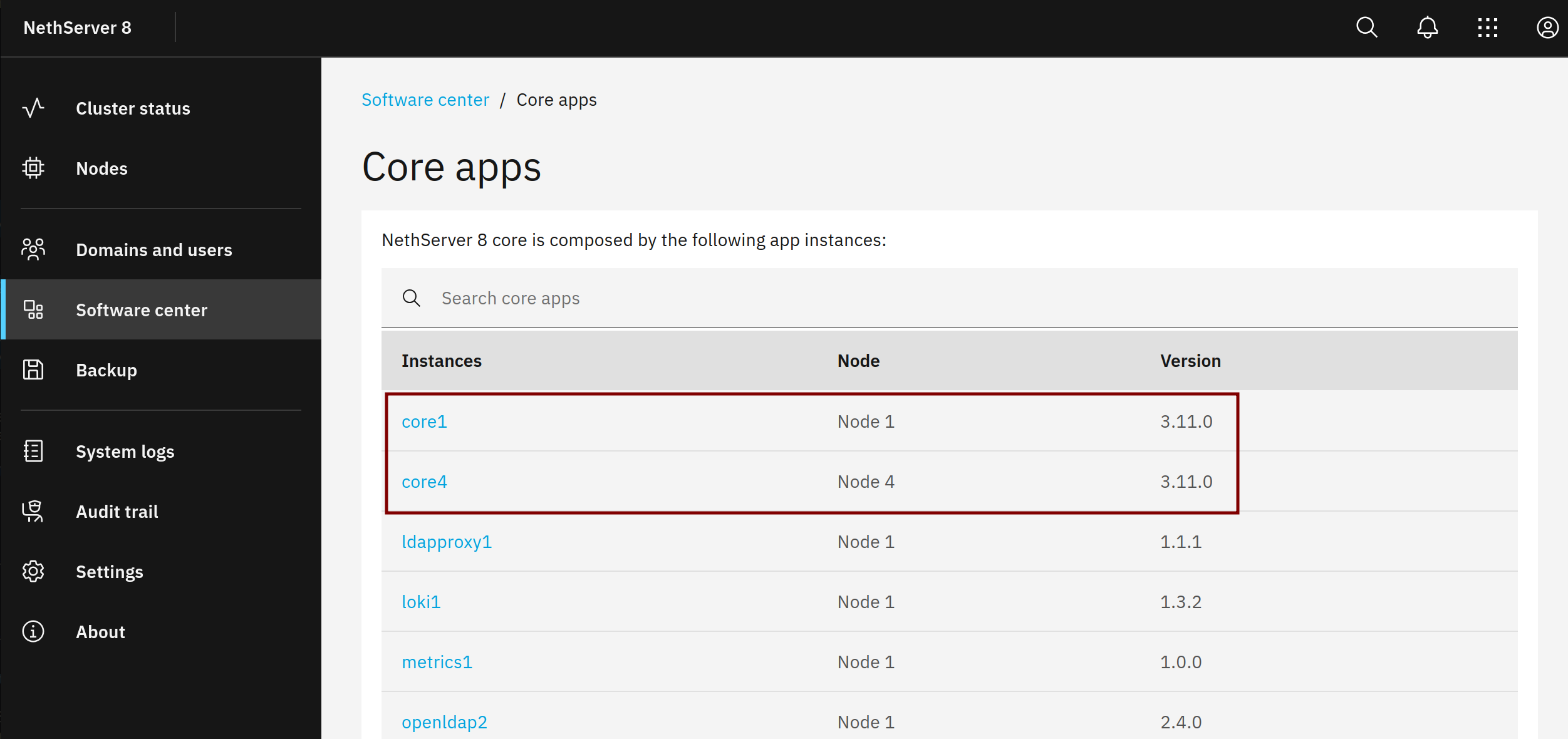

You could check it in the core apps:
The Github milestones like 8.6 are not yet reflected in the code.

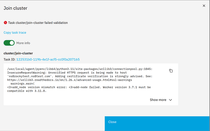

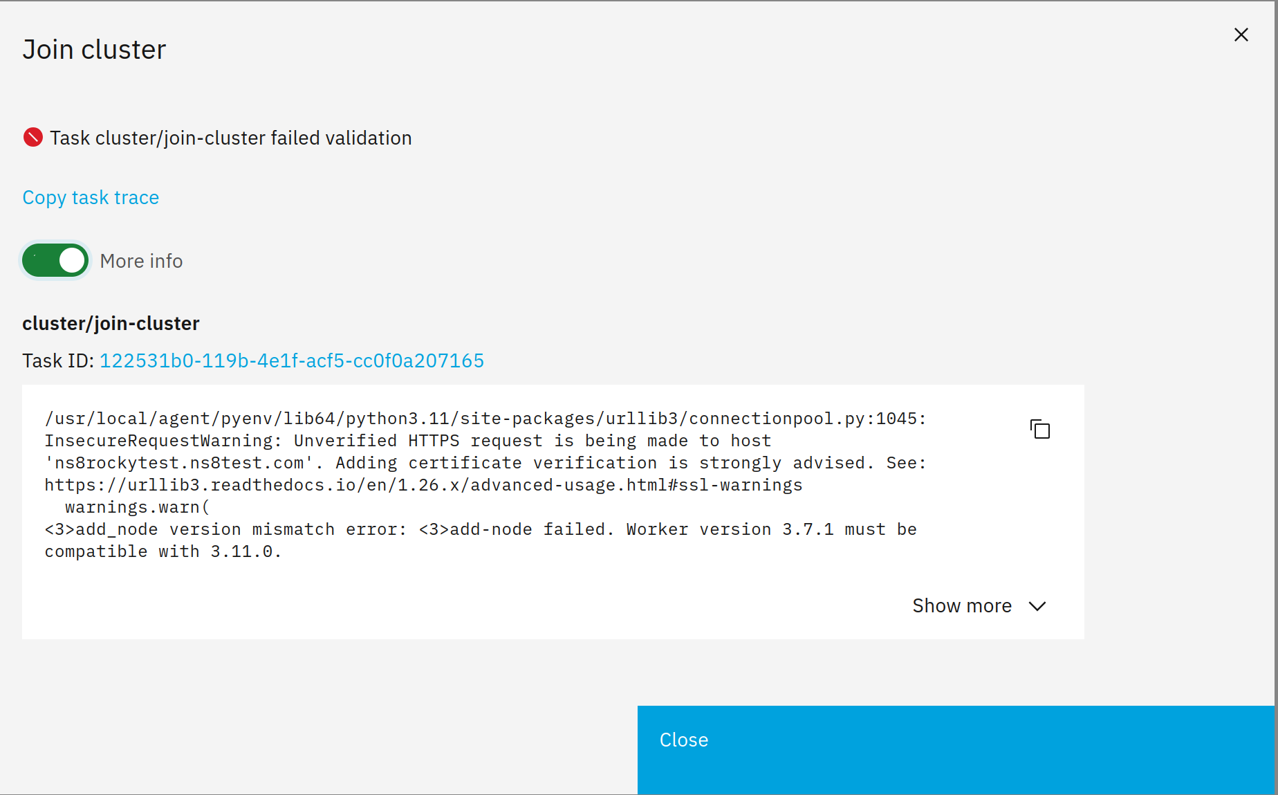

If you want to join a node with lower version to a cluster you get this:
And if you update the core of a cluster via Software Center, usually all nodes are updated. If a node isn’t reachable there’s an error and the update is cancelled.
