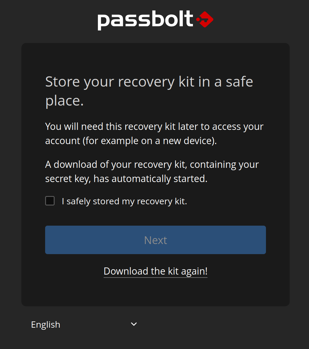

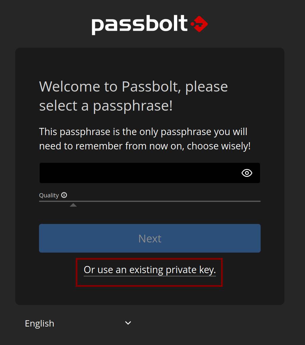

To use the key from the recovery kit:

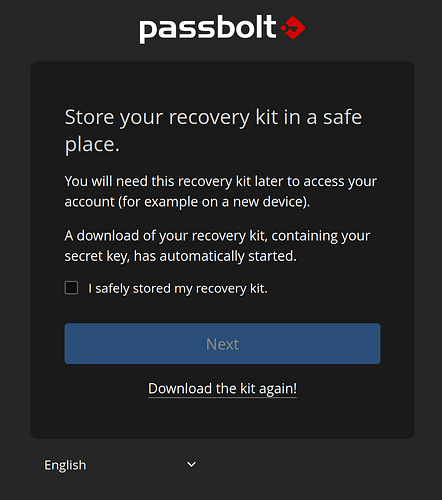

The recovery kit download is shown during setup after entering the passphrase:

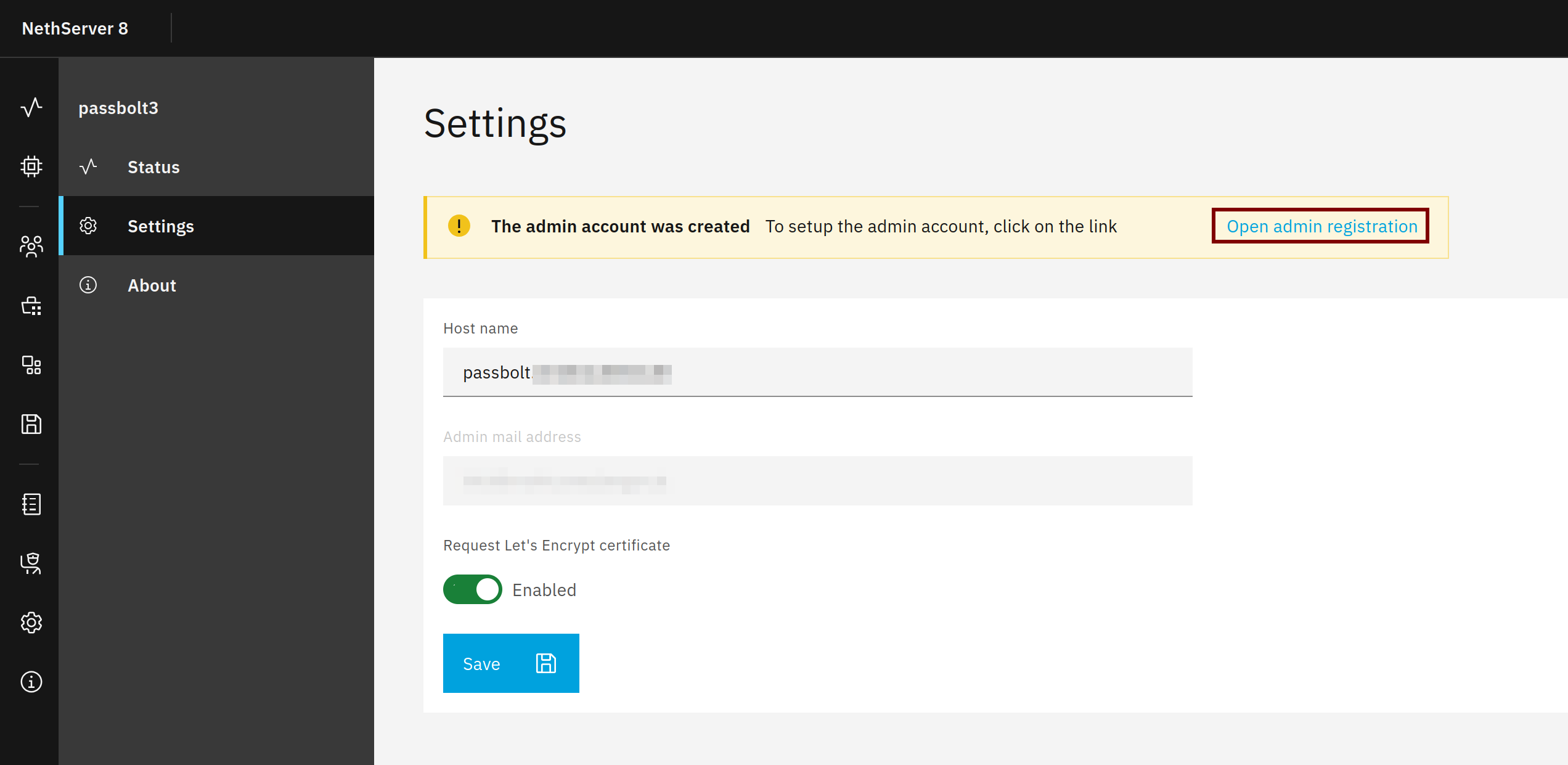

I do not get an initial setup. After configuring and starting the app I am asked to enter my email address and to check my emails. But I never get a mail. What is wrong here?
From the documentation:
After first configuration, the Admin registration link is shown. Please follow the link to create the Admin account, set a password and save the Passbolt keys.
Thanks a lot, Markus. I always oversaw this button. Now I got it. Passbolt works.
