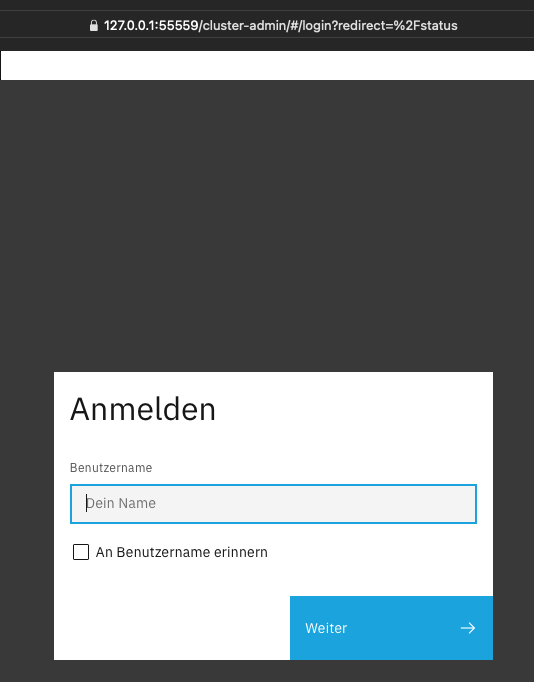

This works with numerous web GUIs, but unfortunately, it doesn’t work with Nethserver 8. I can get to the login window (i.e., the tunnel is basically up) and can log in there, but after that, it always says “Websocket disconnected.”

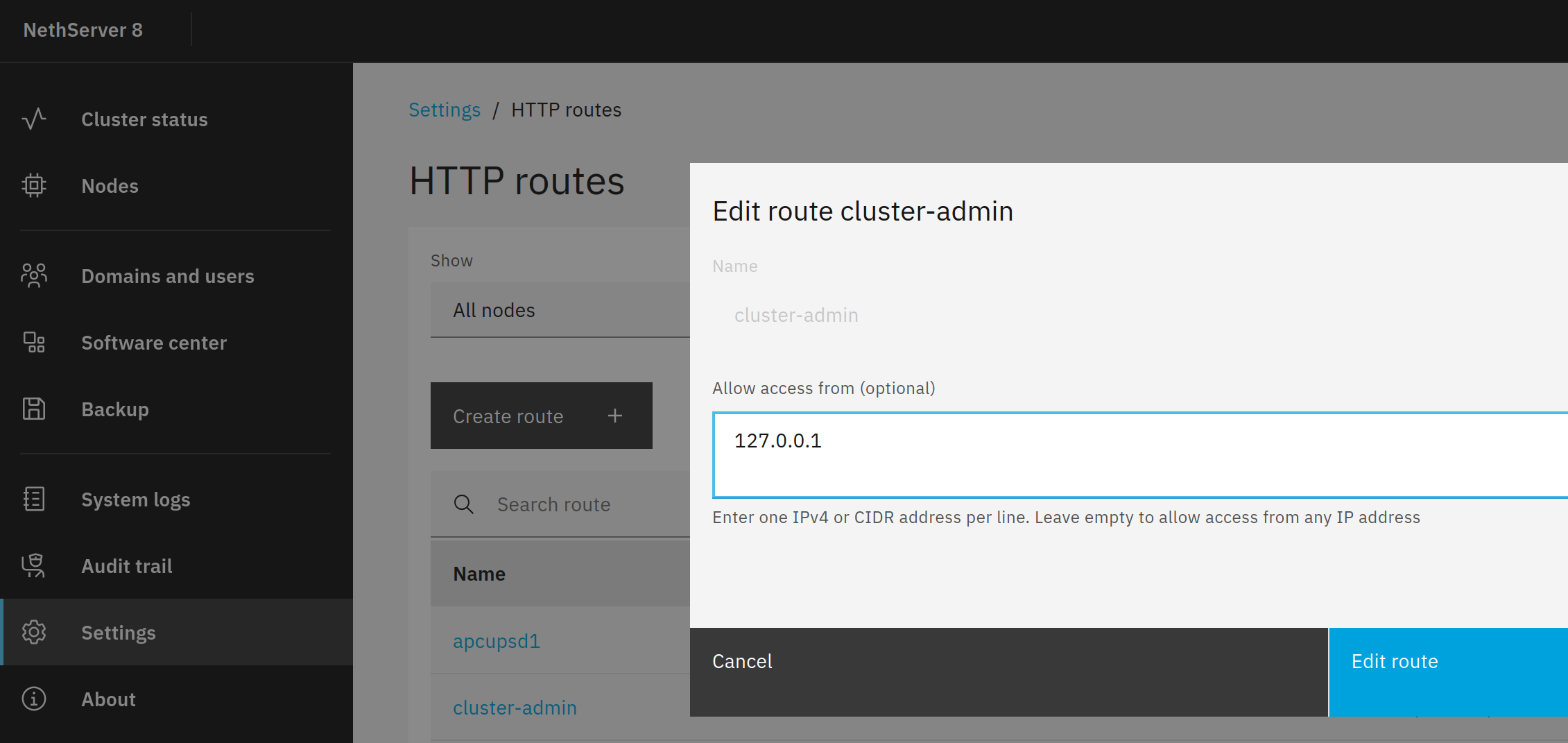

You can disable public access with the Allow access from option of Traefik Proxy — NS8 documentation.

Since the Lgin page opens, it’s probably not the command that’s causing it.
The note regarding name-based forwarding is of course correct, but the Nethserver 8 GUI does not use it.

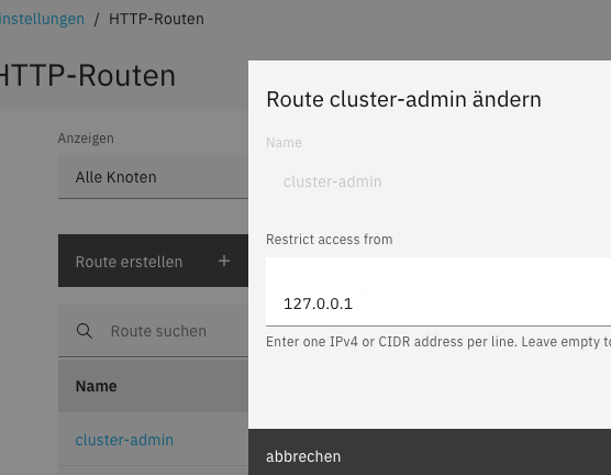

As explained in Support team locked out of cluster-admin HTTP route · Issue #7436 · NethServer/dev · GitHub it should help to add the loopback device in the http route allow list.
Please also add another IP to access cluster-admin to not lock yourself out…

Thank you for your detailed description. But even a 127.0.01 entry in the “cluster-admin” http route doesn’t change anything.
