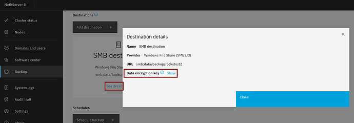

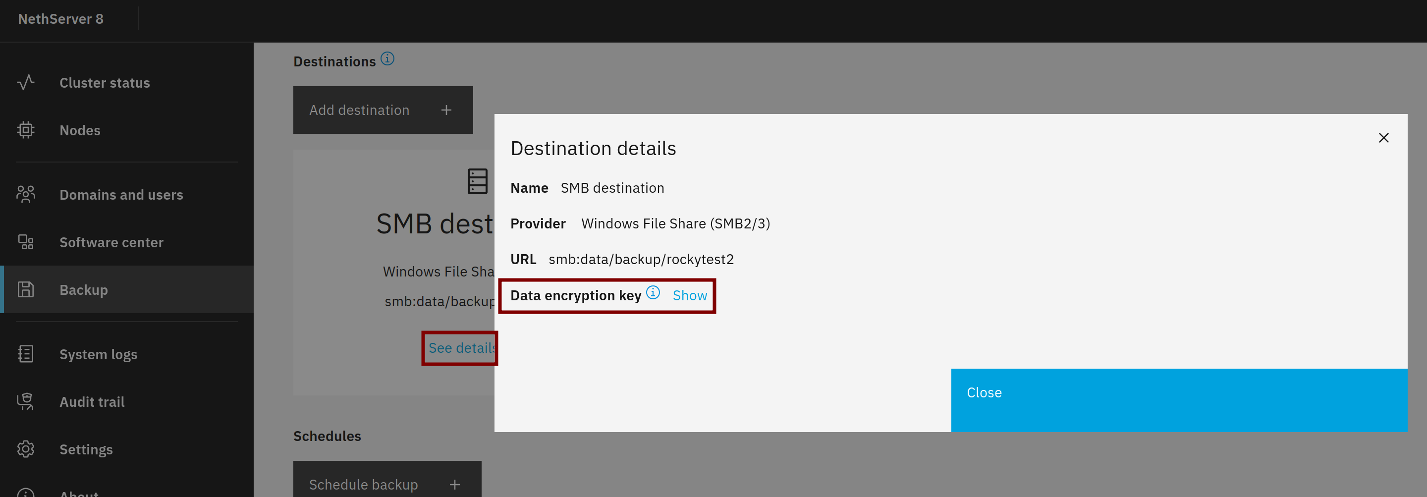

Did you also delete the backup destination?

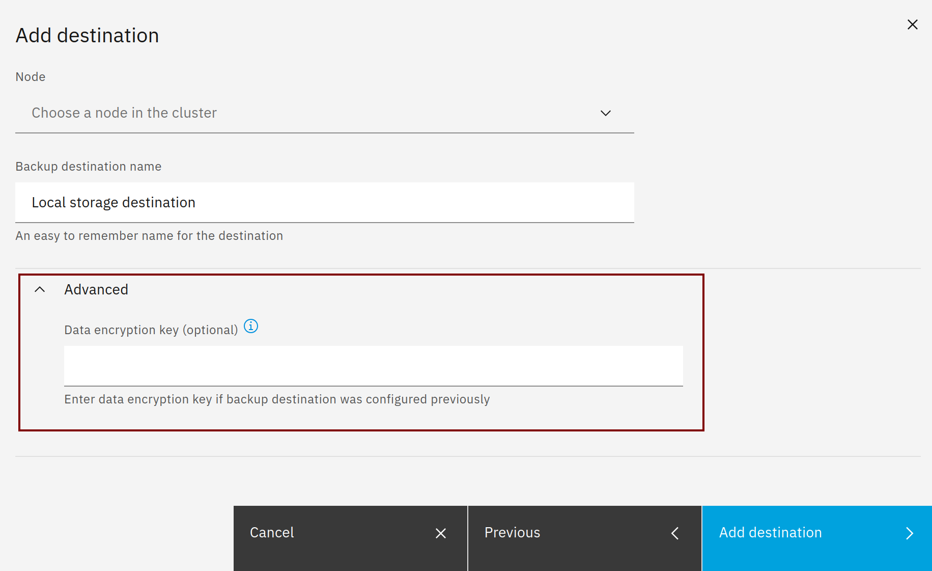

To recreate a destination where you already have backups, you need to get the data encryption key…
…and enter it in the new destination to be able to read the already stored files.
If you deleted the destination and the encryption key isn’t there anymore, you’ll need to remove the backup files and start over using a new destination.

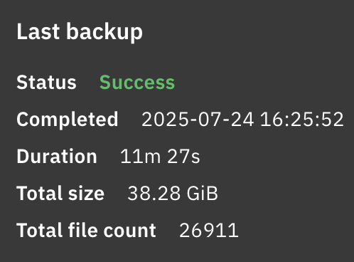

Exactly what I did, backup is now running, so let’s see if it finishes without error for it is many Gb.
Update: success
