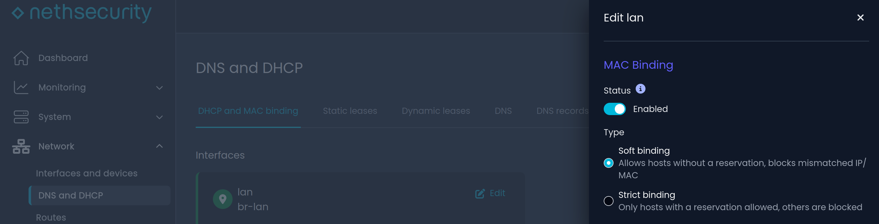

I’d go with the MAC binding, see DNS & DHCP — NethSecurity documentation
When a student has a new laptop he needs to tell you and you can change his DHCP reservation to the new MAC.

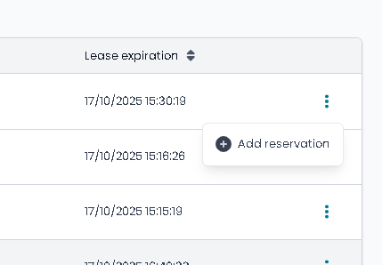

Basically, I’m looking for an option that my ISP’s router had that allowed me to block the MAC address of a specific device so that it wouldn’t be assigned an IP address.
It would be great if in Dynamic Leases, when you click on the three dots, in addition to “Add reservation”, something like “Block MAC in DHCP” would appear.
