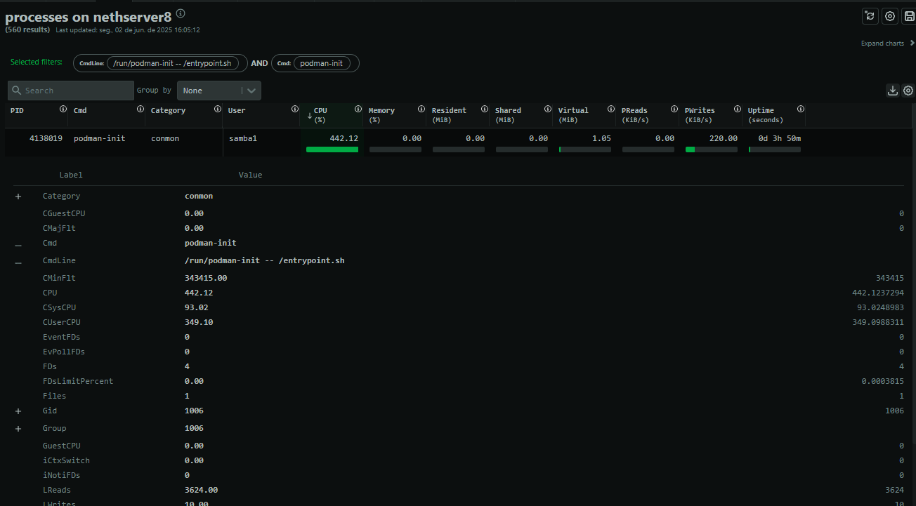

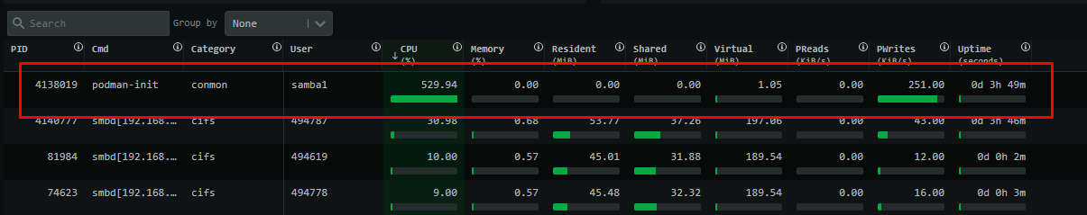

I’ve been facing a high processing issue where my server’s CPU usage hits 100%. Using the NetData tool, I was able to identify which service is causing the high processing.
This problem occurs a few times a day and lasts for about 5 to 10 minutes. Sometimes it takes longer and only normalizes when I restart the Samba service.

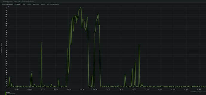

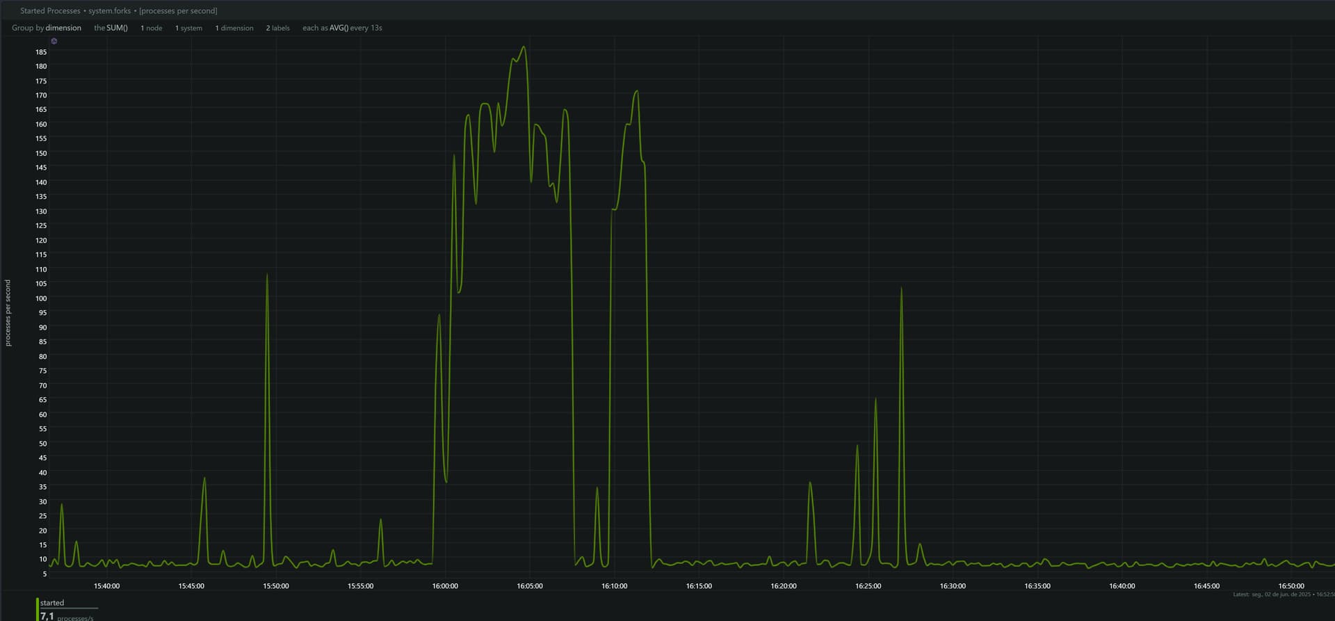

podman-init. Please, in Netdata, check if the high CPU usage correlates with high process fork rate.
Sorry davidep, but how can I check this? I have no knowledge in netdata.
I discovered this information by chance, as I was trying to look for something that would help me find this process that was consuming CPU.
Look at the Netdata graph “Started Processes - system.forks - [processes per second]”. I’m asking if this graph correlates with the high CPU load.

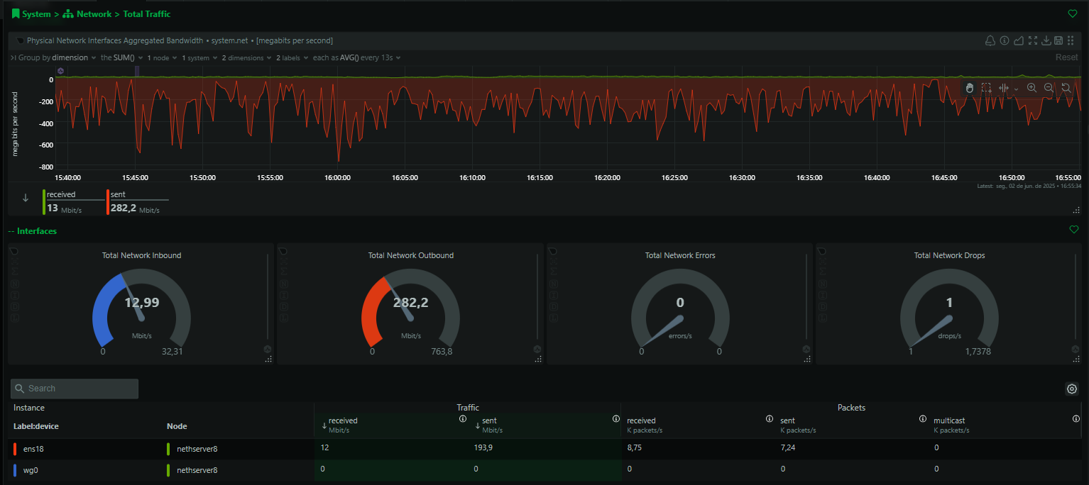

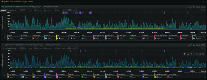

Other interesting correlations can be:

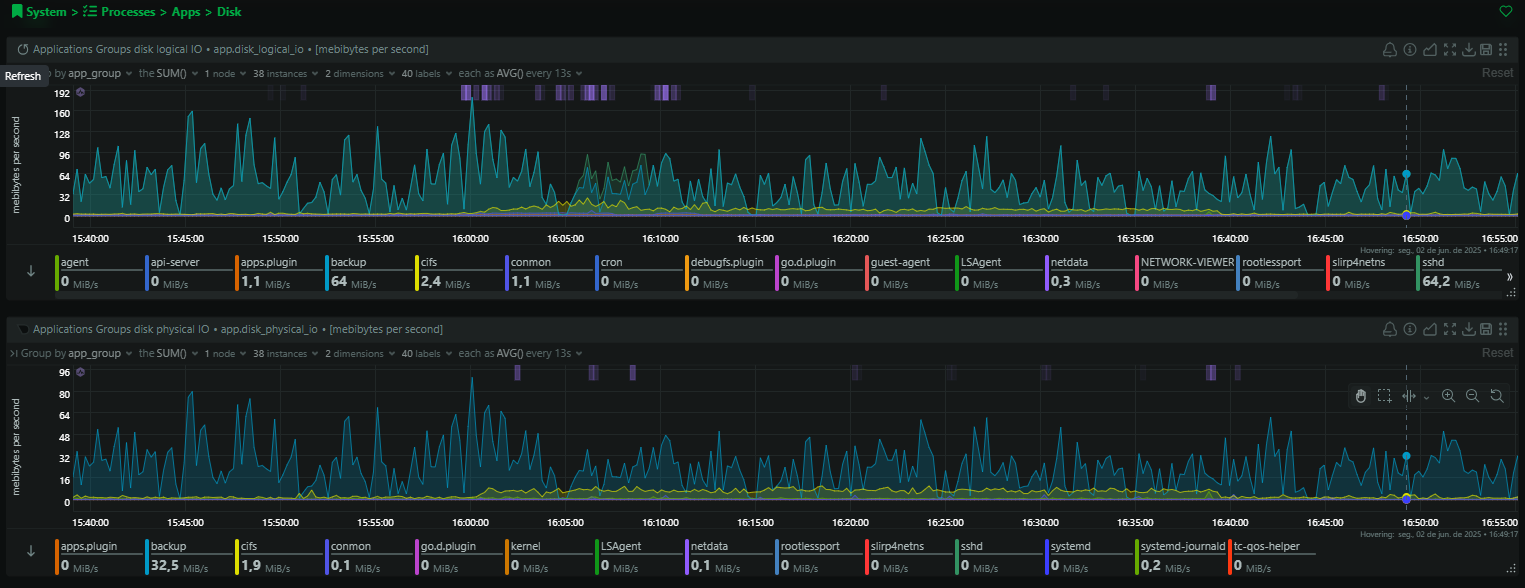

  • Disk IOPS
  • Network traffic
Does the outage occur at random times, or during working hours? How many clients are using Samba at the same time? Is Samba acting as unique DNS for them, or do they use another DNS server?

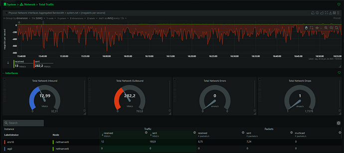

The images shared are from the same day I posted here on the forum
