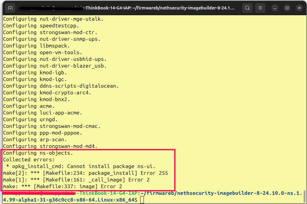

What about openwrt Make menuconfig i want add some features please tell me how
I think you can edit the packages here but I didn’t test.
actually i’m try to costume ns-ui file upload the give me error i’m also create a ns-ui_1.22.0-r1_all.ipk can you please tell me why this error show and how can i fix this
