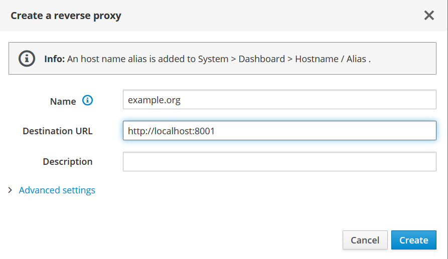

Join the “particify_arsnova-proxy_1” container to the aqua network (see this thread for screenshots) and use a named reverse proxy to http://localhost:8001.

Did you setup a reverse proxy? HTTPS on port 8002 is unused, I needed to set it to not conflict with local apache.

I meant a reverse proxy to localhost on the VM itself, this way there’s no need to open another port.
IIRC the arsnova containers use their own network so you need to add the arsnova-proxy container to a network localhost can connect to without adding firewall rules.
