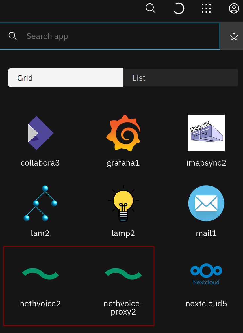

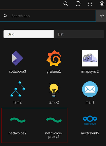

You can find the apps in the app drawer on the top right, first go to NethVoice Proxy to configure it:

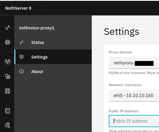

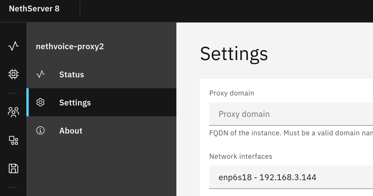

Then go to settings and configure NethVoice Proxy.

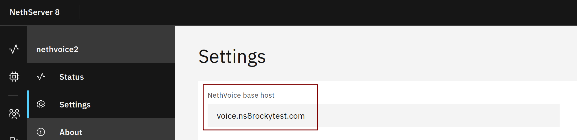

Then go to NethVoice and configure it.
Browse to the NethVoice base host and login with the credentials you set.

Do I have to have actual A Record entries pointing to my public IP and punch my firewall? I cannot test it solely within my LAN?
It should also be possible to test it in LAN. Just put the local IP of eth0 in the “Public IP address” field.
You need to setup a DNS entry on your firewall so that the nethvoice base host points to the NS8 IP.

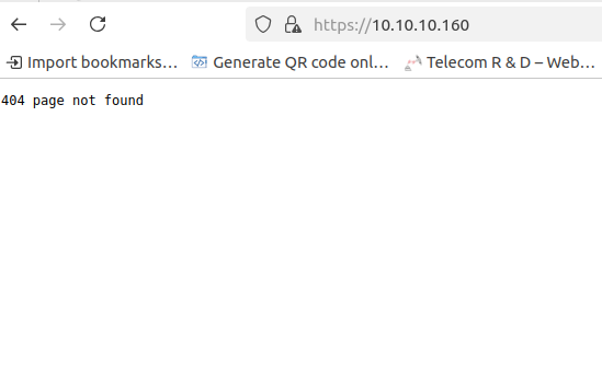

DNS entry for nethvoice base set on router and I get a 404
You need to use the name, not the IP.
In NS8 a reverse proxy (traefik) is used and therefore you need to use names to get to the right app.

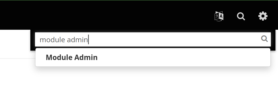

Are there any plans to incorporate support for texting/SMS? For FreePBX, I normally would install the open source SMS connector. But it looks like Access to FreePBX’s module Admin (Admin>Module Admin) is restricted on the instance of Nethvoice.

This can be done via FreePBX AFAIK, see also Some questions about NethVoice app - #9 by LayLow
I found that you can reach the module admin using the search function but I guess you can break things when installing unsupported modules.
cc @Amygos @Stll0
For custom FreePBX modules, you cannot use module admin because freepbx is containerized and new files would be deleted on container restart. But it’s possible to add custom modules by placing module .tar.gz in a folder ns8-nethvoice/freepbx/README.md at main · nethesis/ns8-nethvoice · GitHub
