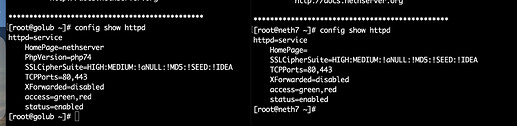

Another difference , although the servers are very similar and use for glpi php 81 … I noticed this :
From the left the test server works only from the lan with the domain name of glpi, on the right the server that really doesn’t want to know …
I attach these images even if they probably have nothing to do with the problem …
phpVersion comes from my old module phpScl I suppose
