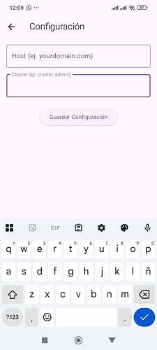

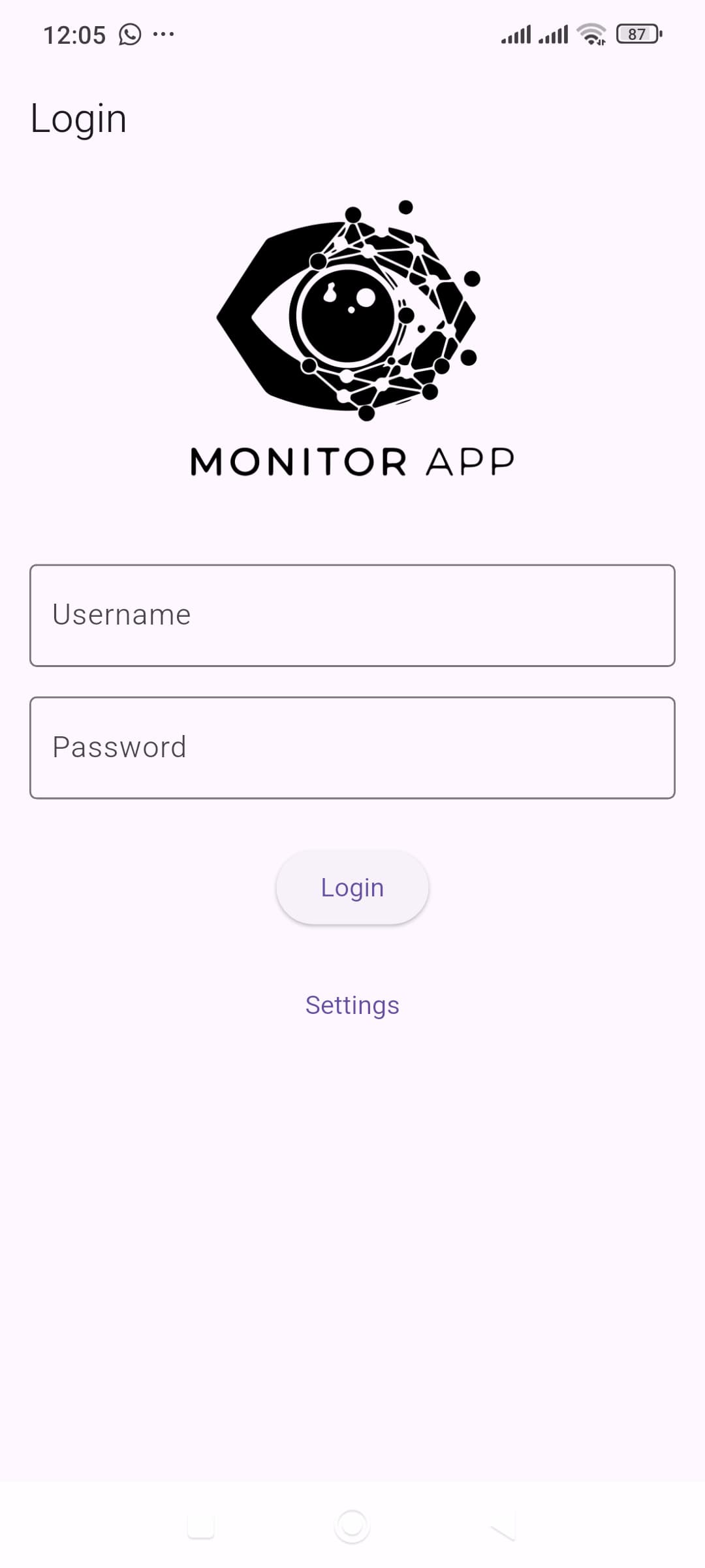

An Invitation to Test the NethServer 8 Client APK (Alpha)
Hey NethServer Community,
I’m excited to announce that I’ve been working on an Android APK client for NethServer 8, and I’m ready to invite you to try out its alpha phase!
This early version is still under development, but it’s fully operational for some core functionalities:
  • Login
  • Add Servers to Connect
  • Logout
If you manage multiple NethServer 8 instances, I’d really appreciate it if you could register them within the app and verify that they connect without any issues.
Your feedback is incredibly valuable as I continue to develop this client. Please let me know what you think, any bugs you find, or features you’d love to see.
Thanks for your support!
https://mega.nz/file/E8IAnIQR#jOJkNd8QFr4OenSEEKx6kJmzAwPBGYkOv494s95kJGE
I have added a node, check if you have more than one node and if it shows the corresponding information, update to English, it needs to be implemented in the user module and enable modifying user data

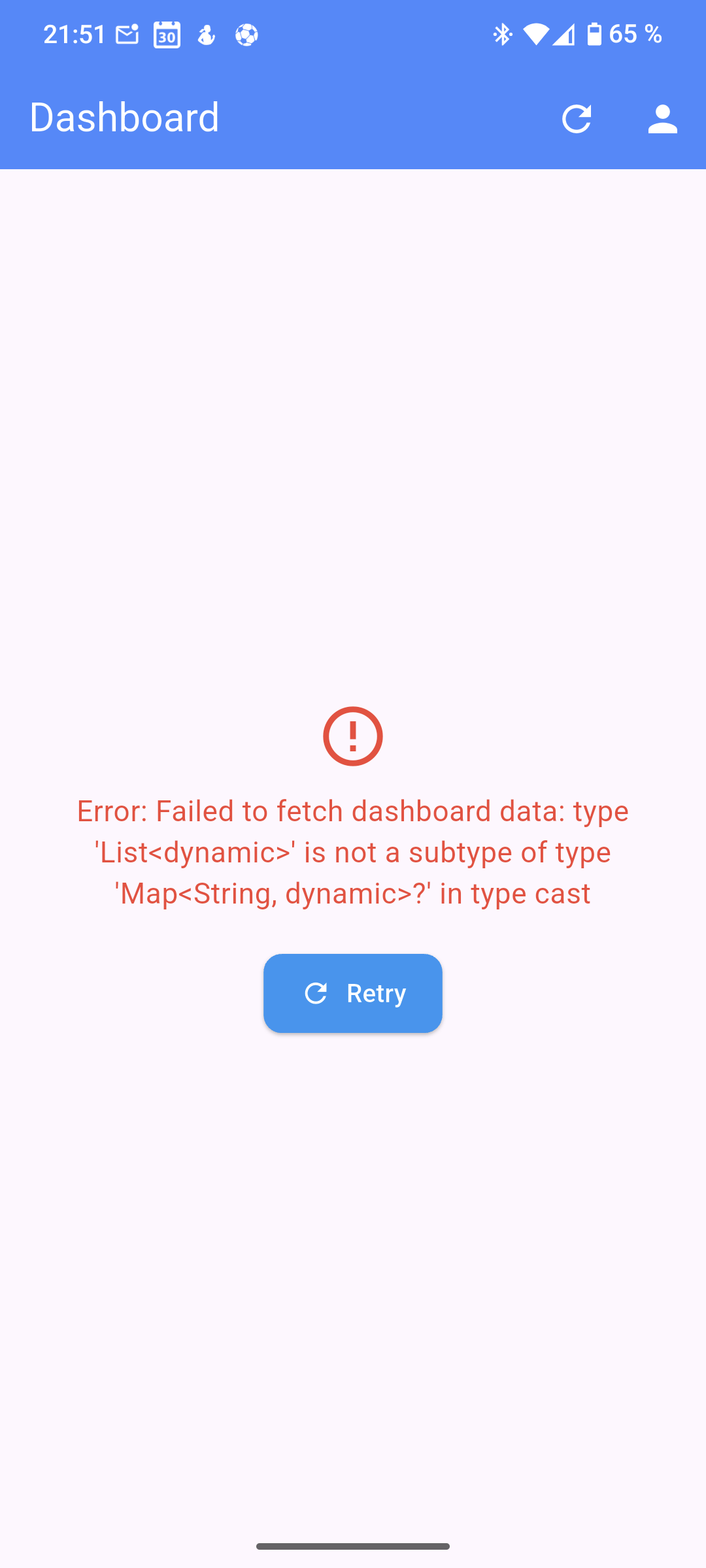

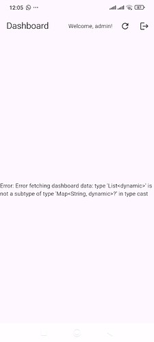

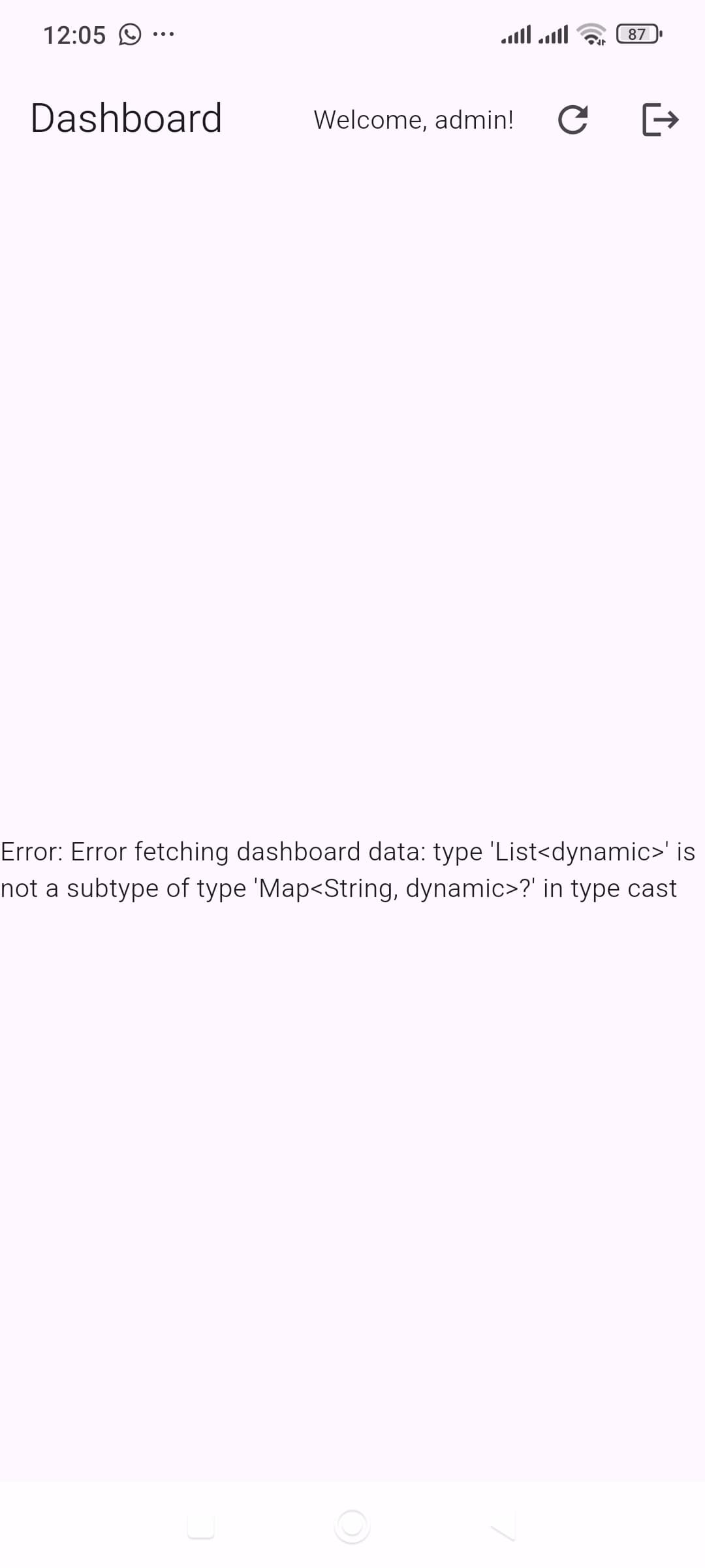

Login, adding servers and logout worked. :+1:
The dashboard shows an error:
Yes, I wanted to show the statuses from the dashboard, but I’ll do it from the menu. I’m working on it. Just like the user panel, I’ll add a change password and log out immediately to get a new token.

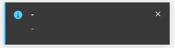

@giacomo I am creating the module to create a repository, but I have realized that when I run a process from the API on the server it shows me like this
Captura de pantalla 2025-06-16 111207
but from the server it shows me like this
Am I missing some command to display it correctly?
“action”: “add-repository”,
“data”:{“name”:“nethforge”,“status”:false,“url”:“https://forge.nethserver.org/ns8/updates/”}

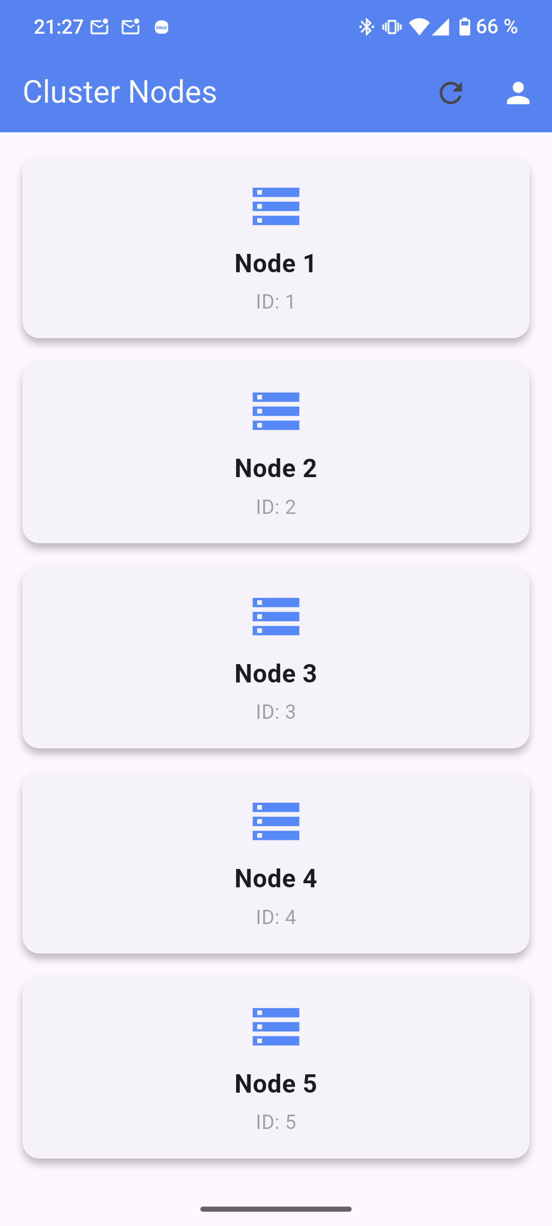

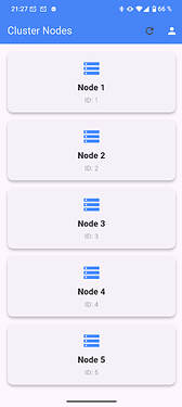

I tested to connect to 2 Nethservers but this time the dashboard shows nothing, just a blank screen.
I tried removing/reinstalling the app but it didn’t help.
By clicking on the nodes menu you will get the nodes, nothing will appear on the dashboard for now
Thanks, now I got it, I didn’t find the menu :sweat_smile:

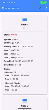

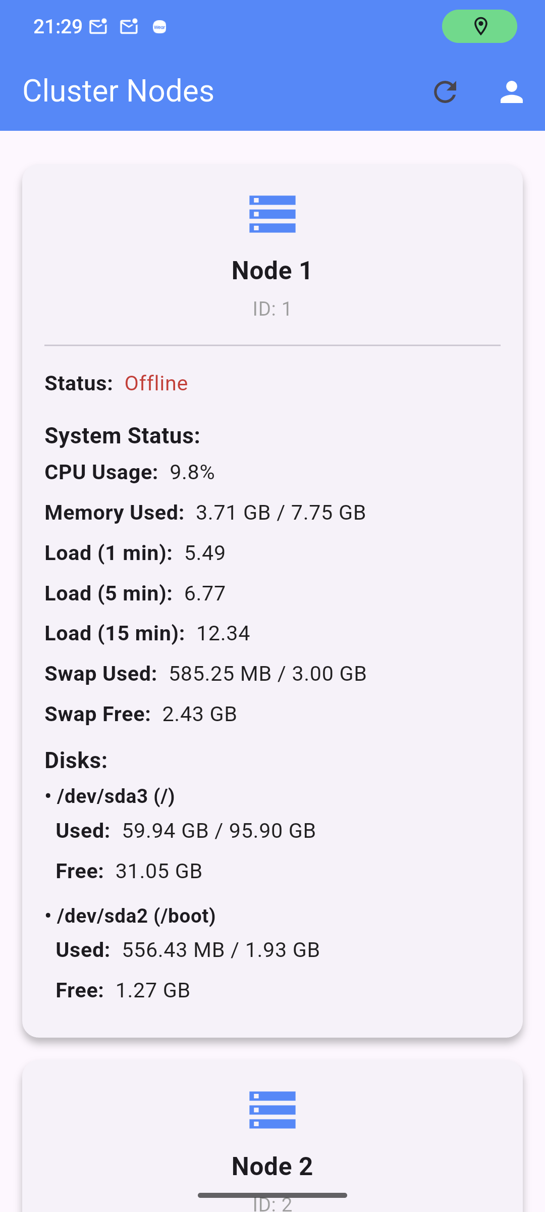

The nodes are shown:
The values are correct except of the status…
If I missed also adjust that value, thanks for sharing, I forgot to say that moving from left to right will make the menu appear, sorry.

You can passa a flag to the API.
IIRC it should be: "isNotificationHidden": True
